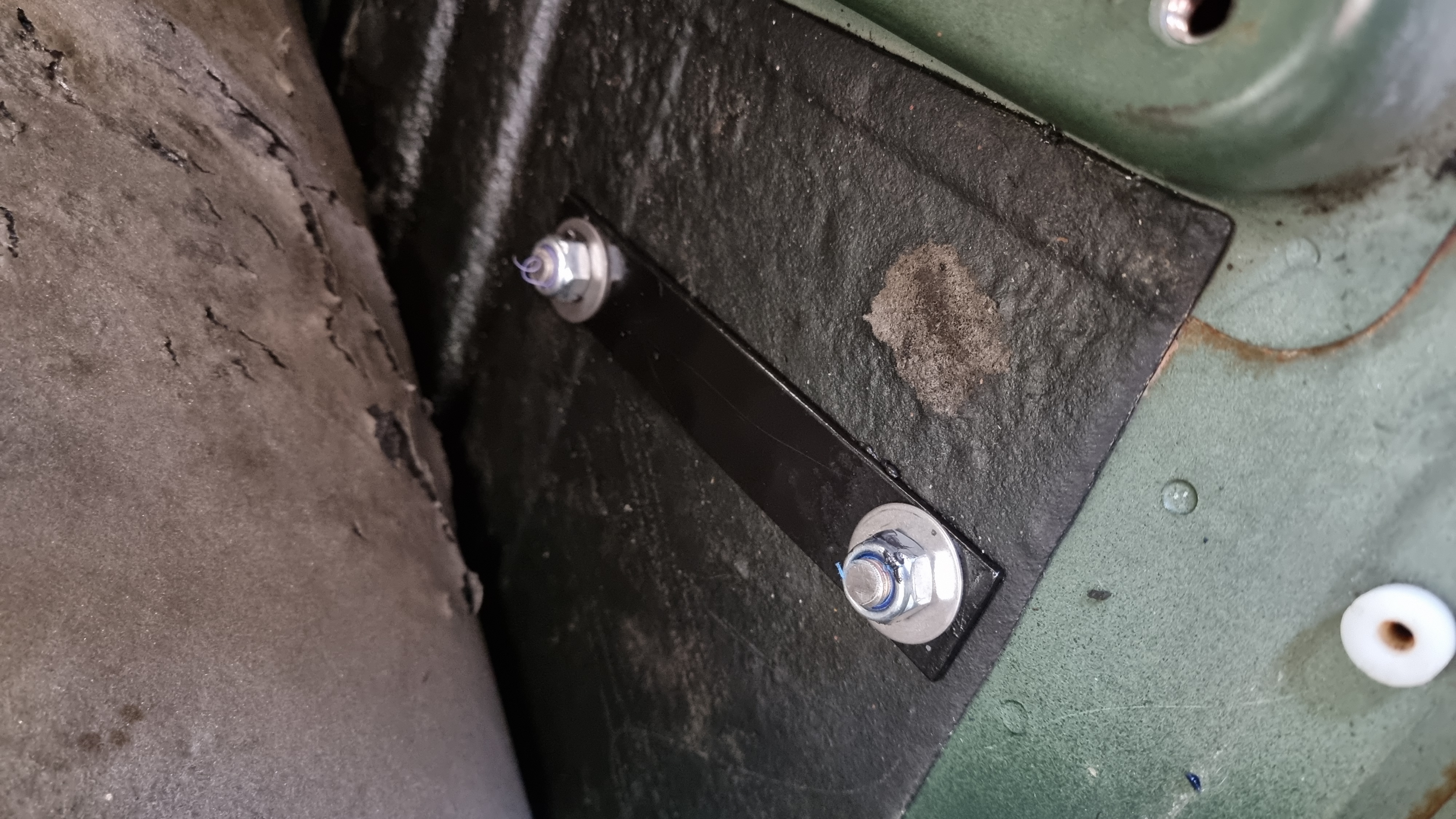

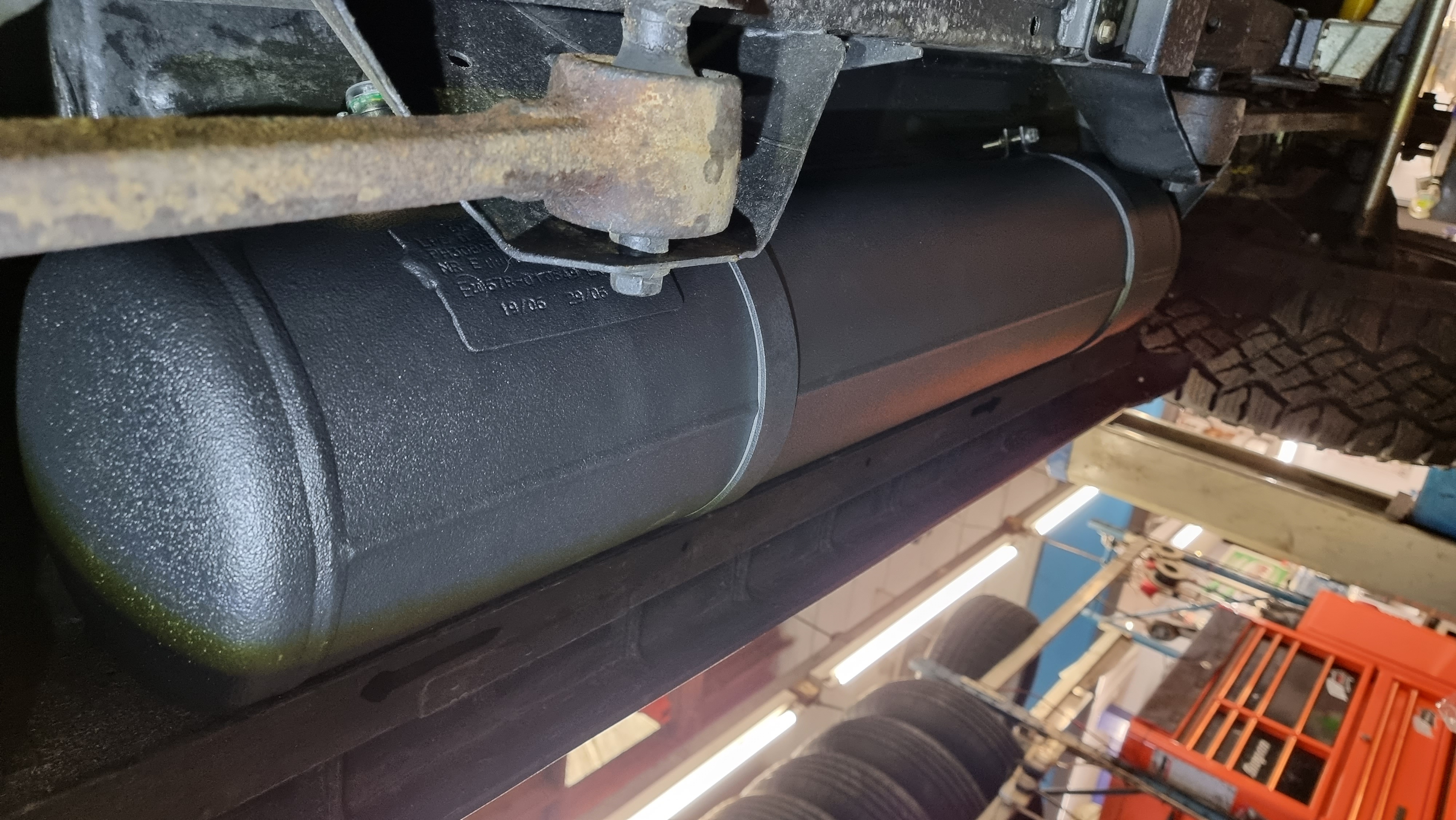

Thought I'd post a few photos of my install for anyone interested.
2003 Land Rover Discovery 4.0l V8 Auto, Valtek 34 injectors, Emer Palladio reducer.

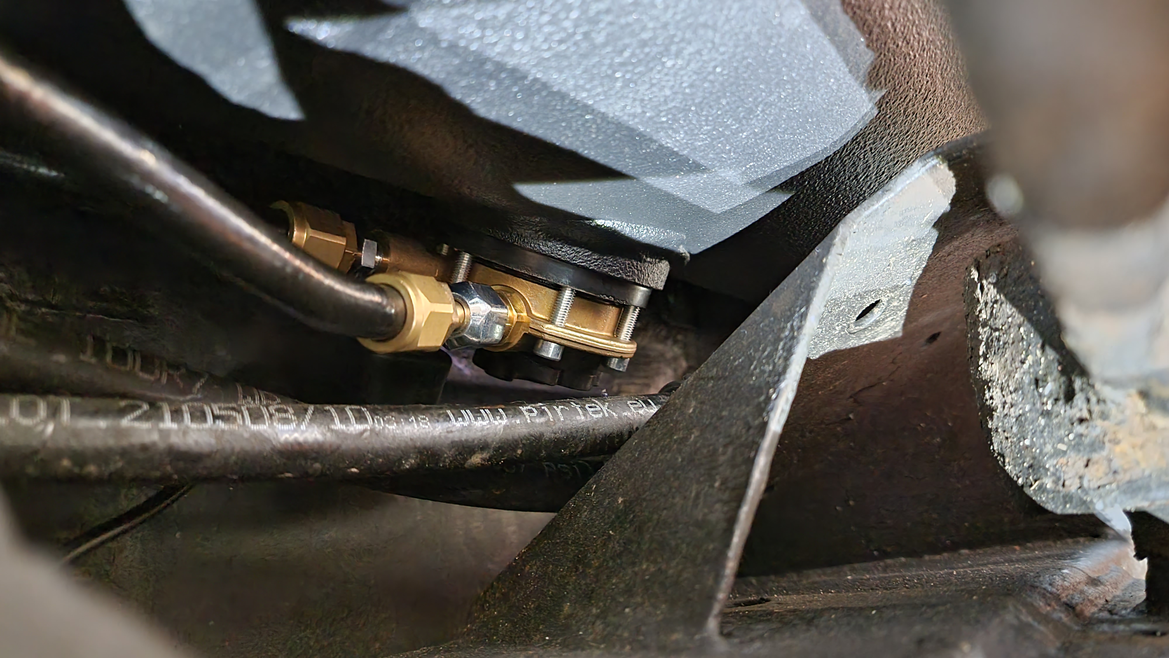

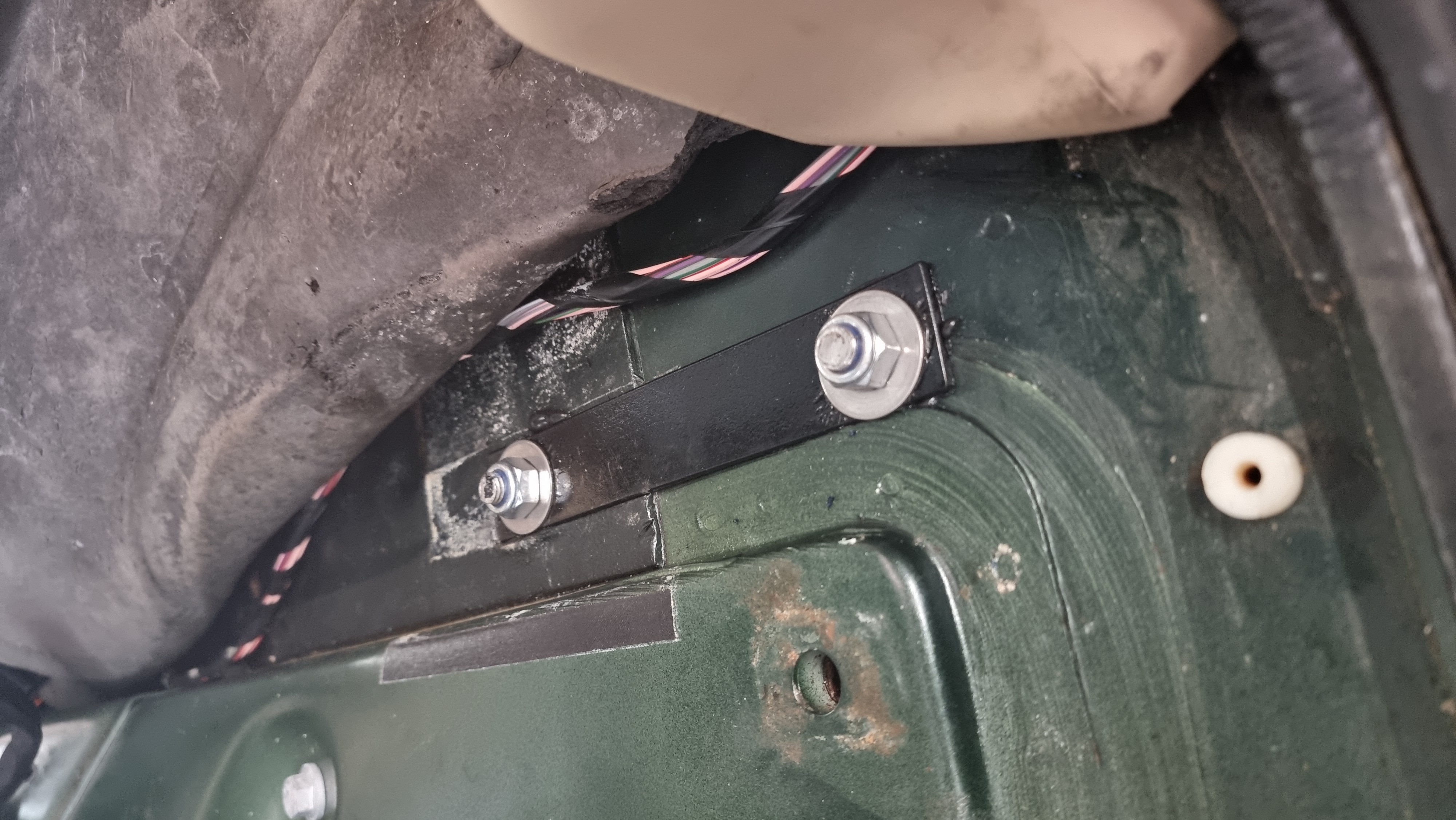

A few more.

Great photos, thanks. This looks much better than dual tanks in the middle with a reduced capacity fuel tank.
I'm looking for a d2 myself and am likely to need to renew or install tanks.
K

No worries, glad to help. There very tight in there but it's the perfect spot. Any questions don't hesitate to ask.
