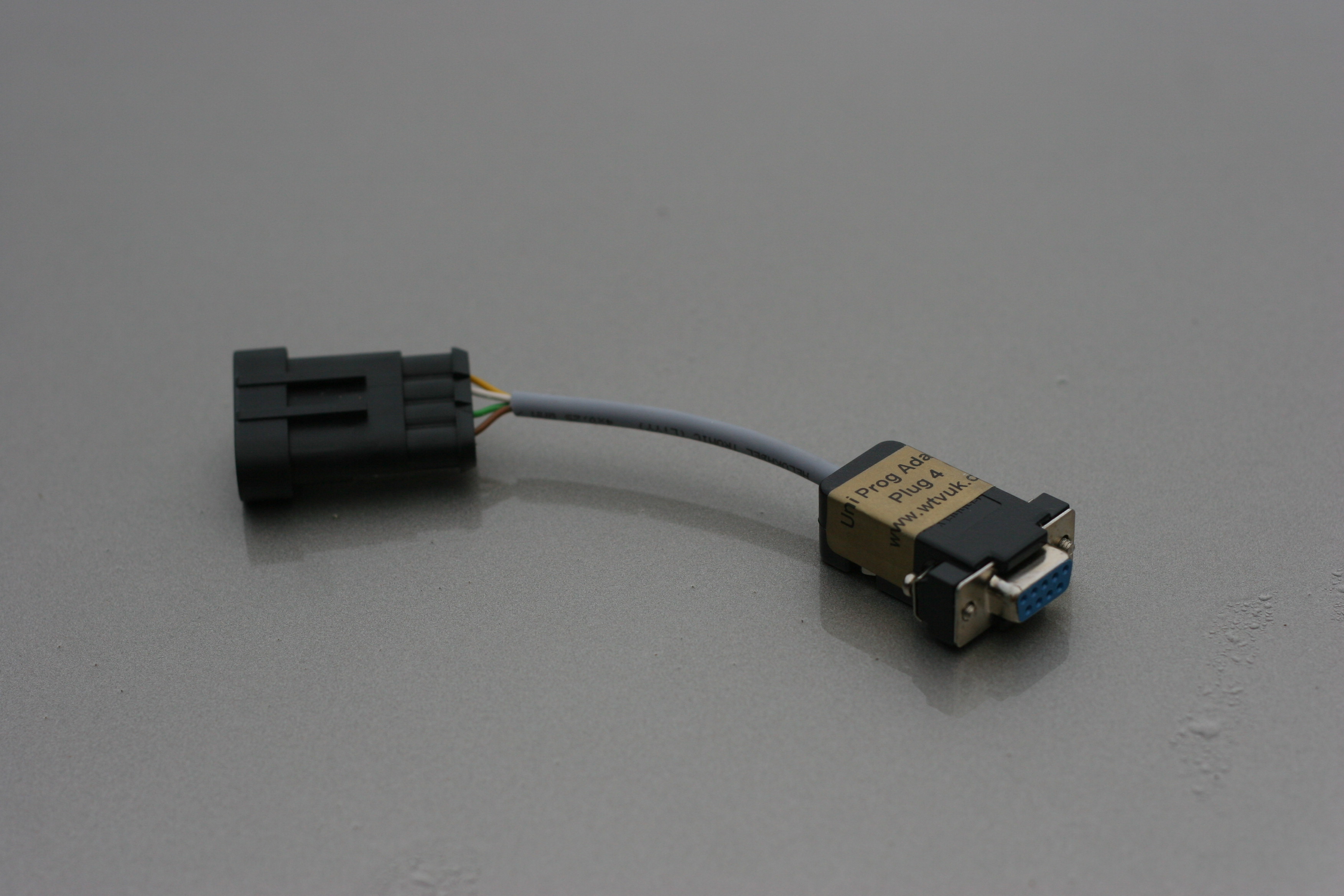

Next is to ascertain if the connector lead with the Supaseal on one end and the 9 hole (5&4) old computer style connector is AEB 170 compatible.
After talking to WTV-UK the lead I referred to is AEB 170 Gal compatible - see photo below.
It was supplied with my diagnostic/programming lead ordered for AEB 175 and was unused until now as the Molex one was the one used for AEB 175. Maybe, when you guys bought your lead you were supplied with one also.

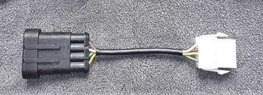

I can see now why the lead I posted a photo of with the 8 way Molex is what you need to base your lead on. If, you aren't absolutely sure of the orientation of that plug re which row the wires are in, can you not wire both rows (pairing the wires of the same colour) and it will work either way up?
Re: stepper and ECU for single pt system
#70 Post by Gilbertd »
The Molex plugs and sockets are keyed so it will only go in one way so I can only wire the 4 holes that are being used. I can see that the Supaseal plug goes Brown, White, Green, Yellow and the Molex would go White, Brown, Yellow, Green if the wires are in the top row but if they are the bottom row it would go Green, Yellow, Brown, White. The wire colours on my cable are different (different manufacturer) so they are no help.
It would appear that the plug used on the 175 diagnostic is one of these https://www.molex.com/molex/products/pa ... 0039013089 with the pins in the top row. So if the pic you have posted of the incompatible systems interface cable (bodge cable) is showing the top row in use, the Green will be top left pin. However, if it is the bottom row in use, the White one will be top left.

Gilbertd wrote: Fri Jan 27, 2023 3:44 pm The Molex plugs and sockets are keyed so it will only go in one way so I can only wire the 4 holes that are being used. I can see that the Supaseal plug goes Brown, White, Green, Yellow and the Molex would go White, Brown, Yellow, Green if the wires are in the top row but if they are the bottom row it would go Green, Yellow, Brown, White. The wire colours on my cable are different (different manufacturer) so they are no help.
What you've described is the wire positions being diagonally opposite and what I'm suggesting is wire all 8 as such (pairing them before the Superseal).
The alternative is assume which row is the active one (50:50 chance if a pure guess) and wire it accordingly being prepared to re-do it if it's the other row. Wiring all 8 as I suggest covers both eventualities - albeit with the additional complication of having to splice pairs together. Either method will work.
I can probably still work out the wiring you need. If I open up both of my leads at the serial(?) connector I can note the positions of the wires within and correlate their positions in the Superseal with respect to their position in the Molex. Yes?

The photo I posted of the WTV box shows the pinout? Between that and the photo from Pinger of the adaptor that should give the needed info?
FYI not sure sure if you realise Pinger, but you can't use those WTV adaptor cables just into a serial port, you need that black box or the usb lead to go with it, depending which version you have got of their cable. I brought one of the 10 in 1 sets ages ago when the whole lot was around £50. I've also got another AEB lead of some description that I think was what I used when I wanted to check the ECU I'd got was working etc, so I've definitely got a lead that works here somewhere. My main vehicles now both use KME hardware so its a different lead for those.

Brian_H wrote: Fri Jan 27, 2023 11:06 pm The photo I posted of the WTV box shows the pinout?
Maybe it's just me, but I couldn't make sense of it. It shows wires with colours: Black; Red; Green; Yellow. The Molex I have has colours: Green; Yellow; Brown; White.
Brian_H wrote: Fri Jan 27, 2023 11:06 pmBetween that and the photo from Pinger of the adaptor that should give the needed info?
It's still a guessing game as to which way up that Molex is. It's not entirely clear in the photo.
Brian_H wrote: Fri Jan 27, 2023 11:06 pm FYI not sure sure if you realise Pinger, but you can't use those WTV adaptor cables just into a serial port, you need that black box or the usb lead to go with it, depending which version you have got of their cable. I brought one of the 10 in 1 sets ages ago when the whole lot was around £50. I've also got another AEB lead of some description that I think was what I used when I wanted to check the ECU I'd got was working etc, so I've definitely got a lead that works here somewhere. My main vehicles now both use KME hardware so its a different lead for those.
My terminology may be off here. The connector I refer to as 'serial' is the trapezoidal shaped connector with 9 connections (one row of 5, other row of 4) that on mine I connect either the short lead with the Molex or, the other one with the Superseal. What they connect to is the 'black box'.The other end of the cable is USB - though I understand that Gilbertd's is serial where it connects to lap top. See photo below for my cable and adaptor leads.

#75 Post by Brian_H »
Your terminology is fine - WTV really shouldn't have used the connector they have as it is the same connector as the standard serial one on a pc (DB9 if you want to be specific) but the signals and voltages carried on it are not standard serial (RS232) standard.
If you look at the Landi Renzo pinout, that is AEB superseal. Ignore the colours shown on the box but look at the K/L/+/- shown, that will tell you what the convertor needs to connect from on each side (just make sure you have the connector flipped around the right way when your looking at the diagram!) The other one should be the Bingo/Leo/Milenium labelled one?
Pinout should be the view from looking into the connector so you can see the pins rather than the wires. The thick bit of line near the plus on the molex connector would be the bit with the latch. The superseal you should be able to figure out from the two locating lugs shown in the image, I think you've got the clip facing the bottom side in that case? (I don't have mine to hand right now to check it else I'd look for you)

Brian_H wrote: Sat Jan 28, 2023 11:49 am If you look at the Landi Renzo pinout, that is AEB superseal. Ignore the colours shown on the box but look at the K/L/+/- shown, that will tell you what the convertor needs to connect from on each side (just make sure you have the connector flipped around the right way when your looking at the diagram!) The other one should be the Bingo/Leo/Milenium labelled one?
My 'Plug 4' which WTV-UK assure me is the correct lead for AEB 170 doesn't correspond to that. The K and L are fine but the +ve and -ve are reversed. See photo below. Plugs are orientated as per the diagram ie, live row in Molex is to the bottom as is the tang on the Superseal connector. Unless the wires are connected to different pins in the 'serial' connector then two of the wires correspond to the diagram and two don't. Totally confused now!

#78 Post by Brian_H »
Only answer I can see to that is that they haven't consistantly used the same colour wires? Multimeter buzz out would tell you that. Long as it works doesn't matter for you as you have both options there anyway?
Plug 4 defintiely works for Landi Renzo Omegas - As thats the lead I've got, that is standard AEB (well the ecu is at least, the rest of the Landi setup is anything but standard) and fairly sure I used that same plug 4 for the the AEB 170 when I bench tested it as well so I'd agree its the right adaptor.

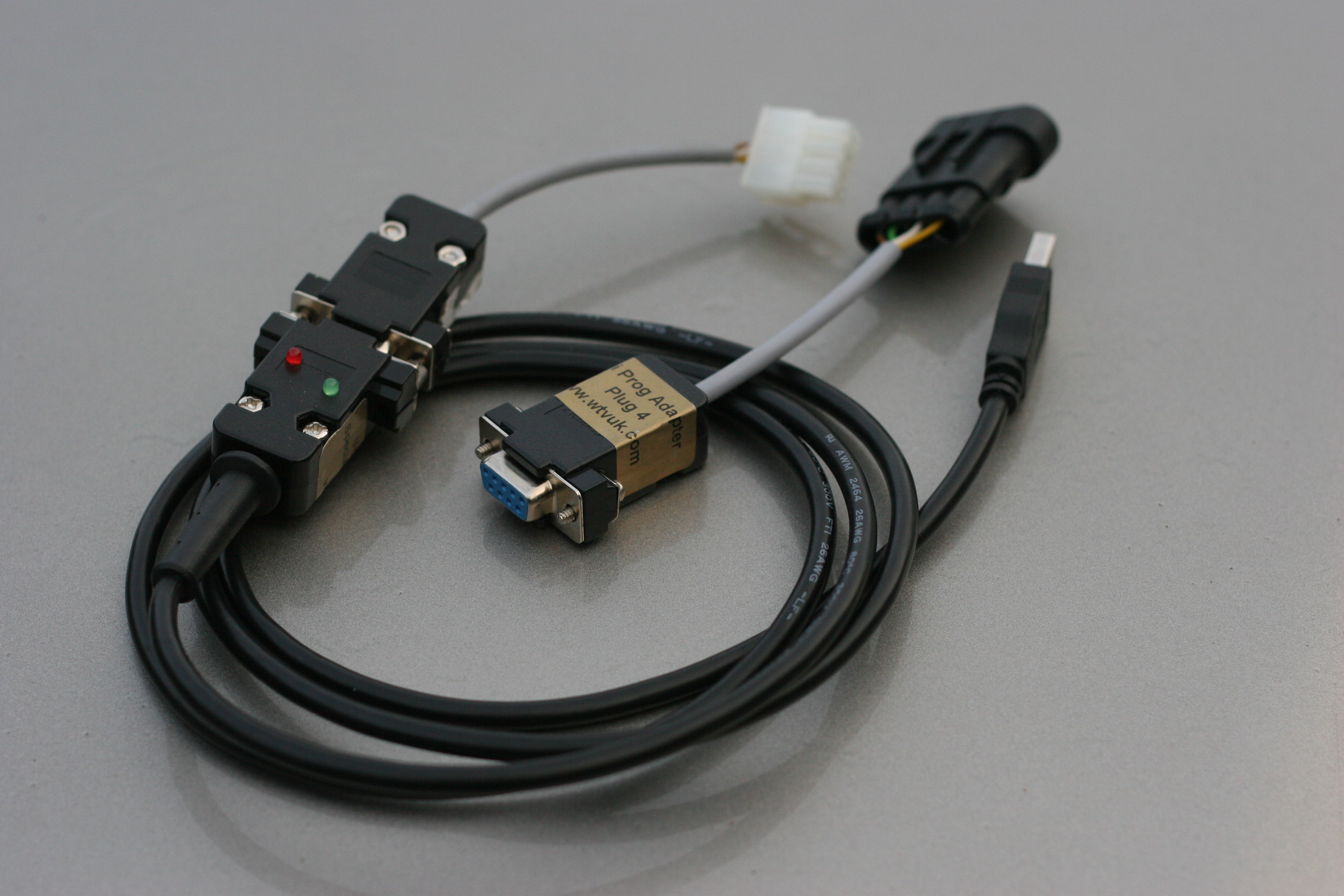

#79 Post by LPGC »
WTV interface bundles (with end cables to suit various LPG ECUs) came with a CD Rom with various LPG software on it. Also on that CD Rom there's tabulated info on which end connectors suit which LPG system ECUs and a picture of all the different end connectors. We can use that info (the tables and the picture of the end connectors) to compare how end connectors for different systems are wired up and/or to make our own adapters. You need to zoom in on the picture of the end connectors to see the plug number (end connector number) and see the wire colours.
Here's the picture of the WTV end connectors
Table of which end connectors suit which LPG ECUs for plugs / end connectors 1 >7
Table of which end connectors suit which LPG ECUs for plugs / end connectors 7 >
Example (that's not related to your concern of getting from adapter 1 to adapter 4)... Adapter 4 is the Superseal end connector that suits most AEB based systems. Adapter 8 is the Superseal end connector that suits most none AEB based systems (e.g. Stag and KME). By comparing the wiring colours between adapter 4 and adapter 8 we can see that only the 2 middle wires are crossed over, the wires at the ends (the live and ground wires) are in the same positions.
Based on the above info it should be easy to make an adapter to get from any one type to any other type regardless of Molex or Superseal.
By far the most popular connections are plug 1 for Molex and plug 4 for Superseal.. and in the majority of cases using the wrong plug for the wrong system won't cause a problem (it will just result in no coms). But there are a few systems for which using the wrong plug will cause reverse polarity on the power pins (e.g. using plug 8 when plug 9 should be used or vice/versa) which will cause problems. There are a few modern systems not listed in WTV's table that have plugs wired like plug 9.

#80 Post by Pinger »
Pinger wrote: Sat Jan 28, 2023 1:15 pm
And that is how it is. The wires are connected to different pins in the 'serial' connector. From the outside looking at the colour of the wires the yellow and brown wires appear 'swapped' but are correct for how they connect within the 'serial' connector. Plug 4 is the correct one.
