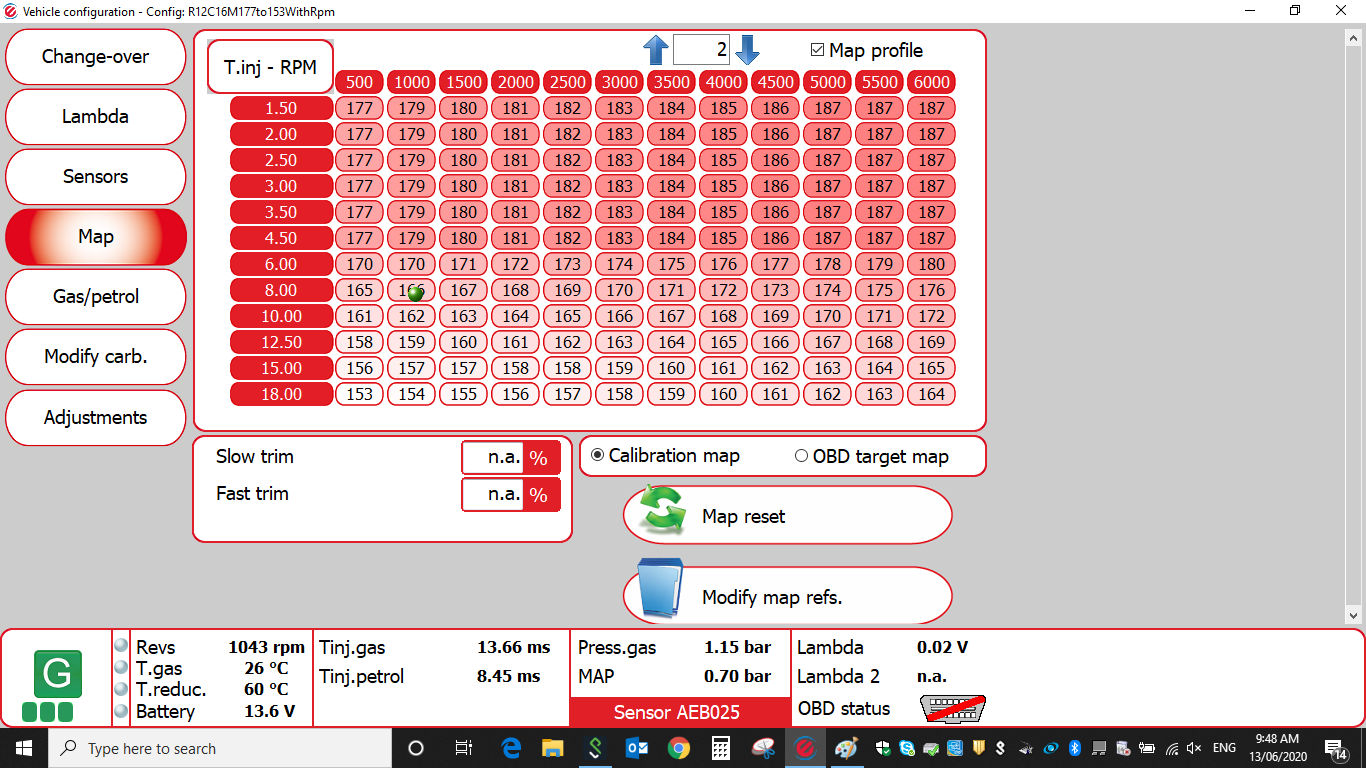

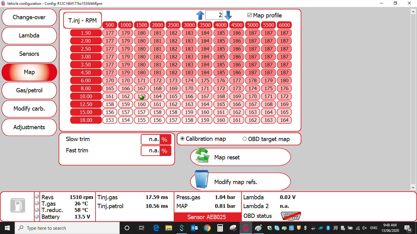

Righto... I got the below screenshots this morning with the engine under load at various RPM. With this map loaded the idle is too low and its missing a bit, running a bit rough in general at any rpm and load. I guess that's because it's running lean as hell with the injector timing set so low? I got a shot at idle on petrol and a shot at idle on lpg for comparison starting points. I was intending to get 1000, 1500 and 2000 rpm under load but the system threw an alarm and switched back to petrol before I could get a shot at 2000 rpm.

"With this map loaded the idle is too low and its missing a bit, running a bit rough in general at any rpm and load. I guess that's because it's running lean as hell with the injector timing set so low?".
Yes it seems ginj's for any given pinj are much lower now and since pressure from the reducer is exactly the same the lower ginjs will have leaned the mixture off.
Below I've listed some of the key info from your screenshots showing the lower ginjs.
This is from your previous settings (your posts #55 and #56)
Pinj Ginj Pgas Map
3.56 8.23 1.11 0.29
9.57 21.00 0.97 0.75 lambda voltage = 0.76
This is from your current settings (your posts #61 and #62)
Pinj Ginj Pgas Map
4.85 9.01 1.06 0.44
10.56 17.59 1.04 0.81
The only time lambda voltage wasn't reading too lean running on gas was with earlier settings with pinj at 9.57 ginj 21 with box number 236. With the later settings pinj of 10.56 gives ginj of only 17.59 with box number 163... This kind of shows that pressure compensation isn't working intuitively or the figures I entered in the most recent map (with 1.6 bar reference pressure) would have given similar ginj to the figures in the old map with reference pressure of 1.2 bar.

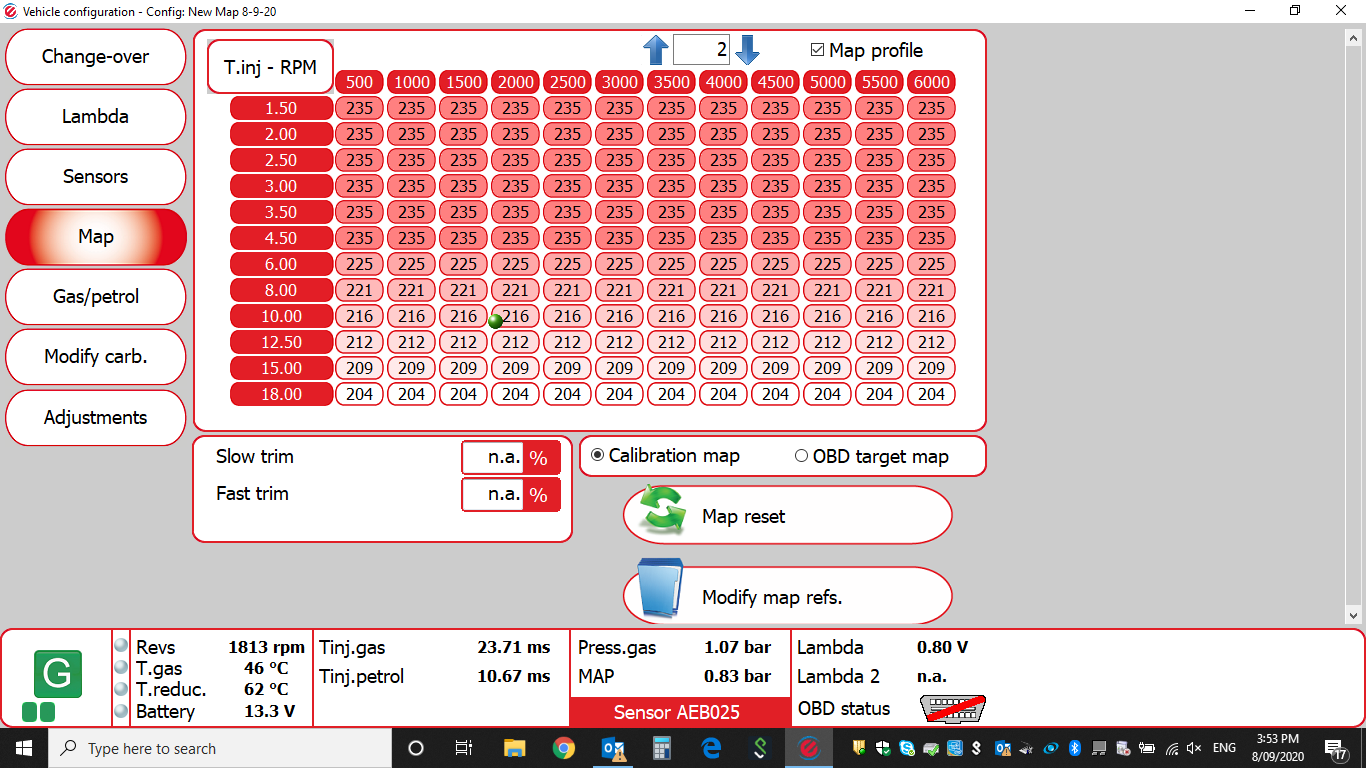

Anyway, yesterday I loaded up the map from post number 56 as you mention above, set the gas reference pressure to 1.6 bar and adjusted all the numbers down by 5% until I got the lambda voltage to about .5 volt at idle. This runs fine. Only trouble is I am now back to the lpg cutting out under high load but it has no petrol addition set on this map. Below screen shot is the map I now have running. I wasn't sure if I was meant to do the entire map by 5% each time or just a particular row, I may be misunderstanding the process here.

Re: Time to do some tuning
Now in this first screenshot below I held my foot on the brake and gave it a bit of gas. The lambda is .8v I then reduced the numbers for that row, did the foot on break thing and now I see about .5v as per the second screenshot. I assume I keep doing this for each row I can until I am getting about .5v across the board.

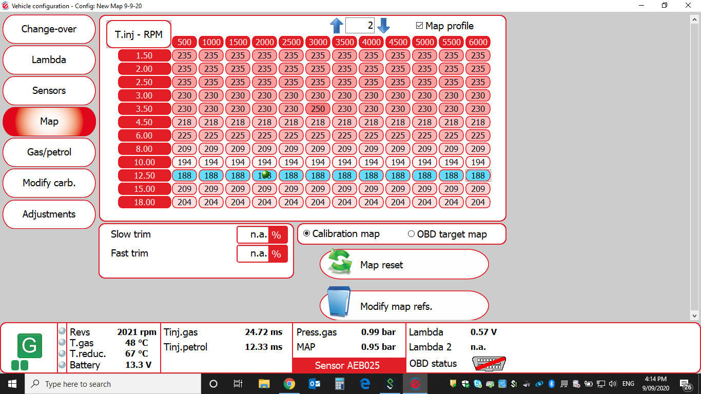

A bit more fiddling and I have the lambda at .57v at 2000 rpm, foot on brake method. I am a bit reluctant to go any higher rpm using this method, worried about my transmission. Anyway, does this look like I am heading in the right direction?

Welcome back Rod.
You're doing the calibration correctly, headed in the right direction.
When you've got correct lambda readings on each row you may need to adjust columns / individual boxes to get mixture correct at various rpms. Mixture / lambda readings may change under various other conditions too such as when gas vapour / reducer temperature are different, if you get calibration seemingly perfect for one set of temperatures you may still want to make a few adjustments to aim for best compromise over the widest range of conditions.
Your pressure and injector combination won't flow enough gas for rich enough fuelling at high rpms and high engine loads, you'll probably want to dial in some petrol addition at some point.
