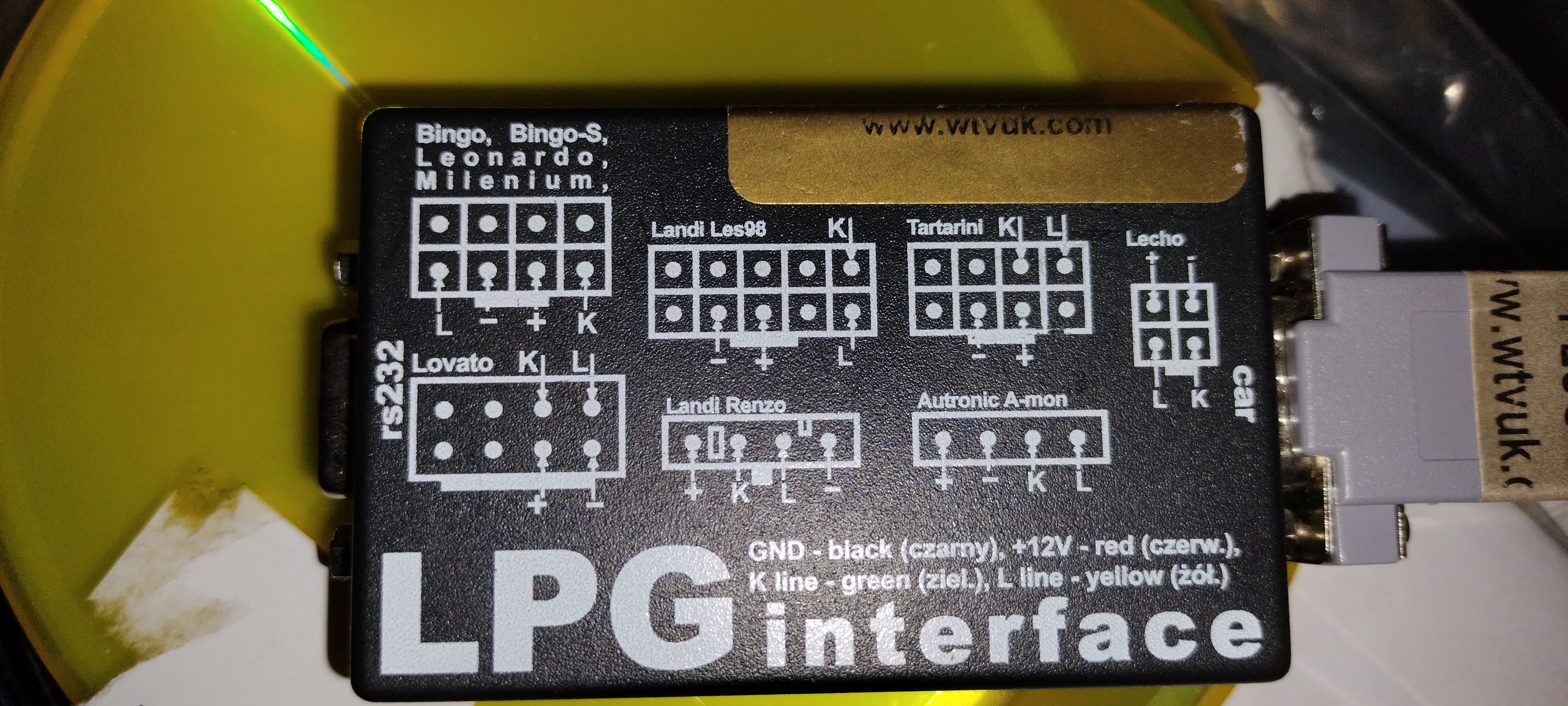

If you take the Top left diagram and the one marked Landi Renzo (another AEB based system) that should give you the required pinouts on both connectors I think? This is from the no-longer available serial WTV interface for multi systems.
- IMG_20221113_175014.jpg (2.83 MiB) Viewed 2518 times
