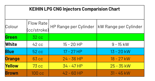

Thanks Simon. It's running at 2.0Bar, whereas I believer LPG would be at 1.2ish. Nevo alerts to run 2.0Bar as soon as there's a cahnge to the fuel type in its menu.
Nonetheless, seems 2.0bar is not enough, Nevo fault log shows low-pressure alerts. It's sometimes possible to see the drop 'on-screen' via Nevo. I didn't press Dai on why he wasn't keen on Zavoli's offerings. I'm aware of taking-up too much of his time, but from what you say, perhaps I should have done. I didn't get a chance to do much to it today, Dai couldn't guarantee my set of Keihin Orange would be much better, but it sounds like they won't be worse?
You're right teh Zavoli PAN are daisy-chained in. It's not too clear in the piccy, but I've rather fallen in love with the bracket they all sit on. I'm set to pull the injector 'plumbing' apart anyway, may as well throw in 5 x Keihin, they just won't look as tidy as the now cleaned-up bracket-mount Zavoli install.
KEIHIN LPG CNG Injectors Comparision Chart.png (44.5 KiB) Viewed 4639 times
Fuel Flow range.png (233.46 KiB) Viewed 4636 times
If I read it right, Keihin Orange will deliver 24-38HP [25-35kW]. We will assume those to be LPG figures, and this Volvo is no road-burner. It does 140HP[104kW] from a five-pot, on petrol, thus knocking 15-20% off from the LPG power figures for methane, and we're still not quite needing Keihin Yellow. What I've got, Keihin Orange 'should' work.

I'm now looking at 3 x TAP. Two 'truant from school' Chinese AEB510 + 1 x Stag TAP 01. At £20 each I can't say no to hte Chinese TAP. And now I have the firmware kit such that it won't smoke them, these are my first port of call. If I can cure the sluggishness I'm happy.
Speaking to Dai, he was not keen on Zavoli PAN either. I might live to regret not taking his advice. As I said, I put a PAN rebuild kit to all five. new springs and valve-seats. I er, think, they run as well as PAN injectors can.
Misfires? The engine had been sat non-running when I last did a compression test. It burns quite a bit of oil. Nonetheless it doesn't sound half bad - still peppy on petrol. It's smooth at idle on both fuels. Stumbles a bit mid-range on both fuels but not badly. I'm going to give it another compression-test, maybe a valve has seated? It's condition is not helping matters, but hell... this is 'bangernomics', and it runs. If this carry-on b*ggers an already b*ggered lump, better I do it now. My logic? Burn valves now getting it right, over putting in any decent rebuilt lump and mess that up.
For now I'm going to shove a Chinese TAP on. Until I have the non-fried TAP issue sorted i see no point looking-up Dai. TAp goes on this weekend at latest. Not sure how a TAP will affect the Nevo set-up, last done without the TAP.
With so many varaibles, to be honest, I'm getting out of my depth. Pig to install 'right' hence I've avoided it; so happens I've an Innovate wideband gauge knocking about. Might just put that on. I'm a big fan of wideband gauges, helped a lot with my Land-rover series install. Thus this fool can 'see' what happens, and when. A LR series is no lambda vehicle, all I did was put a boss on the exhaust. Replacing the Volvo narrowband with a wideband and using the Innovate wideband gauge to emulate the narrowband is supposed to be possible, only my money says it adds another variable, hence I'm wary. And I'm wary of doing as my LR adding a WB probe independently. Not keen to beggar the exhaust.
