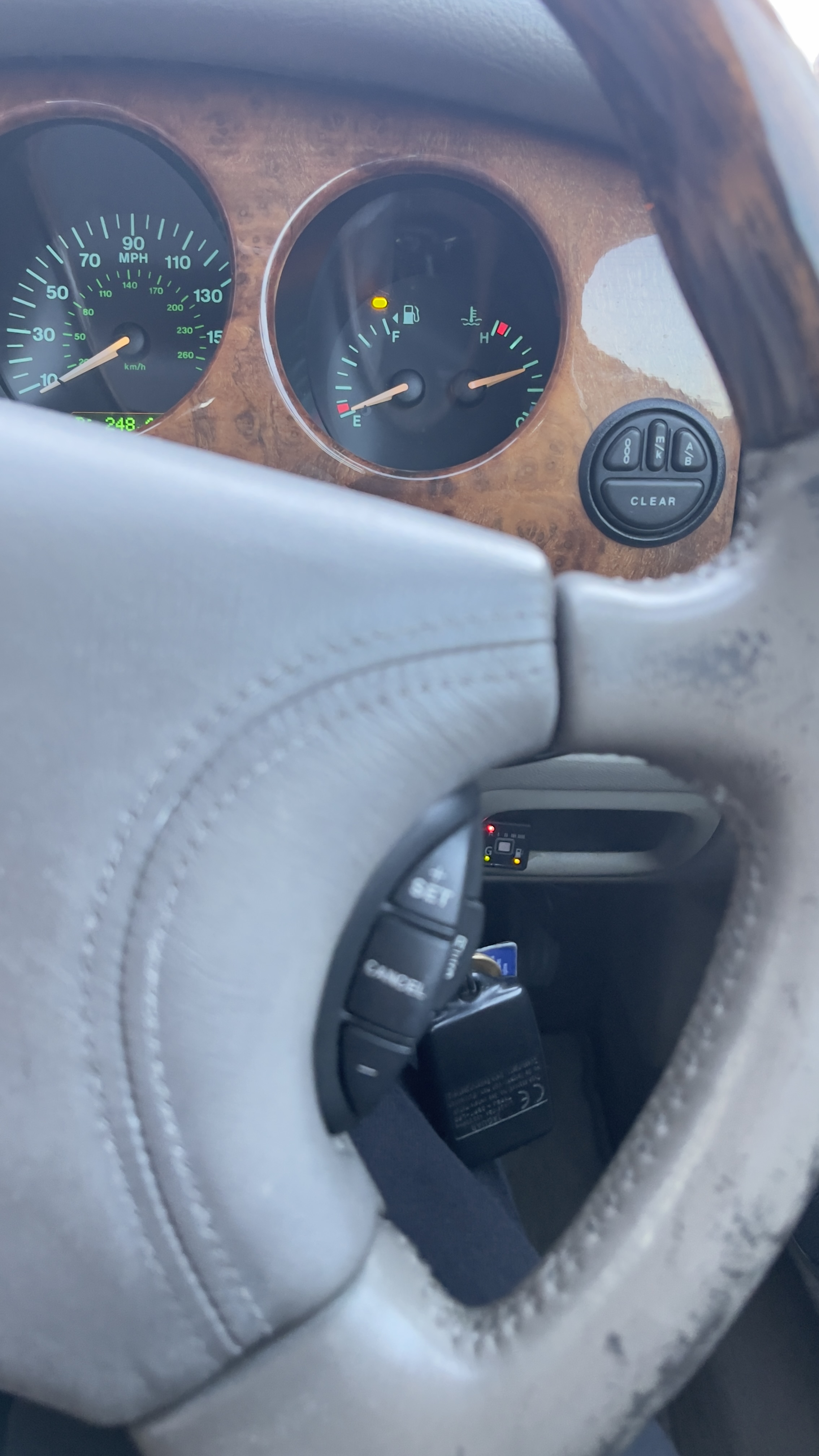

In the attached pic, the car was warm. I rev'd it a bit and it then switched to LPG. So hm, I will investigate what the reducer plumbing is and what I need to do.Gilbertd wrote: Sat Jun 11, 2022 7:28 pm Thermostat failed open? Modern stats tend to fail open rather than closed like the older ones did. That will cause it to take a long time to get up to temperature. If it takes a long time to changeover if you aren't moving but changes over as soon as you start driving, that would suggest the reducer plumbing isn't ideal so it needs more flow than it gets at idle.

Assuming your gauge is the same as most other JLR cars, it will be a compressed scale so will read cold until the engine is up to around 60-70 degrees. If that is the case, even though your change over temperature will be set at something like 40 degrees, so should change over long before then. Both my current cars run single point systems so can, and do, run on LPG from stone cold, a previous one I owned with a multipoint would change over as soon as the gauge started to move off the blue. Simon will be able to advise where the reducer needs to be plumbed in to get full flow as it sounds like you don't have full flow so it isn't getting as hot as it should.
