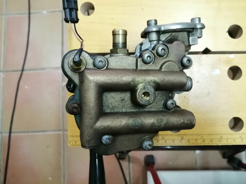

It looks like it is based on a tomasetto.
I'll be pulling it today at sometime

Sorted, turns out that it was just the o rings hardened on the water in and out, now leak free, did get some pics but can't find how to upload them?

pics
- reducer 2.jpg (293.27 KiB) Viewed 13134 times
- reducer 1.jpg (303.66 KiB) Viewed 13134 times

It definitely looks like one of the Tomosetto type, The back end is a lot larger than the one I posted, but would suspect you'd get the right diaphrams by looking for them under the Tomosetto types if it comes to needing them in the future
Some of them use the same diaphrams according to what info is available, though not seen one with the back side looking like that to say for sure you could use one. And it may be better to replace the reducer anyway if it gets that bad. Mine came apart with the only issue being the temp sensor, yours has a plug on the sensor so could leave it in place anyway (I should have cut the wires on mine but thought it would unscrew ok).
Looking around, the closest model i can see is the AT-09 Artic for the extra bit on the back (must be the preheater)
https://www.tomasetto.com/en/products/l ... model-at09

Looked fairly clean inside with no heavy ends present, rubber gasket quite hard but no sign of cracking, I had no o rings available and we went into lockdown today so have just cleaned up the water elbow connectors and smothered them and the o rings in hylomar blue, leak free at the moment anyway
