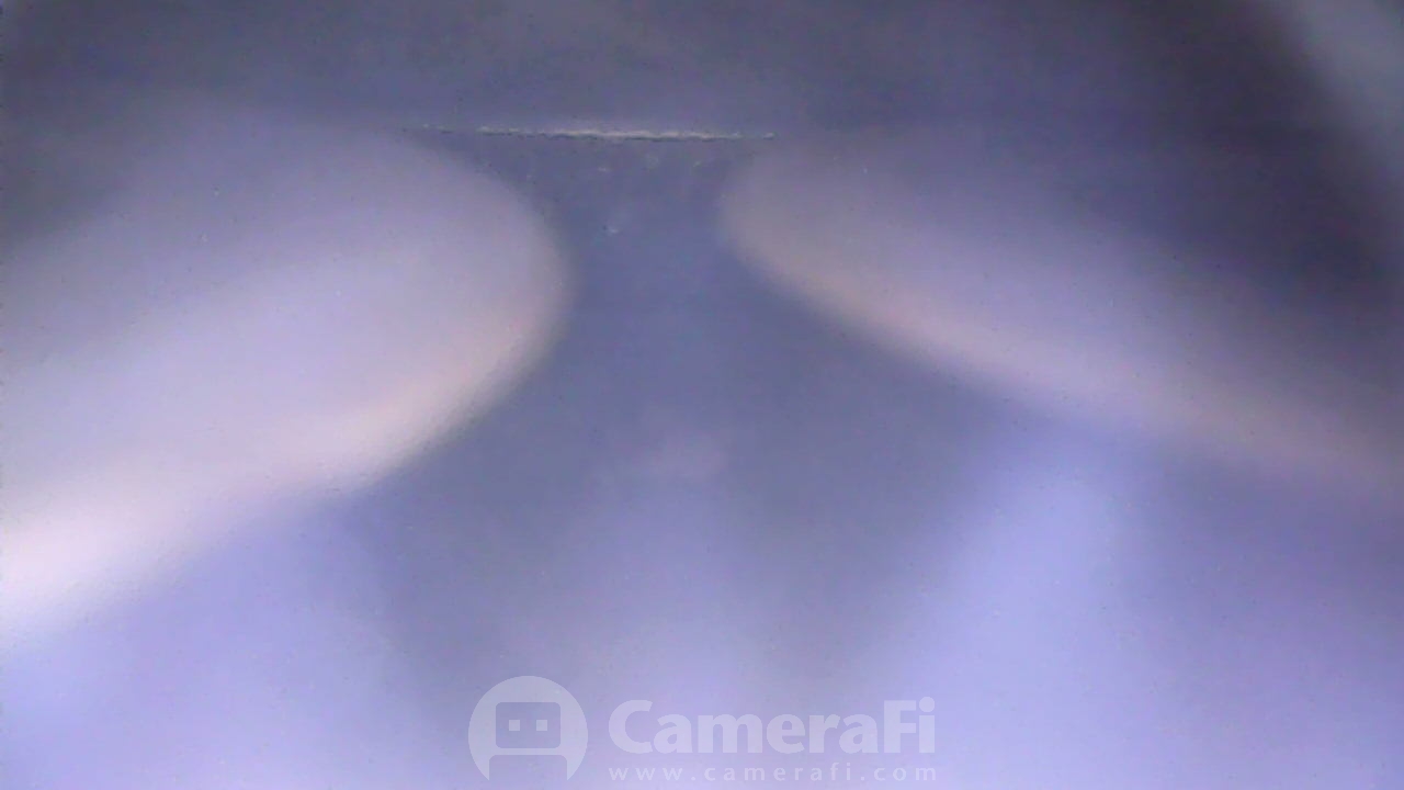

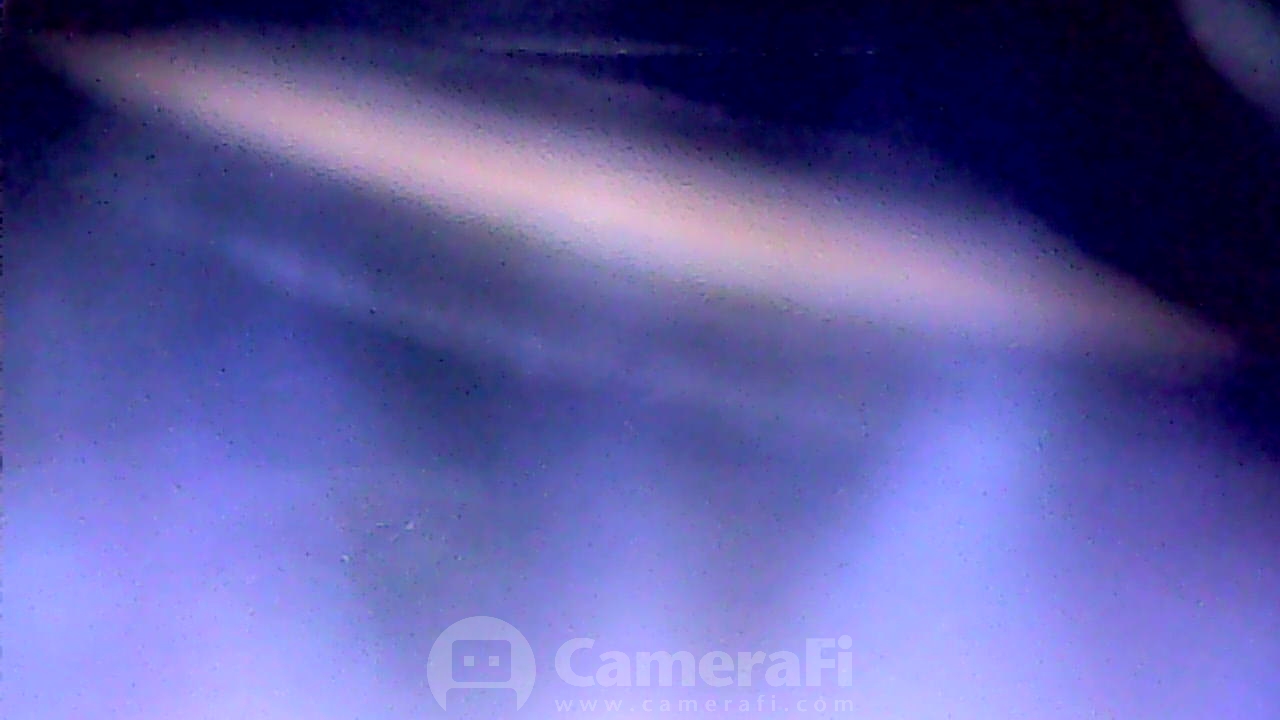

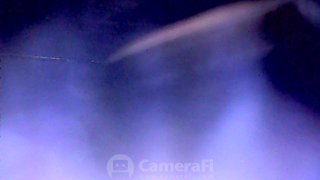

Has anyone pictures of heads, valves and seats from "soft" manufacturers that have ran on gas?

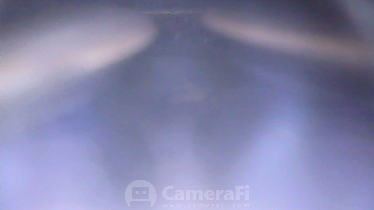

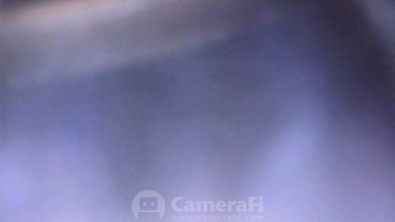

I found a little USB camera and got some very poor quality pics from within this cylinder with it rotated such that the intake is open. I think I can see the valve is badly worn. Or maybe that's just my interpretation of what I'm seeing. It seems almost like a disk on a stick, as apposed to the shape a valve should be. Can't see anything obvious with the seats, cylinder bore or piston. But due to the quality it would need to be very wrong for me to see it.
Definitely needs the head off.

Some more terrible pictures.

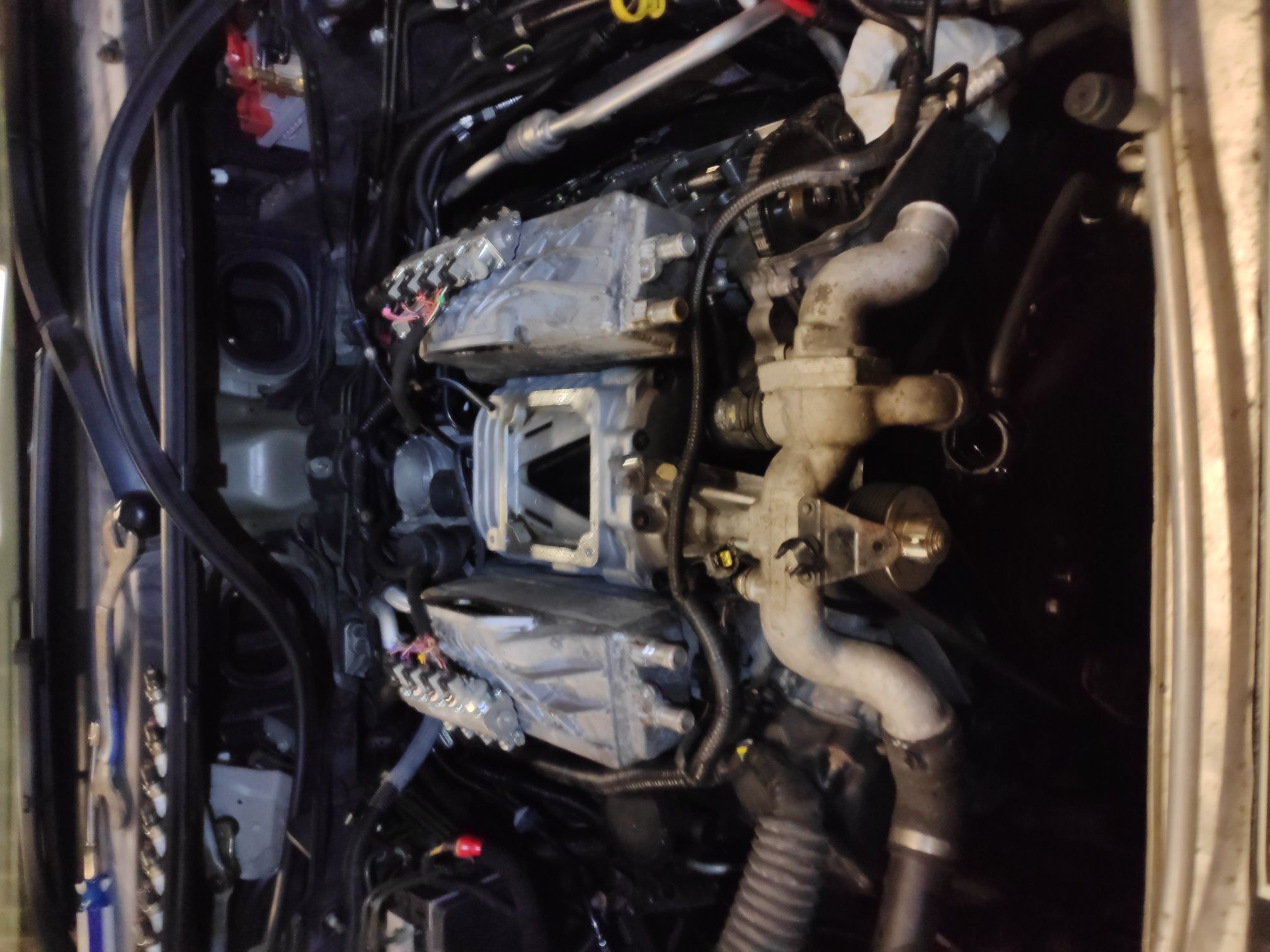

Hello
I'm the owner that Simon and Richard have mentioned. I'm on the Full Fat forum and the P38 Forum with various cars.
I bought a Supercharged RR last week that was on eBay for spares or repair. I spoke to the owner, an LR specialist diagnosed a misfire on 1 cylinder but wouldn't look at the car due to it having LPG installed. The LPG guy he used told him "It'll be valve seat recession without a doubt" without even looking at the car. The price he said he wanted for the car meant it was worth me having a gamble on.
It was delivered to me on Sunday and to my amazement it turns out the coil pack in cylinder 1 was a melted mess!
I replaced that coil with one I'd bought on eBay as a "that might be handy" scenario and thankfully I'm running on 8 cylinders again.
I'm going to do a major service on it so I might do a compression test whilst the plugs are out just so I've got something to reference. It'll be interesting to compare it to the numbers you've posted above. Did you do yours wet or dry? Was the throttle wide open? I just need to figure out which one is the fuel pump relay and I'll have a go. When running now though mine is silky smooth but I've not started it whilst it's properly cold since doing the coil as it's in the workshop now.

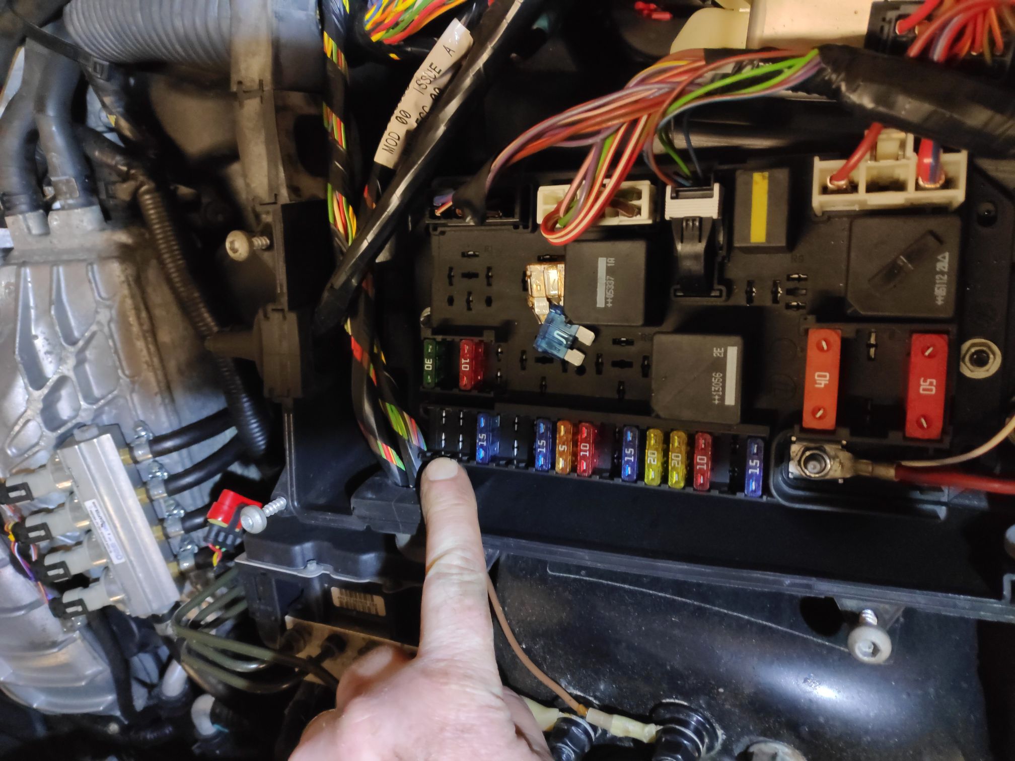

These 3 fuses seem to allow you to crank the engine without fuel or spark. My compression tests where done dry, throttle closed and with ice on the car, so not ideal, but I was only looking for a difference between cylinders, not an exact number. My good bank of cylinders are all mid 9 bar on my gauge. Definitely would be interested in what yours are.
If I where you, or any Jag engined owner, I would do a valve clearance check knowing what I know now. While it's a bit of a chore, it could save you having to pull a head, so well worth doing.

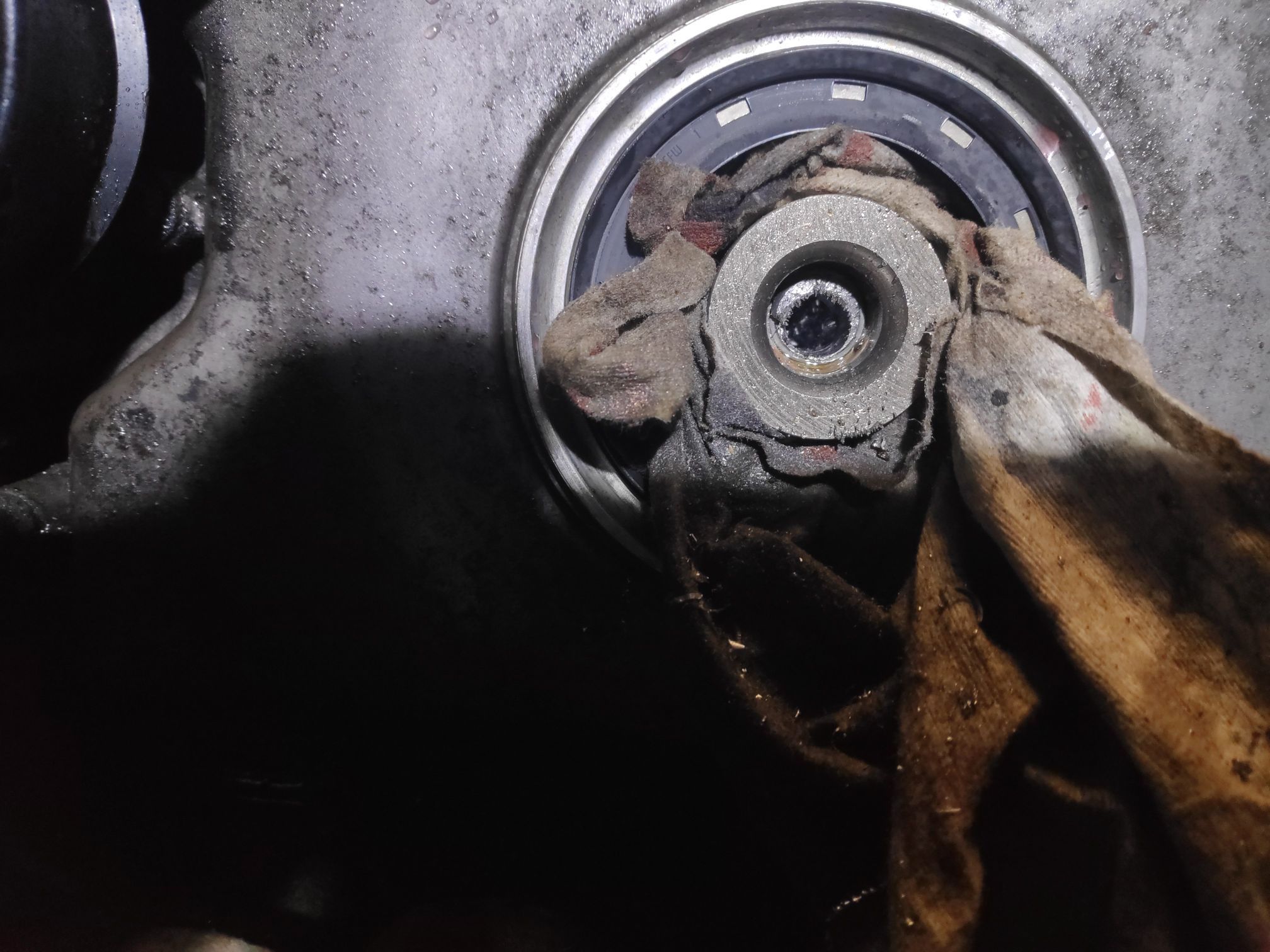

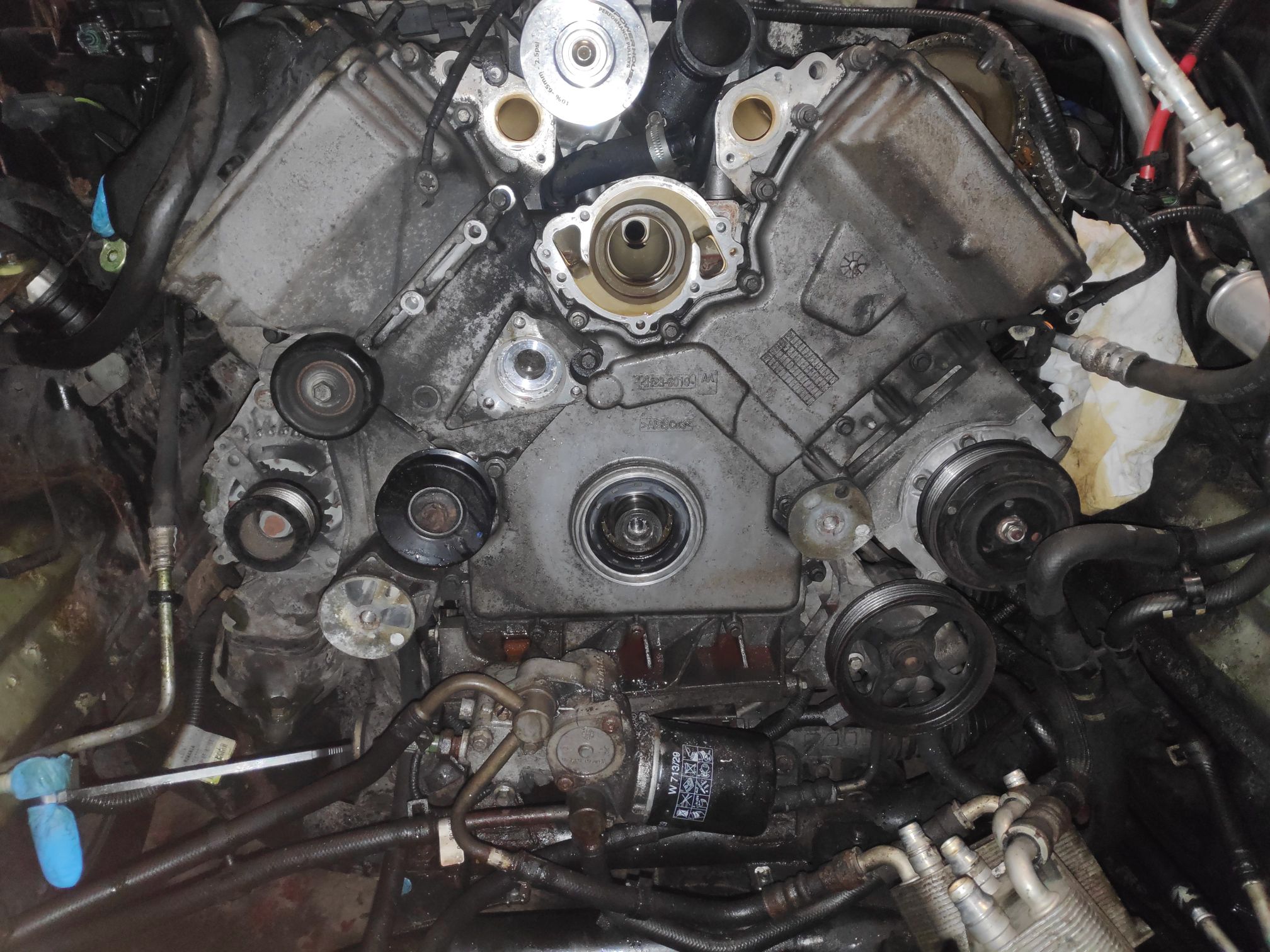

So things have gone downhill badly. Very badly.
I got as far as taking the crank bolt out which was tight. 24mm head M16 by the looks of it. Then:
Re: Engineering company suggestions for hard valves/seats
So, I got the pully off and found the bolt is broke in the crank, about 12mm recessed. You can see it's been in with red locktight. I packed paper around the hole in the timing cover and stared with my box of cobalt drills kept for special occasions. I drilled it out to 10.2mm in as close to the centre as I possibly could. The remaining part of the crank bolt is about 30mm in depth. I then tapped it M12 and got a M12 bolt with a piece of pipe that's 12mm id 16mm od slipped that over the bolt and wound it in as tight as I could into the crankshaft. I then heated the bolt and pipe untill it was starting to glow, setting fire to the crankshaft seal etc in an attempt to weaken the locktight.
But when I loosened the M12 bolt it didn't take the remains of the crank bolt with it.
So that's where I'm at. I have had very bad luck with easy outs in the past so I don't want to break one in the crank here. But maybe I'm into that level now. Really I need an engine...

Oh shit... that’s not good!
Have a look at spark erosion. A decent machine shop could probably get it out using that but you’d at least need the engine out of the car and potentially the crank out of the engine
