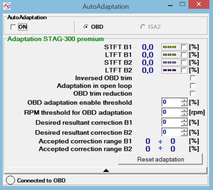

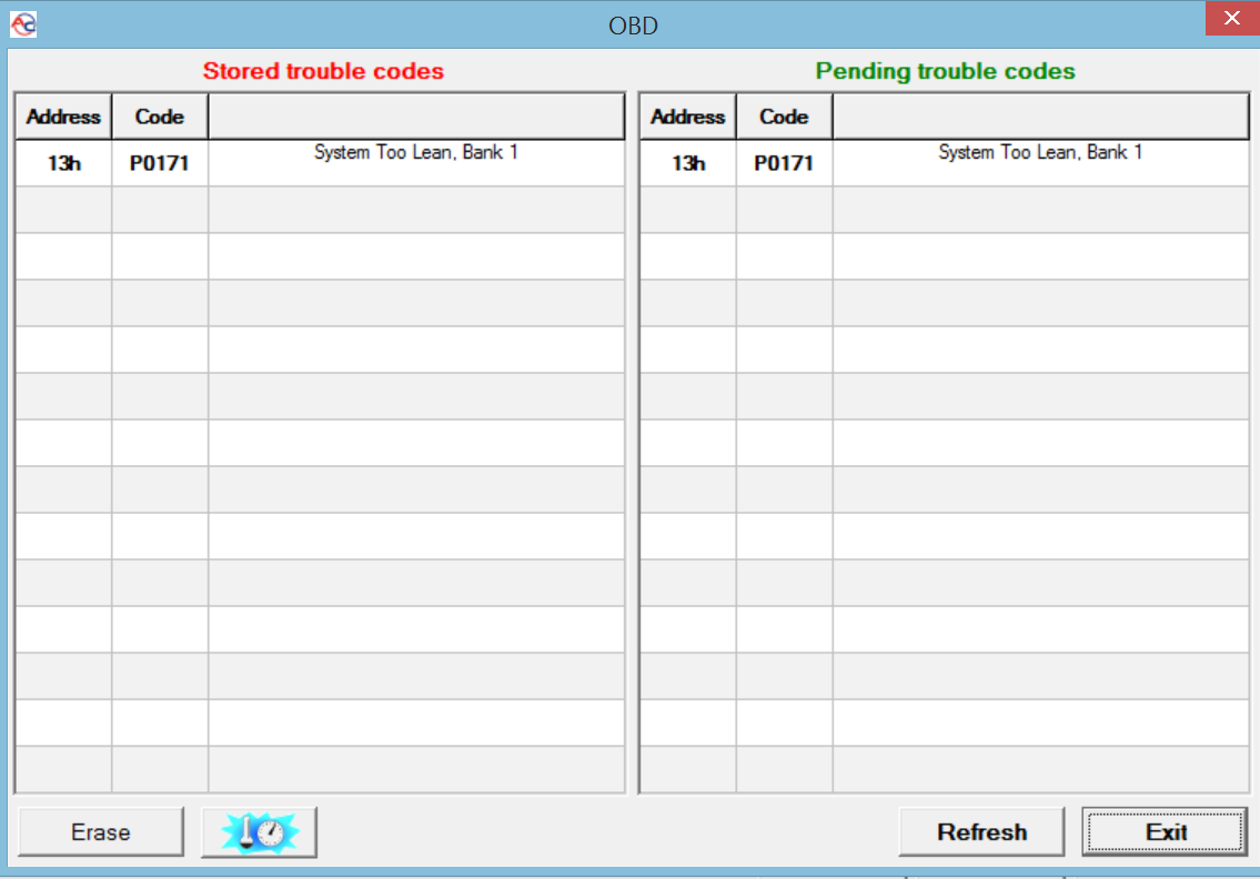

Re: Stag Calibration
Hi
I had the stag lpg system installed in 2013 so had it about 7 years.
The car runs fine the engine light and error code just come on when running on gas. I've attached a few screen shots below showing error code and other settings.
I do have autoadaption but it's not enabled.

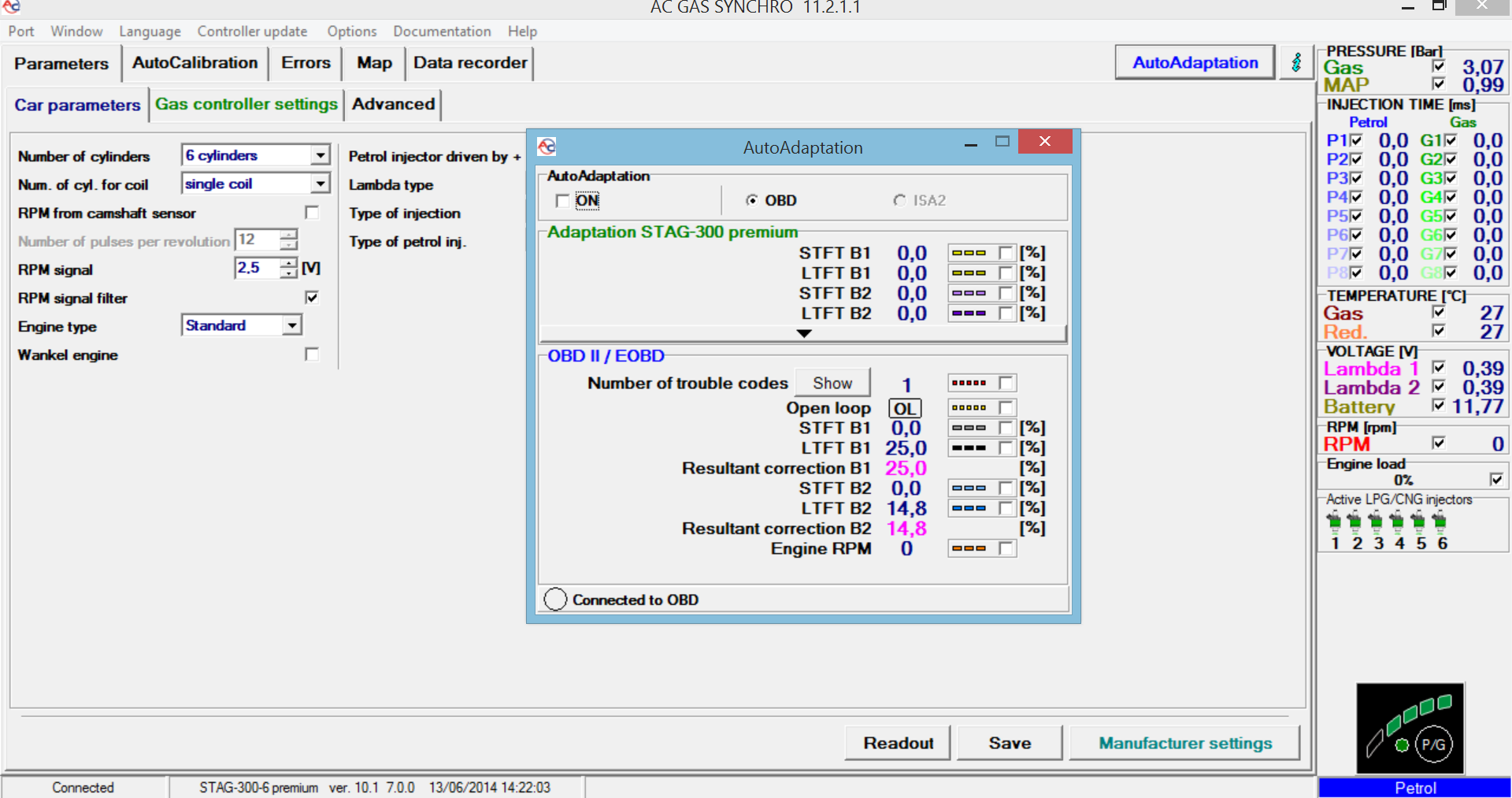

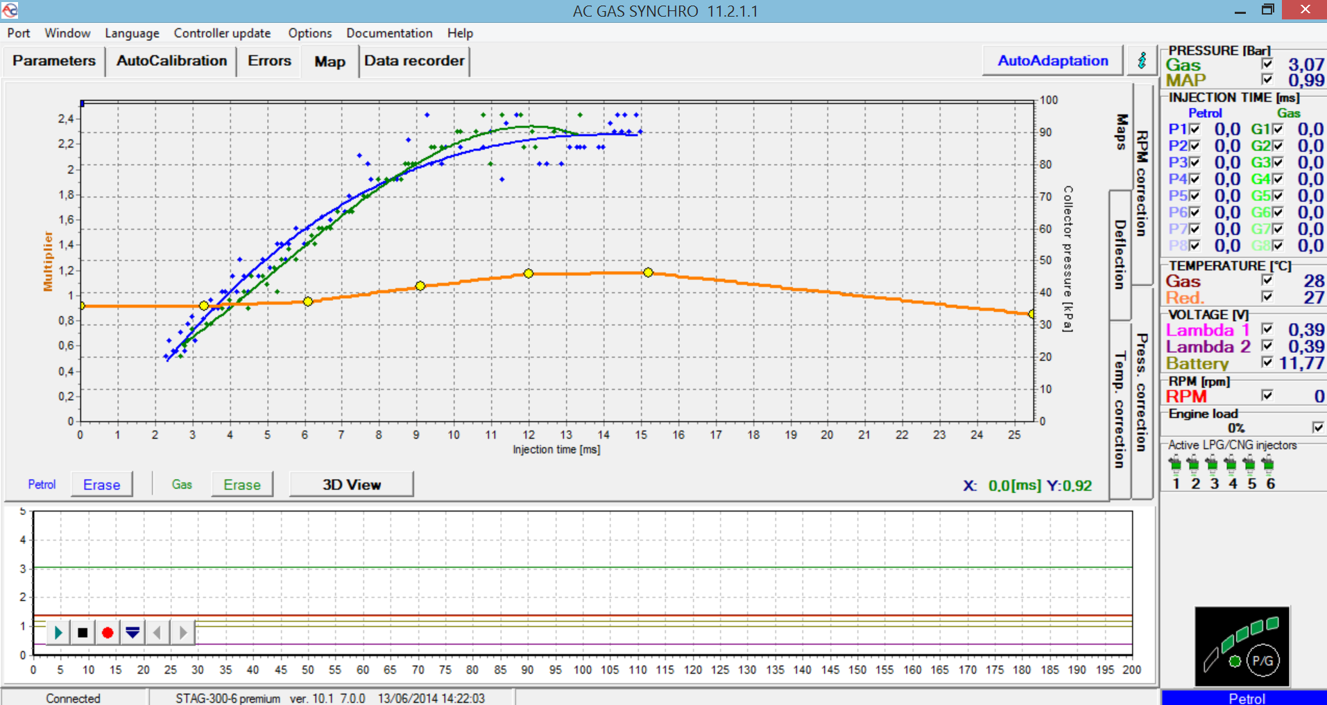

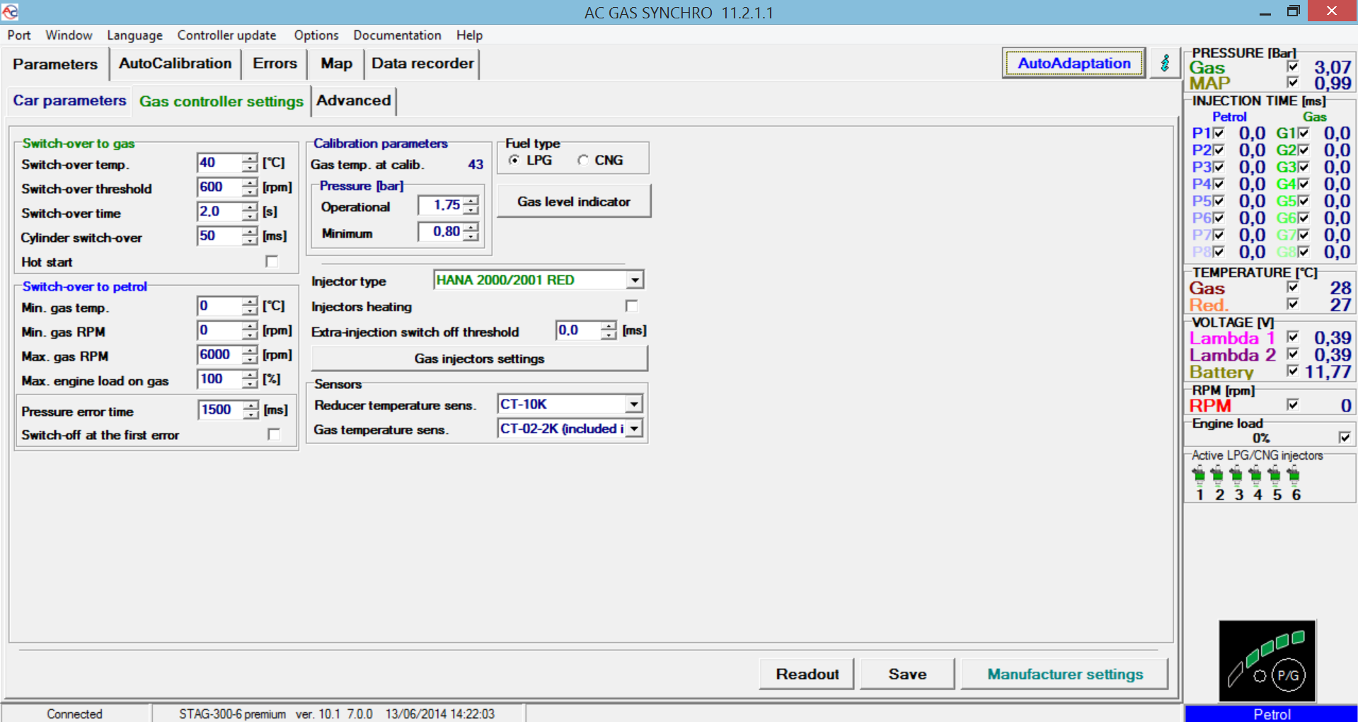

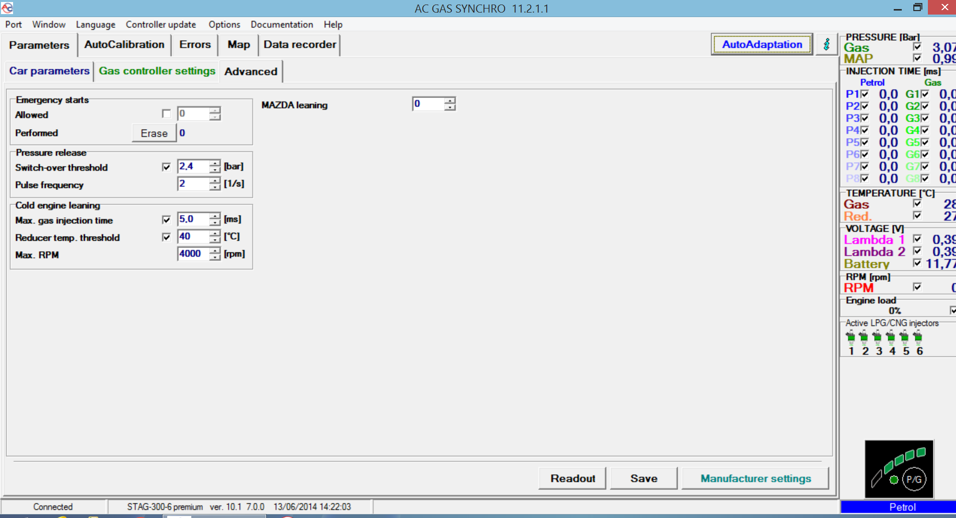

Setup
- Advanced.PNG (242.55 KiB) Viewed 5605 times
- Gas Controller settings.PNG (316.49 KiB) Viewed 5605 times
- Map.PNG (292.56 KiB) Viewed 5605 times
The engine isn't running in your screenshots but there are a couple of things to note...
The very high gas pressure reading of 3.07 bar likely points to a reducer problem (in which the gas entry valve internal of the reducer continues to allow a little gas to flow past it even during over-pressure situations). Whether or not this will cause a problem when the vehicle is running on gas depends on how severe such internal problem is but it will cause a problem during switching from petrol to LPG. The high pressure reading could also be caused if the reducer got too cold (a cold reducer can output liquid gas which the vaporises in rubber pipes).
The shape of the multiplier map (yellow line in bottom pic) is wrong, it would never be that bell shape with the peak at 15ms on any engine if the physical install is correct (appropriate injectors, nozzles and pressure). Normally if calibration (multiplier map) is something like correct the blue and green dots should quite closely match up on an engine that makes use of a throttle setup (not a Valvetronic or Valvetronic derivative) and if the engine doesn't need a fuel return to be fitted as part of the LPG install.
On your install they only match up / merge at around 8.5ms... However, if we did adjust the multiplier map to get the green dots to align with the blue dots on this install the shape of the multiplier map would then still be wrong (it would still start off low and peak at 8.5ms) and this also points to aspects of the install being wrong (or the engine being some type of Valvetronic setup which we know your engine isn't). Aspects that could be wrong could just be the faulty reducer already mentioned, or could be incorrect injector nozzle and working pressure combination, or could be due to other settings in the LPG ECU such as RPM compensation or the 'cold engine leaning' settings could be having a negative effect.
In the MAP screen, click on the tab for RPM correction, if any of the numbers in the table are not zero(?) post a screen shot of the rpm correction screen.
Let's see a few screenshots of the engine warmed up and running on LPG (so we can see pressure and temperature readings). At least one with the engine idling under no load, and one with petrol injector readings of around 7ms.
Hana red injectors are selected in software, does the install have Hana red injectors?
Thinking out loud - We don't know what size nozzles are fitted in the injectors(?) but if they're the old Hana red injectors they'd have 2.4mm nozzles.
I'd expect 2.4 nozzles to be about right for this engine at moderate pressure (say 1.4 bar) but the installer has set software reference pressure to 1.75 bar which is quite a high pressure. An installer might set a high pressure to compensate for nozzles a bit on the small side or in attempt to get a reducer that's a bit under-rated for the power of the engine to flow a bit more gas.
Hi yes they are Hanna red injectors 2.4. I replaced one that failed with a Hanna gold with a 2.4 nozzle adapter.

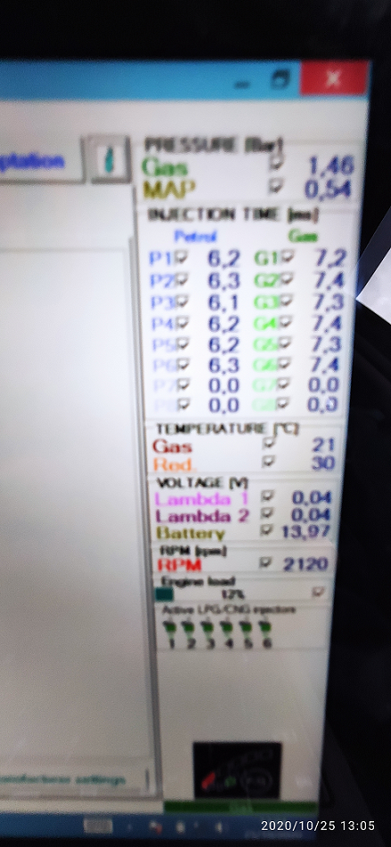

@ higher rpm
[attachment=0]IMG_20201025_130517.png[/attachment][attachment=1]IMG_20201025_130514.png[/attachment]
No automatic entries in RPM correction is a good thing, to do fine tuning later you'll probably want to make some manual entries.
What model reducer is fitted? It's not very pressure stable on this install, this might be because it's very much under-spec'd for the install, or because the pressure adjustment has been wound up too much (it might be more pressure stable at a lower pressure like 1.6 bar at idle), or because it's broken.
I'd try adjusting pressure down to 1.6 bar when running on gas at idle (because at 2120 rpm pinj is 6.2ms, ginj is 7.2ms, yet delta pressure is only 1.46 bar). Then see how much pressure drops under slight load like the same 2120rpm 6ms pinj load in one of your screenshots.
Then see if pressure continues to rise when running on petrol but LPG solenoid valves are open - If there's quite a lot of high pressure pipe between the reducer solenoid valve and the reducer you can disregard 'LPG solenoid valves are open' but if the solenoid valve is directly attached to the reducer it's better to check for a pressure rise while running on petrol but with solenoid valves open.
Do you have the correct spec reducer temp sensor selected in software (it seems you don't)? If it's set wrong then in conjunction with the 'max ginj with cold reducer' settings enabled it could cause problems. We wouldn't normally see higher gas vapor temps than reducer temps, we can presume the gas vapour temp reading is correct if it's built into the pressure sensor.

The reducer temp sensor is what they selected at instal.
It is an OMVL Dream reducer, HP on the sticker supposedly points to it being the high power (flow) version, the old versions of the Dream HP reducer would be good for the best part of 400bhp but more recent versions are not as good in terms of max flow / power handling ability as the old versions. Should be OK for your ZT though, if it's not broke anyway!
Pressure output would be around 1.5 bar as standard but pressure can be adjusted by turning the 10mm pipe nut / pressure adjuster brass hex fitting that the vacuum pipe connects to, screwed all the way in the HP reducer used to do around 1.7 bar. They're not the most pressure stable reducer but they're not usually prone to failing in a way which sees pressure reach 3+ bar.
All your screenshots show relatively cool temperatures for both reducer and gas. If the engine hadn't been running long the low temps could be due to that, but if the engine was fully up to temperature the low temp readings could point to an issue with not enough hot water flowing through the reducer. If there's not enough water flowing through the reducer the reducer and gas temps may drop to very low temps during driving, if temps fall low enough the reducer may output liquid gas (into rubber gas vapour pipes) which then evaporates in the vapour pipes to cause very high pressure in vapour pipes - The 3bar reading could be due to the reducer getting too cold?
Error code went away after I increased the switch over temperature. I thik this is what created the error in the first place when I reduced it. Thanks for all your help especially LPGC.
