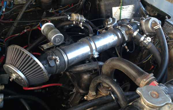

OK, I've had a play and as suggestions...:
a) Try running with SU piston removed
Thought about doing this first, but even if it works, I'm not sure it gets me anywhere or tell me much - I need the piston in place, whereas...
b) 1 x BLOS - choking off inlet
Baked-bean tin.... this helped a lot. It proves what removing the SU piston proves but is quicker to do.
c) Filter >> 1 x BLOS >> 70mm mixer >> SU >> Manifold
This failed. Would barely run, all the screws I could find would be right in and then I could get it to idle - just. AFR was very rich. Oddly it'd die weak just off idle. I concluded this was caused by screws in 'full in" strangling demand. I gave up
d) Filter >> 70mm mixer >> 1 x BLOS >> SU >> Manifold
This worked brilliantly, a bit of fettling and it's pretty much at stoich throughout the rev range. 2 x BLOS helped, this it liked more - runs better still. Power valve fitted only to the cooker-ring. Screwed almost home, PV permits a float-level of gas, the majority going thru' the BLOS.
It still looks a fright, but I'm down to 1 x BLOS + 1 x cooker ring. It runs better than it did with 2 x BLOS. I conclude a suction issue related to the greater demands of the gas. A BLOS, be it one or two is superior to plain mixers in this set-up. The BLOS keeps 'stoich' really well. Simple mixers don't seem to create the suction required without a baked-bean tin? I've the richest needle in the BLOS I could get. If I 'doctor' this one or get an ever richer needle, I reckon I could be rid of the cooker ring. The hero in this set-up is the BLOS.

I think it's great that it's running well but there will be a simpler neater solution. Mixers can usually be fitted with various sizes of venturi, this isn't to say a Blos or even 2 won't do just as good a job but beware drawing conclusions. If 2 Blos' are no detriment to 1 Blos, then 1000 Blos wouldn't be a detriment to 1 Blos.. But it's intuitive that 1000 Blos would be a detriment and maybe could be more of a detriment to airflow than a smaller venturi on a 70mm mixer.
CNG
Joined: Sat Oct 20, 2012 5:54 pm
Re: What pressure should a Single point vapouriser/reducer be set to?
#46 Post by CNG »
Thanks for the pat on the back RobXX, however I can't see it's truly warranted quite yet. As my post the solution works in this set-up, more by luck than judgement. It shouldn't require two of any mixer, BLOS or otherwise, and LPGC is absolutely correct, it's not elegant. Just better than it was. It works better than it has any right to?!
I'm pretty sure with more fettling, from what I've learnt about this set-up, putting the second BLOS back on, and it'd be better still. But I don't want 2 x BLOS, at some point down the line, that's asking for trouble.
And jeez. That gauge is rather incongruous stuck there, however it's been damned useful... Wavering on/very near Stoich at around 16.9 -17.3, for a mechanical device I reckon that's v.good. Mixers alone won't work, the BLOS is needed to give vacuum, and nearly manages this on it's own. Bought with a P38 Leonardo kit on eBay, I've got another 70mm mixer on the way. Added to my current 70mm mixer, I'll give it a go. 2 x mixers metered via the Leo might provide vacuum the SU mixer couldn't. I would agree with LPGC, I'm reaching for a false conclusion. Shoving an AEB Leonardo on will suffice for much better metering than any classic Land rover warrants, but something is still amiss.

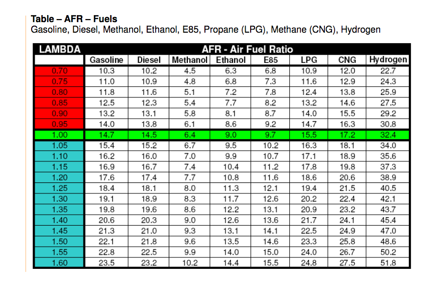

I had to smile. I hope so, we're in deep doo-doo if it's not. I'm not sure it'd even run on 14.7. It so happens I now have the gauge displaying Lambda. Lambda 1.0 is Lambda 1.0 is Lambda 1.0 no matter what the fuel type, and in the odd moment I run petrol, it means the scale stays put. The sensor is reading the O2 left after combustion, thus for Lambda 1.0 that's the same regardless of fuel. Minded to this, I'm not sure what the fascination is with AFR, Lambda is far less confusing eg: you wouldn't have needed the question.
AFR vs Lambda Table1.png (153.06 KiB) Viewed 7206 times
Methinks, at 6.4 for Lambda, methanol might be entertaining. One thing I've looked-up and not found a proper answer to, is why if stoich is perfect combustion, will racers run 'rich'. It gives more power, but why? I had it we want air and as much as the fuel will burn, not less?
