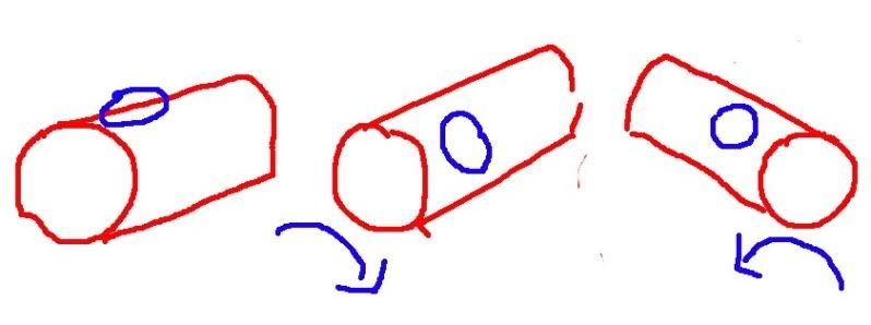

Someone tell me again about the tank angle thing
When you say 30 degree which way round do you mean I should rotate the tank

Toolless wrote:Someone tell me again about the tank angle thing
i'd get the leak fixed 1st before moving on to something else.

#185 Post by john_d » Sun Aug 22, 2010 6:04 pm
30 up from horizontal

demonicwillow wrote:The one on the right, but make sure you rotate it the right way
Which way?

#188 Post by john_d » Sun Aug 22, 2010 8:50 pm
that depends on which way your car is facing

Toolless wrote:Which way?
So the top of the multivalve is at the top. Get it wrong and your fuel gauge will read backwards, it'll never fill from empty because when it's empty the valve will think it's full and not allow you to put any in.

Gilbertd wrote: So the top of the multivalve is at the top. Get it wrong and your fuel gauge will read backwards, it'll never fill from empty because when it's empty the valve will think it's full and not allow you to put any in.
What are you talking about!
it is at the top
Whats all this about turn it at a 30 degree angle now it just sounds like a load of twaddle
Man a life!
Think I will just pop in to town tomorrow and put a fivers worth in the tank and see what happens

#192 Post by john_d » Mon Aug 23, 2010 7:30 am
it is at the top
Man a life!
30 degree up from horizontal and facing the rear of the car
