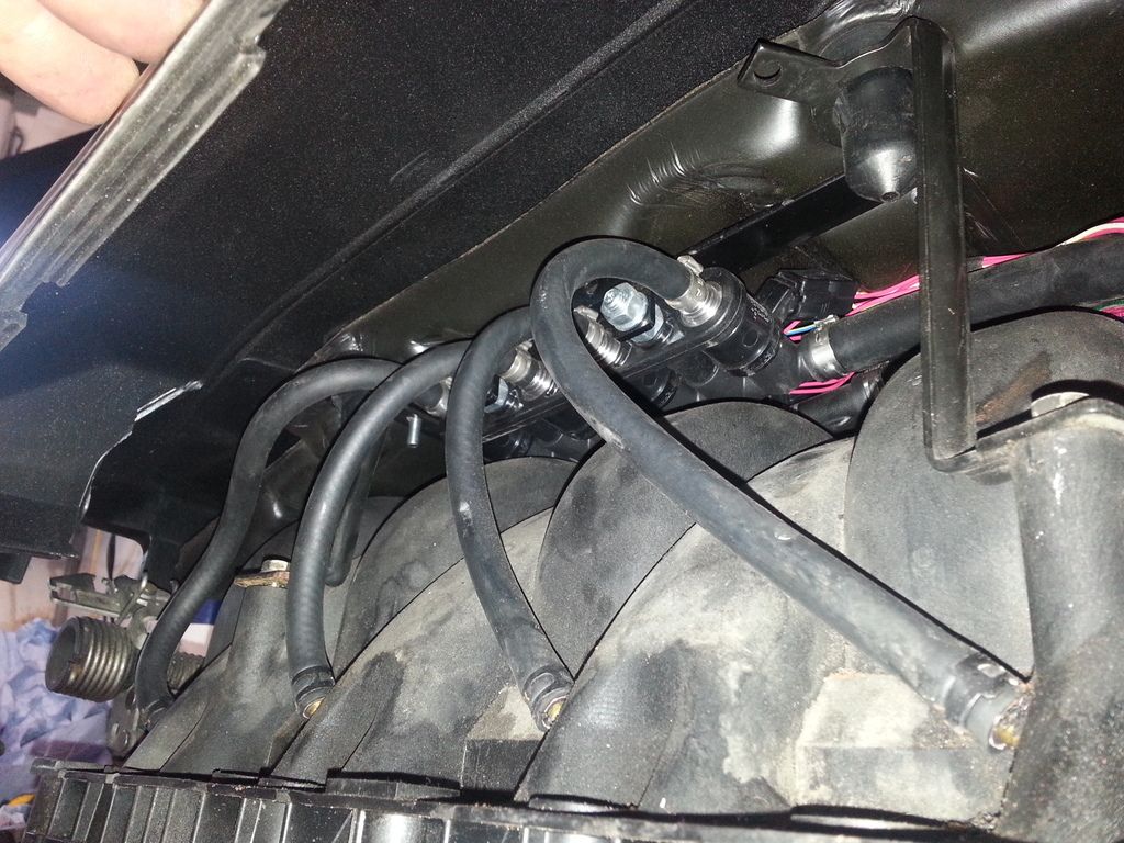

I defer to Simon's advice here, but in my opinion you do need to remove the intake manifold to locate injector spuds as close to the original petrol injector nozzles as possible. Here's the locations on my 740i:
Thanks for the pic and advice I was currently looking at a second hand prins kit but iv not used this brand before it seems to have a metal ecu and a black plastic ecu could anyone update me on why tis system would have 2 thanks
