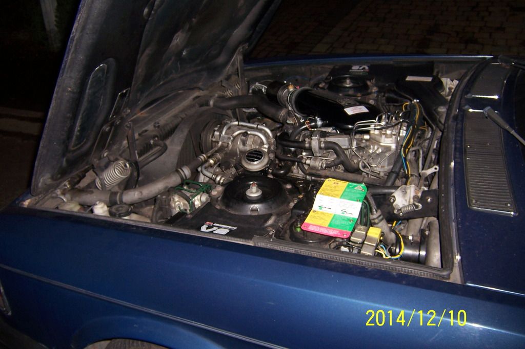

Lee (Bentley man) emailed me pics today.
Here they are...
Not the best angles in the pics but I reckon Impco system....

#13 Post by Gilbertd » Fri Dec 09, 2016 12:11 am
Is it Impco or a Blos carb? Mind you, I can't even see a vaporiser, it looks like that is tucked away down in the front somewhere.

#14 Post by LPGC » Fri Dec 09, 2016 10:06 am
Could be Gilbert. I assumed the reducer was the thing you can just about make out mounted front offside in the top pic, in the bottom pic the pipes to the mixer seem to run towards that. Some of the Impco mixers (with various adaptors) look similar to Blos and some Impco reducers look similar to the thing, well, from what we can make out from the bit of the thing we can see.
Edit - just had another look and it does look like a Blos mixer but reducer (if that's what thingy is) probably not an R90.
If this was converted in the UK then it's likely TinleyTech supplied the parts for this conversion and would be able to advise. I've fitted a few Impco systems but Impco has a wide range of adaptors etc that they will be far more familiar with, or will be able to help even if it were something like a Blos setup.

#15 Post by Tinleytech » Fri Dec 09, 2016 1:03 pm
That is a Blos mixer but fitted upside down, they recommend to fit with the gas input on top, can be angled either side but must be higher than horizontal. Not certain if this has direct effect on running (or is more for longevity by allowing release of contaminants) but definitely worth spinning it over first.
Adjustment is all on the mixer the small screw in the (what should be) bottom is the idle and the bigger one the main adjuster. Normally set the reducer with the smaller screw about half a turn out from lightly seated and the big screw about 3 turns out from lightly seated. The blos tends to slam the reducer fully open as soon as you get off idle (the slide in the mixer regulates gas flow) so no point in fiddling with the main adjuster on the reducer after initial setting.
Best to check CO pecentage if you can, about 1.5% on idle and 0.75% at 3000rpm is correct but not an exact science!
hope this helps.
