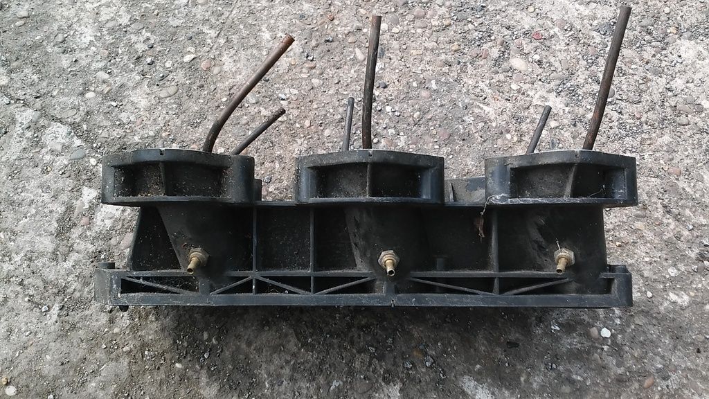

I've got an Explorer manifold here with spuds fitted, actually straws rather than spuds as I remember... I fitted the full system on the Explorer many years ago, when the vehicle was finally scrapped the owner removed the LPG system and sold it on. The buyer had me fit that LPG system on his different model vehicle, so the Explorer manifold and straws were surplus to requirements. I'll take a pic now but dunno when I'll get around to posting a link (all that faffing with photo bucket), so Dave might beat me to it.

Straws are basically small pipes that run inside the manifold from where the hole is drilled. Means you can get the gas exit point much closer to the head in situations like this.

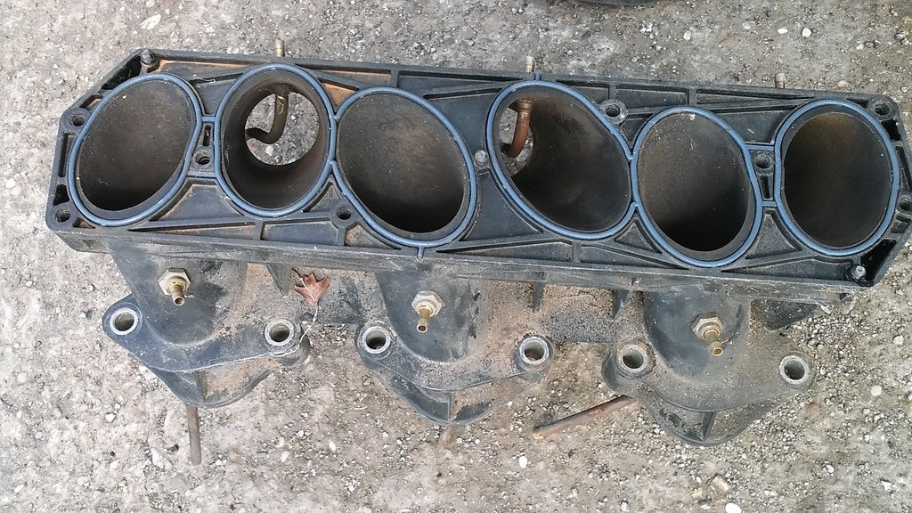

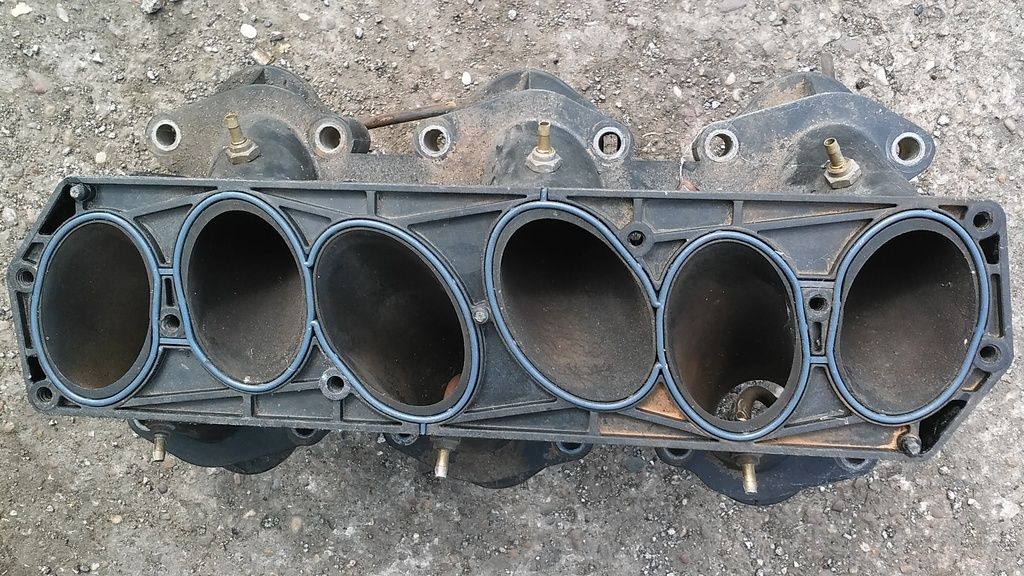

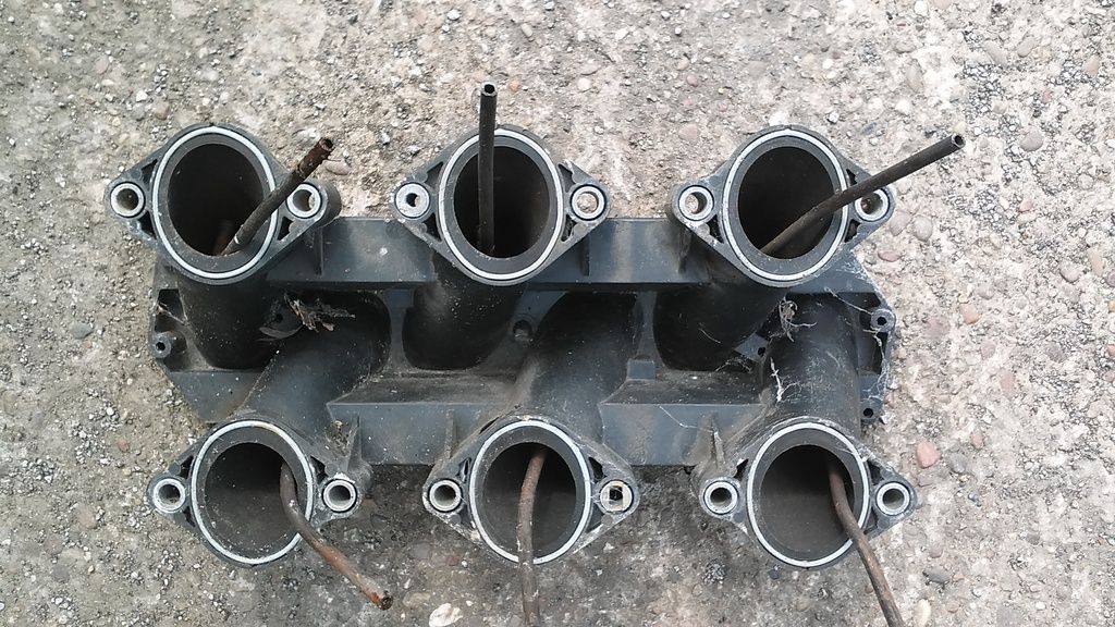

Pics of the Ford Explorer 4L upper manifold (mentioned above) that I have here with straws fitted:
I fitted this lot, oooh about 10 years ago first time around, and then refitted the rest of the system more recently.

Thanks for the pics, I'm assuming the petrol injectors are in the 'lower' manifold? I can see the need for straws in this case, but for the Bongo I reckon I can get the spuds in about 20mm above the petrol injectors which I assume would be close enough?
