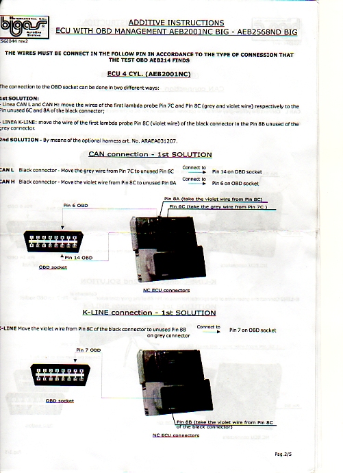

hi, i was wondering if any of you guys know which wire i need to connect to on my obd socket to keep the fuel trims in check??? i don't know which connection type my car uses, the car is a 2008 1.6 astra with the new from 2008 1.6 xer engine, the system is the bigas sgis-n up to 190hp system, in the paperwork it states that i should move the grey and voilet wires from black connector pin 7c and 8c respectively to pin 6c and 8a, thing is my car only uses the purple wire and the grey wire is un used, does that mean i only need to connect the purple wire to the new ecu pin??

you dont need to move any wires on the OBD connector, and the grey and purple wires are for the lambda connection. It should only have the purple one connected.

I think you are confusing yourself with the manual and what you actually have in the wiring loom mate.
It used to be the case that you need to move a couple of pins about, using the purple and grey wire as they where there and unused. However the aeb looms generally come with the obd wires i suppose its possible that you have an old loom. You should have a sheath with three wires in it. On a 4 cylinder there are two sheath's one with the can wires and one containing the green wire for k line.
So do you have 3 spare wires ? You should have a green, a green and yellow traced and a yellow with a trace. I cant actually remember what colour trace it is off the top of my head. Its all written on the wall in the workshop.
So k line, (green wire) connects to pin 7
The other 2 wires, green and yellow traced are for the can bus pin 6 and pin 14, they are opposite each other on the diagnostic socket.
Hopefully i have this the right way round ! Hopefully someone will correct me if im wrong !
The yellow to pin 6 and the green (both traced) to pin 14.
A 2008 car will be can bus and not k line i would say.

hi Tubbs, i may be wrong about this but i thought this was a fairly new function of the aeb ecu?? pls see the attached pics, this is the instruction booklet that came with the bigas kit, it is a seperate booklet to the main instructions, Thanks, Gary

Its not that new anymore mate. The system i fit has it all built in, so i am presuming its just a standard part of the loom now. Mind its been a good while since ive fitted bigas. I know the king has the wiring already there and emer for example.
Re: which wire for obd connection
It looks to me like the older loom didn't have the required wires in it so they used the lambda wires instead on the assumption that you don't actually NEED them to be connected to the lambda sensor. Presumably later looms have the additional wires in there.
Thats right they did, but i would have thought that bigas had changed over to the newer type, oval plugged aeb loom by now ? Maybe not.
Well the loom i got with my kit has the 8 pin rectangular type diagnostic plug, so what do you suggest guys, should i connect the front lambda to the ecu in the way shown?? Sorry bout all the questions but this is all new ta me, i'm learning all the time!!

It may take a bit longer but if I was installing it I'd add the additional wires from the ECU to the obd socket and leave the lambda wires connected.

Gary, sounds lie you need to shunt the pins over. You will need two wires for the can bus. Do you have two sets lambda wires ? one purple and one grey and one purple/grey with a trace. If you want to keep the front lambda to connect then use the post cat (traced) wires maybe ?

Hi Tubbs, yeah i have just connected the front lambda (violet/grey)to the ecu via the violet wire leavin the grey wire disconnected, the 2nd lambda (violet-black/grey-black)is not connected at all so will prob move these wires and use them to connect to the obd socket.
