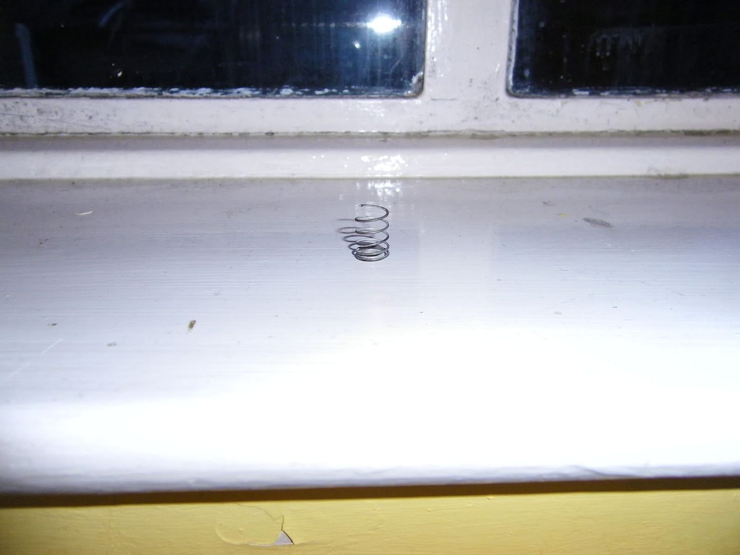

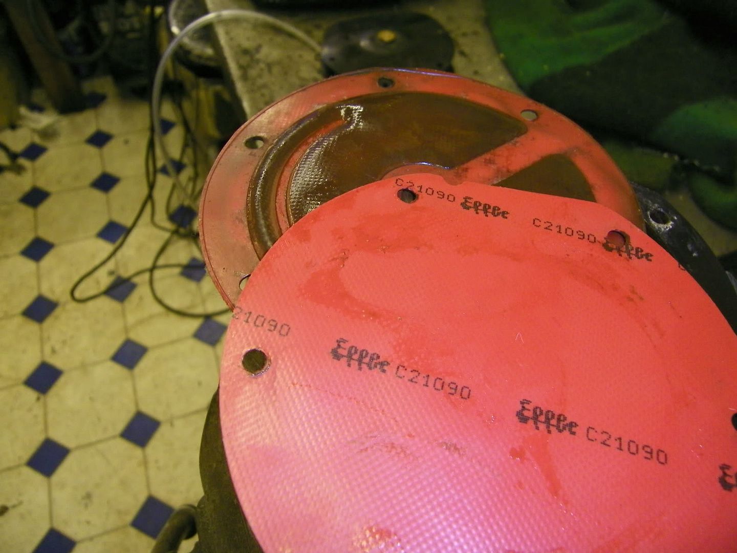

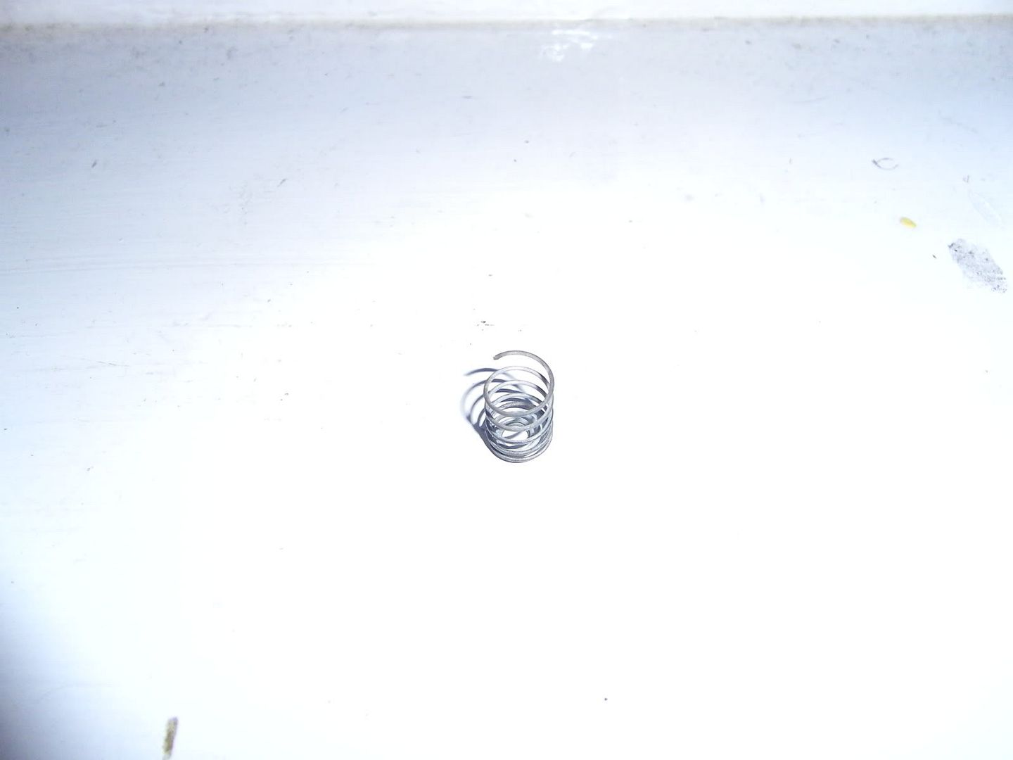

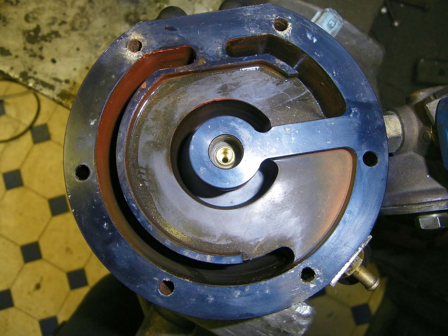

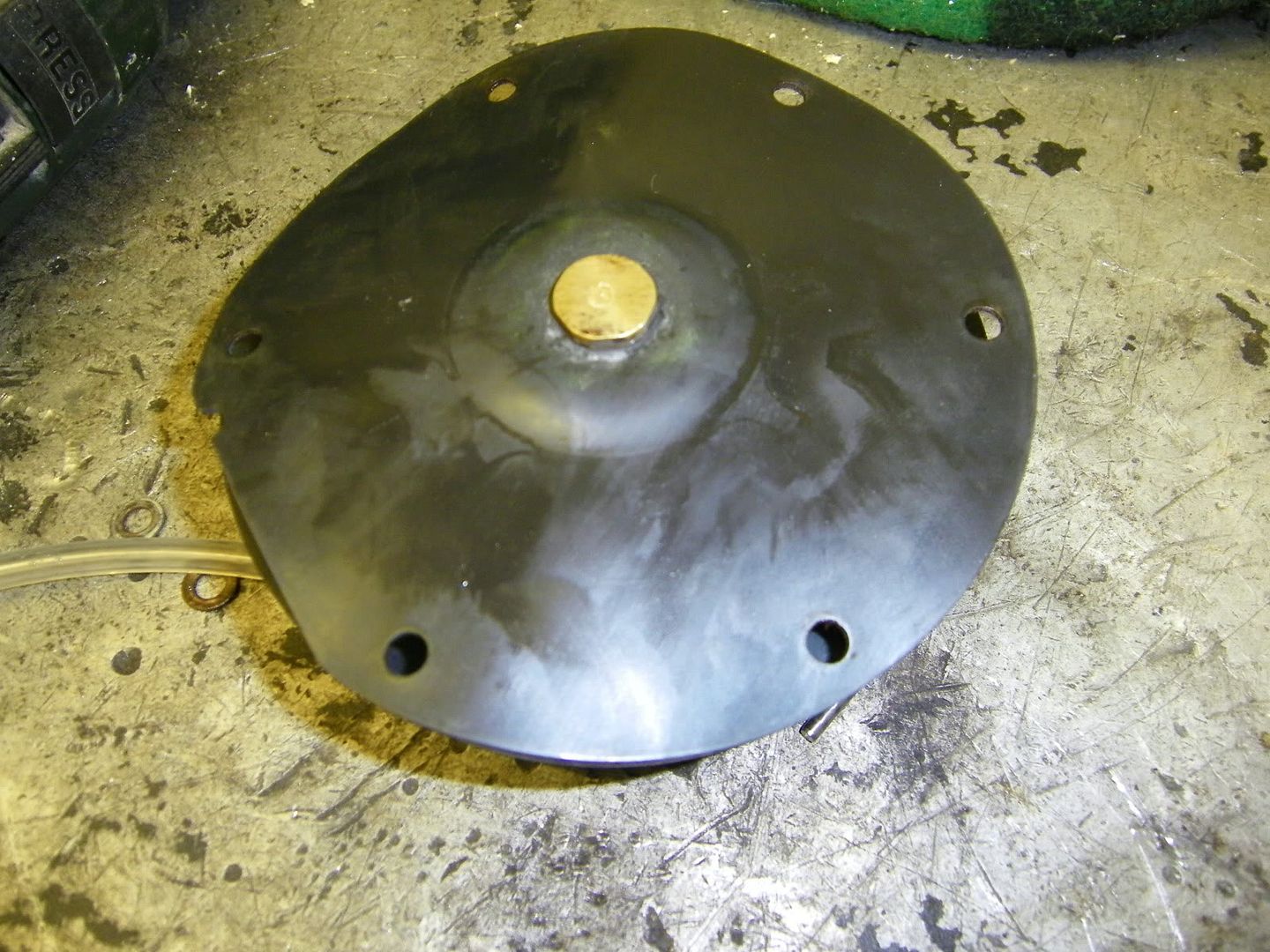

a few pics
no idea what the little green o ring is for ...there was nothing like it in the vsi reducer .
you can see the abrieviated spring end .... just look wrong to me ?

Little o-ring is for the tip of the pressure relief valve next to the gas outlet. The old o-ring will be really squashed into a cone.
The light spring does look wrong; but as said it doesnt need to do very much. Just stretch until 5 or 6mm pokes out the back of the body. Think I'd put the 'good' end against the piston.
No spring fault will cause gas-to-water leaks so you know there's more to it than that, that's something amiss with assembly or backplate. Textured orange gasket is good.
Did you seal in the new brass centre bush with loctite? Else that can seep and cause creeping overpressure. You might need to clean away old loctite from the flat seating area to get a good seal. You do need to be scrupulously clean about clearing any loctite debris away from the piston area.
