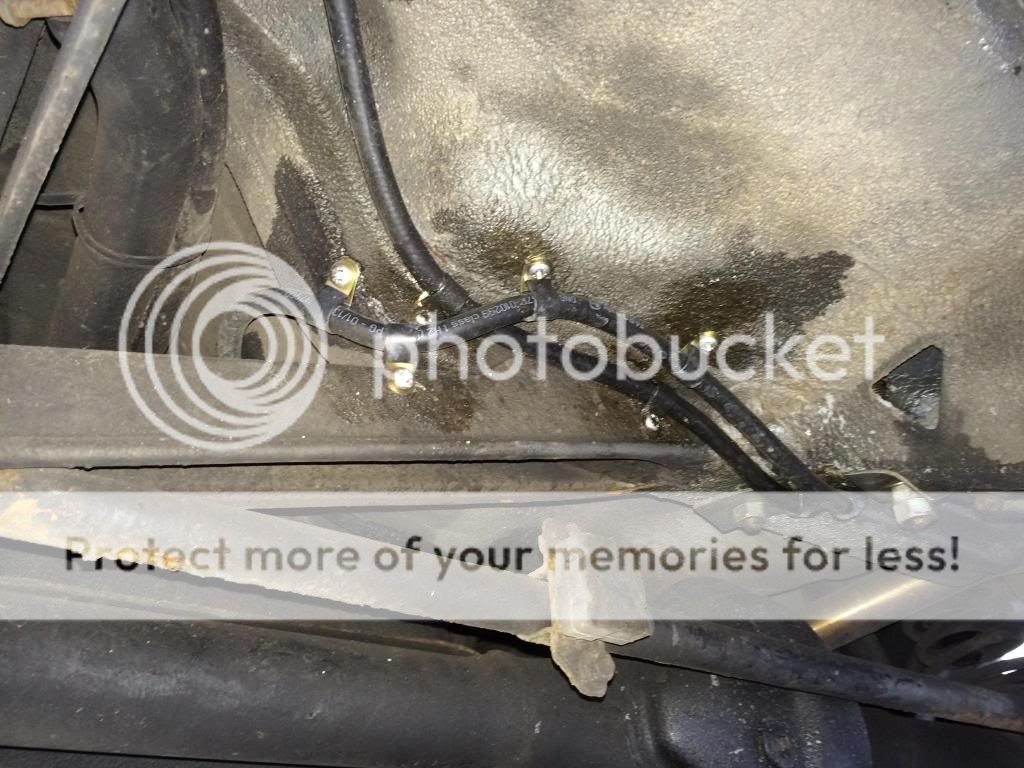

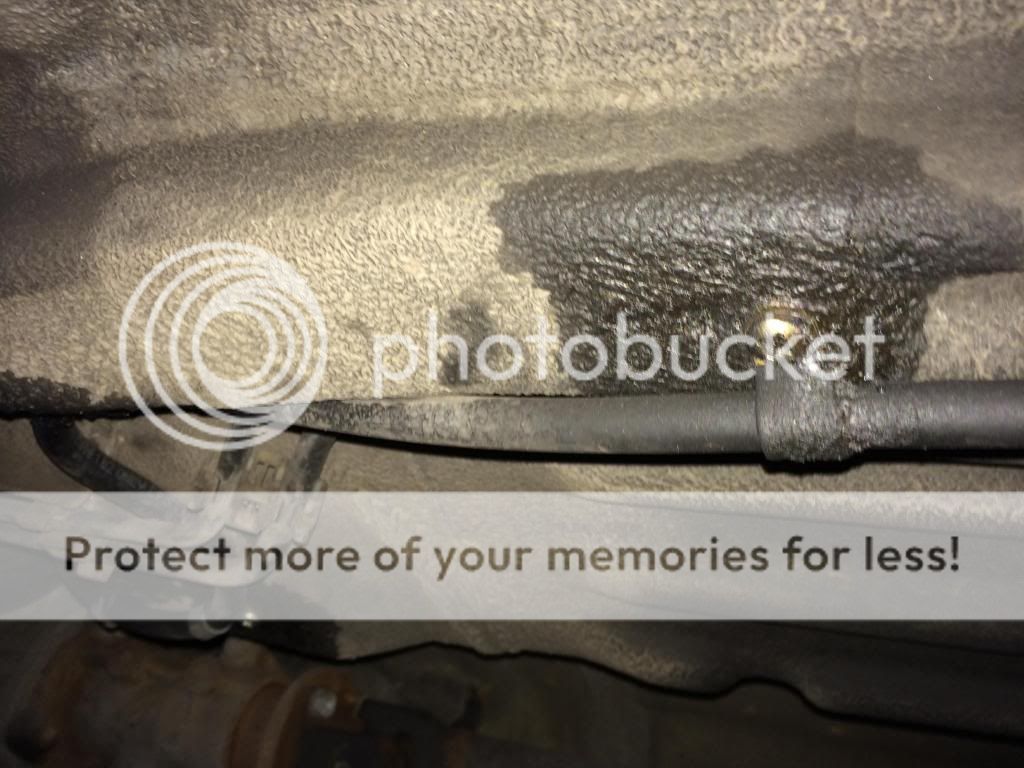

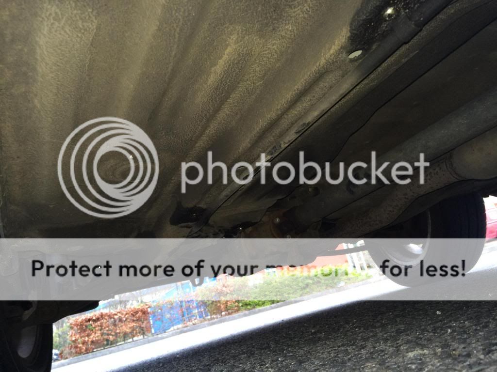

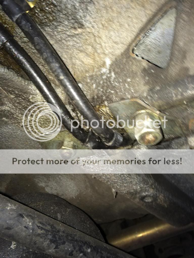

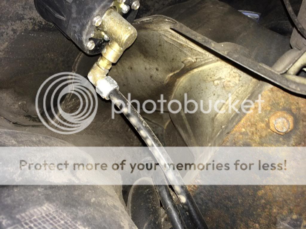

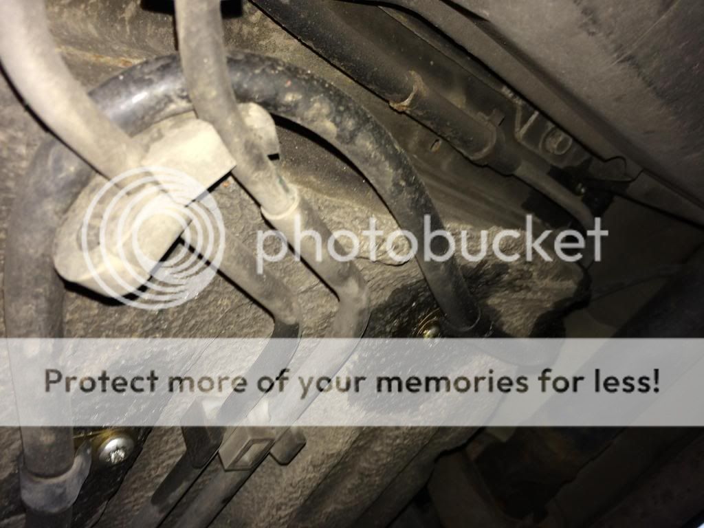

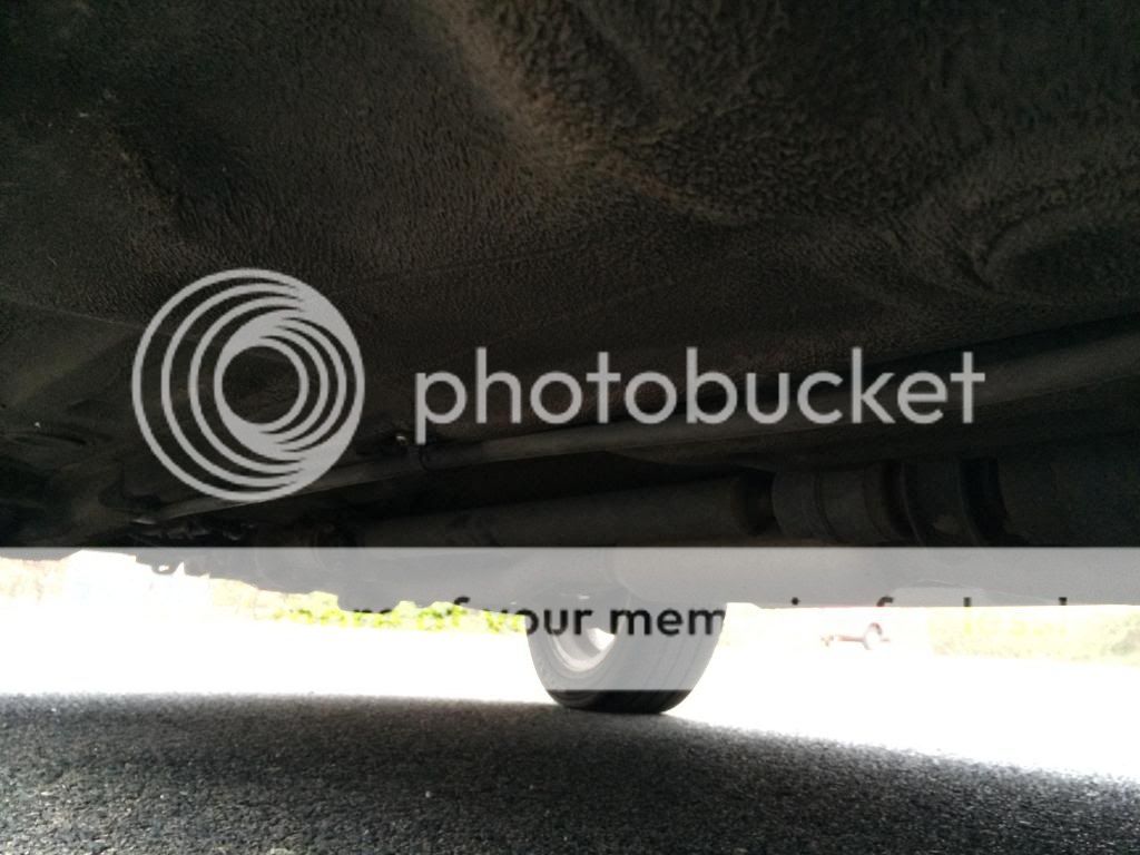

some pics of the underneath thought id ran the wiring but haven't.

#49 Post by lukie » Thu Mar 20, 2014 7:59 pm
what's wrong with all the pipe clips ? at every clip the car looks wet ? I see you haven't changed the filler yet with the double elbow's, both pipes coming out of the boot floor look tight still, have you checked the distance of the p clips on the feed pipe down to the front it look's a little long, last picture shows the gas pipe resting on brake pipes not good news...
what happened to the electric cables ?? surly it's easier to attach them all together and do the routing once sol feed, level gauge and feed pipe

#50 Post by luke123 » Sat Mar 22, 2014 9:04 am
Yeah distance is correct its under the max limit of distance.
It looks wet as i put grease around so the screws screw in with grease, the pipes the go around the fuel pipes arnt resting barely touching looks like that with pics, i was goin to leave filler as ive already routed pipe not sure if it says owt in cop, just time

#51 Post by lukie » Sun Mar 23, 2014 9:37 am
Never seen that before, surly when you come to protect the pipe clips and screws the paint / underseal won't stick properly?

#52 Post by luke123 » Sun Mar 23, 2014 6:25 pm
Can't say iv'e never not done it, did it when working with lpg monkey, As what happens if you need to renew the pipe a couple of years down the line, the screw snaps and then if you get some customers who like playing with their cars on a weekend and they say a snapped screw and a new hole drilled they will probably complain, not worth not putting anything on, not for the extra time it takes.
Was going to use wax-oil or stone chip or schultz whatever takes my fancy when im doing the car again probably be wax-oil.

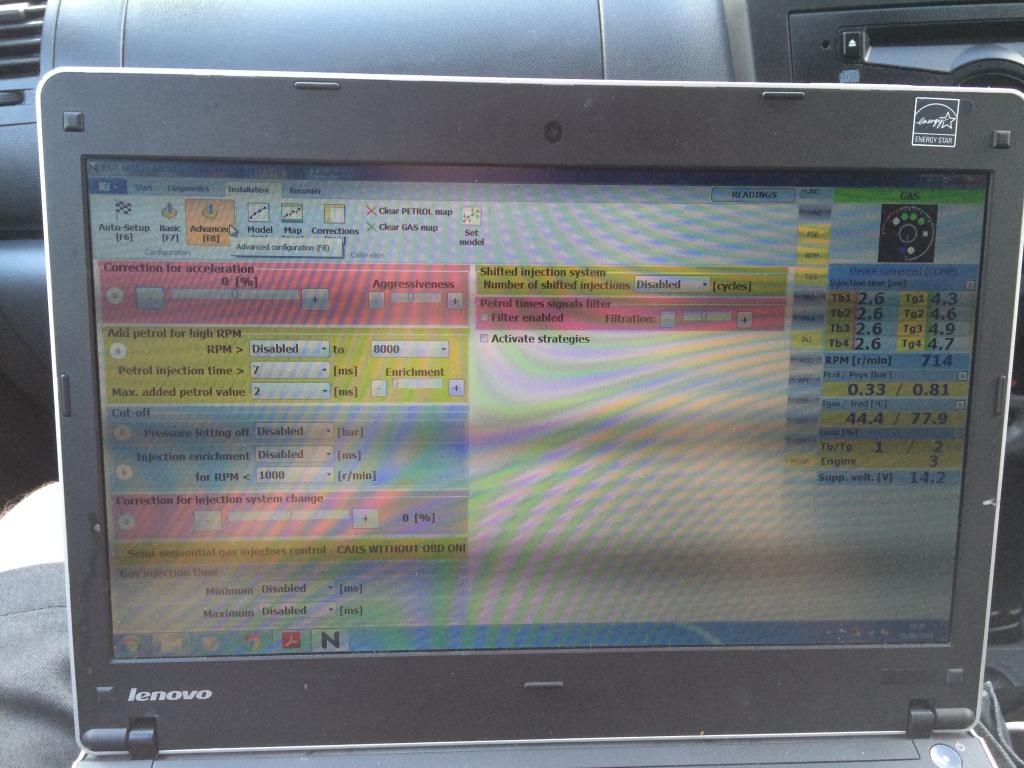

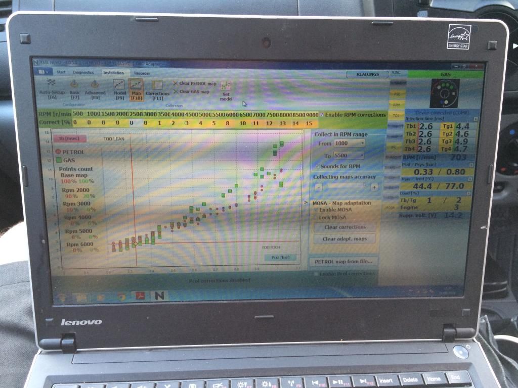

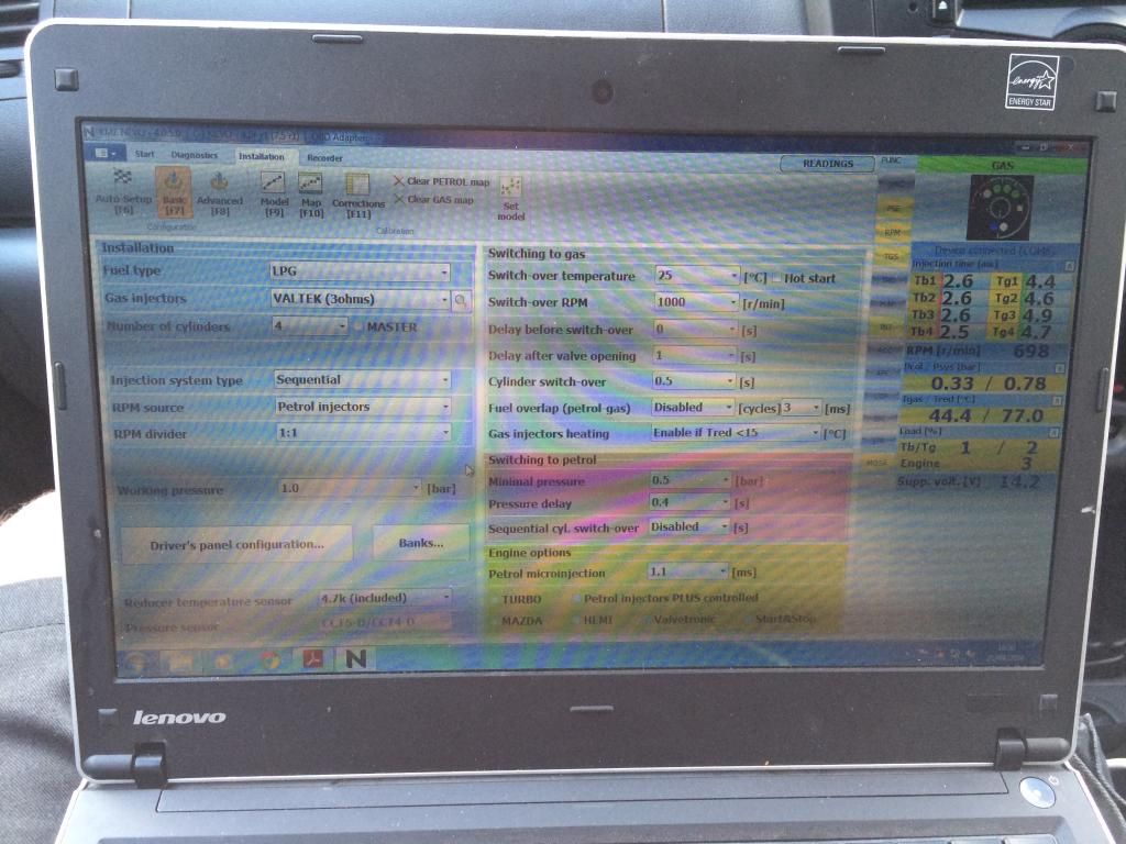

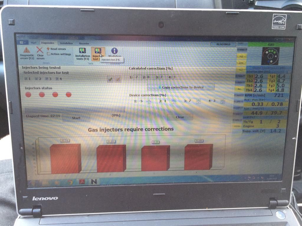

#60 Post by luke123 » Sun Sep 21, 2014 6:58 pm
So iv'e sorted the odds and ends with the wiring etc.
Iv'e done an autocalibration then vehicle was driven on petrol to give me the values for the map then driven on gas to give me a base line map, then i whent on the fine tuning side where it will collect at a lower rpm range to give more values accross the map. Then whent in the gas injector section and tested them and added the correction advised by the software on the map etc.
vehicle was driven but gas pressure drops of, I.E put your foot on the accelerator gas pressure goes to 1.0-1.5 fluctuations but at normal driving goes to 0.8 on gas pressure then as soon as you take your foot of accelerator or set of to fast or change gear the gas nocks it's self of? some pics below of the vehicle running at idle, i have been playing about with the gas pressure in the software to see if that made any differance but nothing.
cheers Luke
