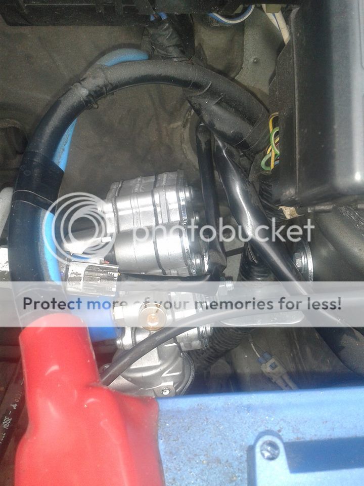

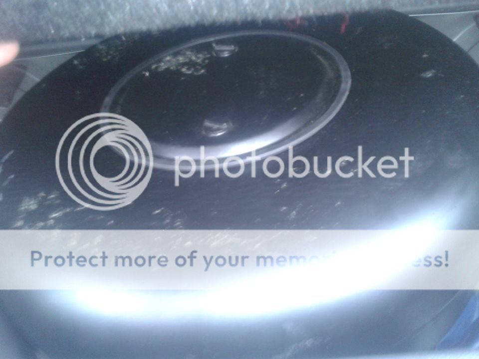

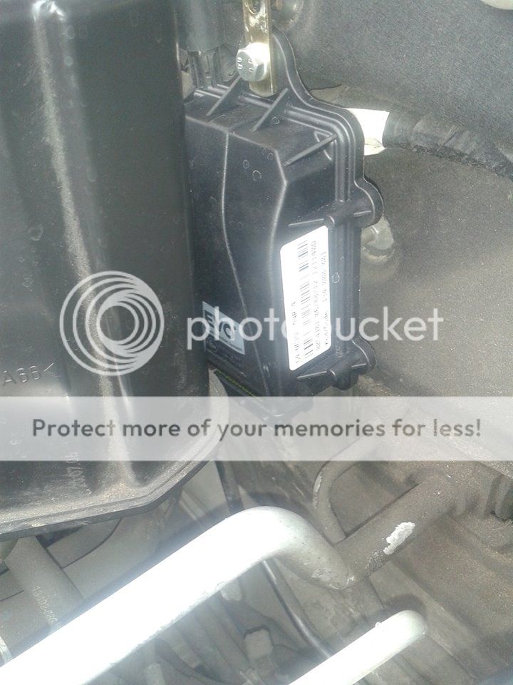

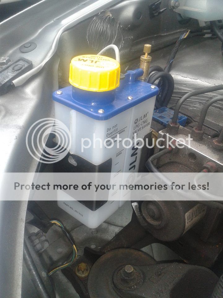

Suzuki ignis 4 grip 1.5vvti
Kme nevo 4cylinder kit, GZWM 35litre tank, jlm valve saver and fuel catalyst installed.
The filler and Lpg rail with filter is fitted but no pics as of yet :)
