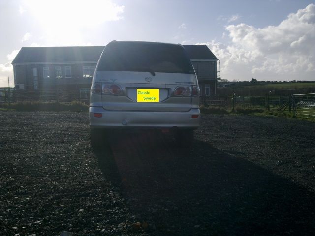

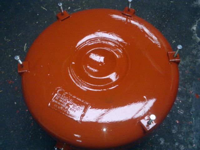

Not a car you convert or even see everyday so I thought I would share this one with everyone. Some of the photos did not save on my camera but most have come out ok. Not the first Hybrid through the classicswede workshops but the first of this type.

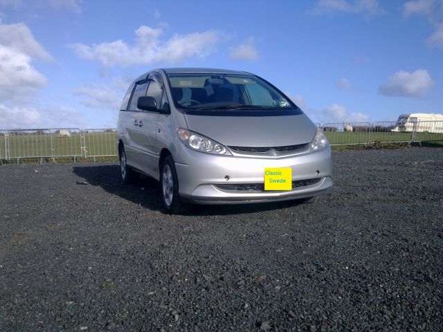

Front veiw
Hybrid

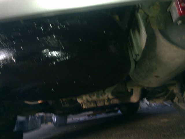

Tank primed and then undersealed

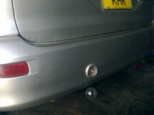

Colour coded filler rear mounted

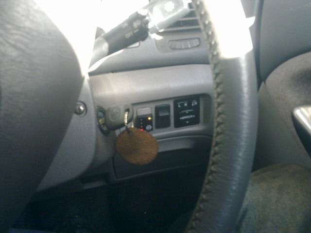

Change over switch mounted in spare switch blank

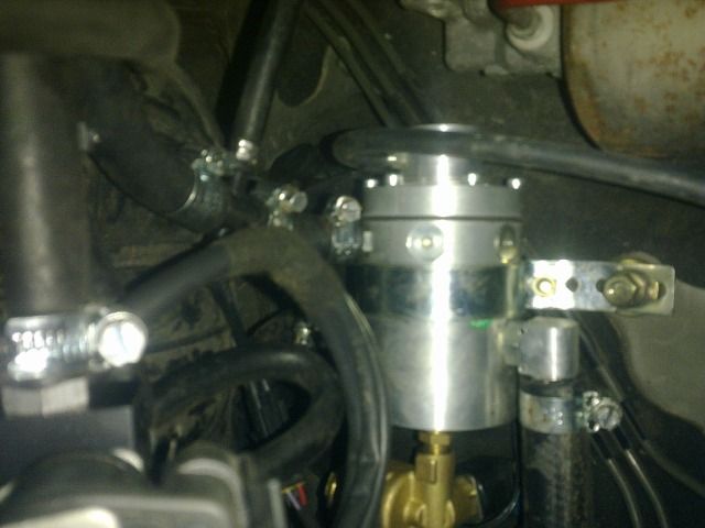

Vapouriser mounted behind the engine (no space in any other place)

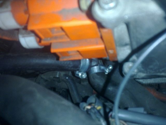

Very little room for water hose connnection

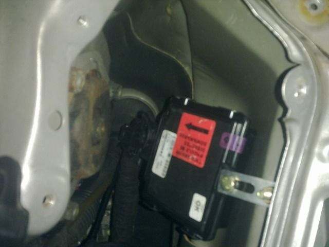

ECU mounted under front scuttle

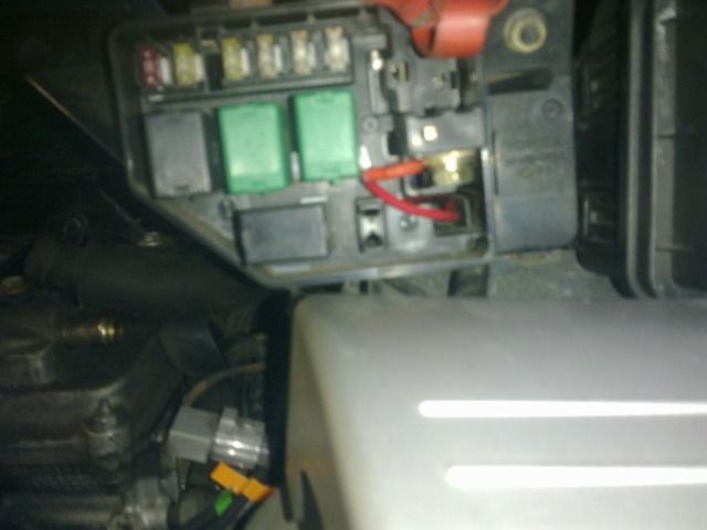

Power taken from main 12 volt connection

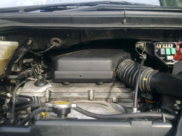

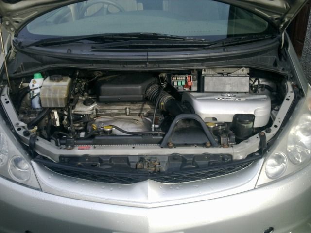

Engine bay after refitting scuttle and air filter assembly

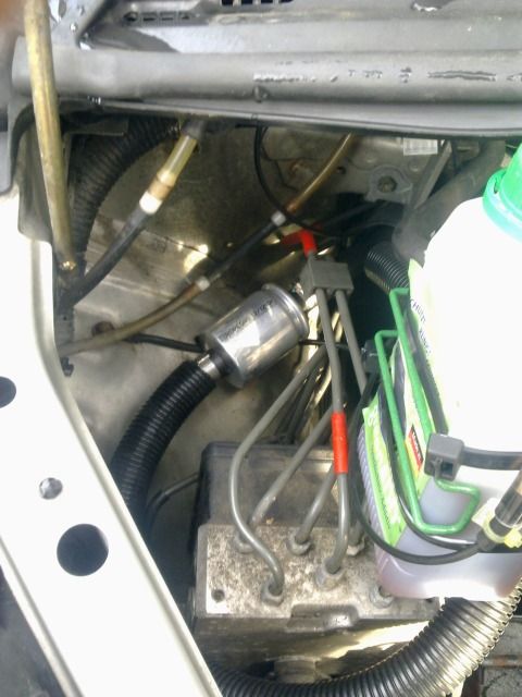

LPG filter moved forward for ease of maintenance

Nice, what make of kit is that?
classicswede
Posts: 2583
Joined: Fri Oct 21, 2005 8:56 pm
Re: Toyota Estima Hybrid conversion! (Previa)
#3 Post by classicswede » Fri Feb 15, 2013 8:05 pm
You can just about make out on the ECU it is a Europegas SAS system.
