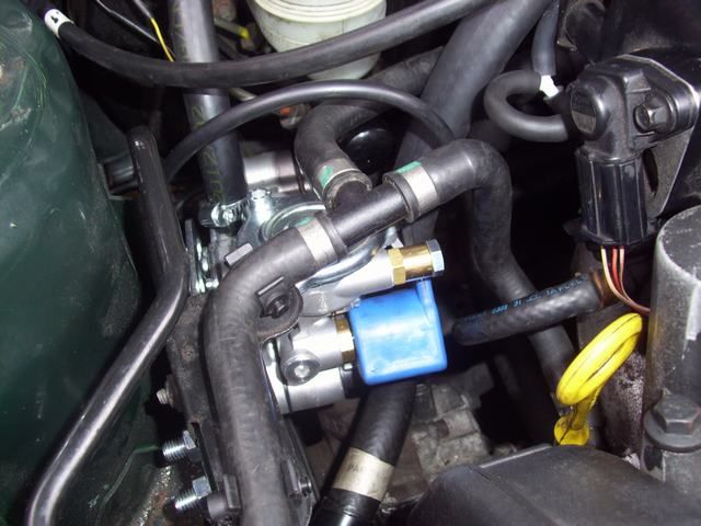

Next was to fit the vaporiser, this changes the LPG from a liquid into a gas using the heat of the engine's coolant system:
It's plumbed into the coolant pipes just before the cabin heater control:
Vapouriser mounted on the o/s inner wing and plumbed in. Space is at a premium in the Rover 200 engine bay when it's got every available extra!

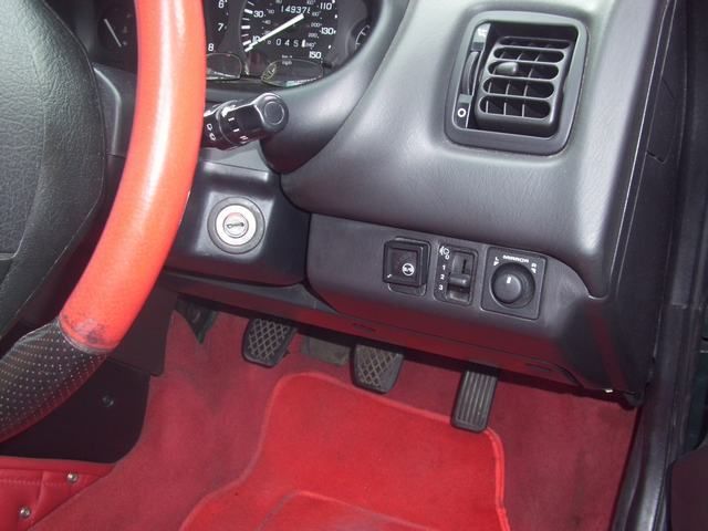

Briefly turned my attention to the interior to mount the switch with built in tank level gauge:

Who told you that? Across the airflow i.e. 90 degrees, is good for mixing. We're not injecting the fuel in liquid form, so need not slavishly follow the original injection strategy. In practice anywhere between 90 and 45 usually works, and yes pointing 'downstream' if anywhere.
