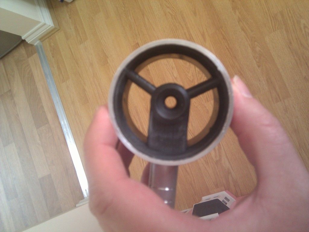

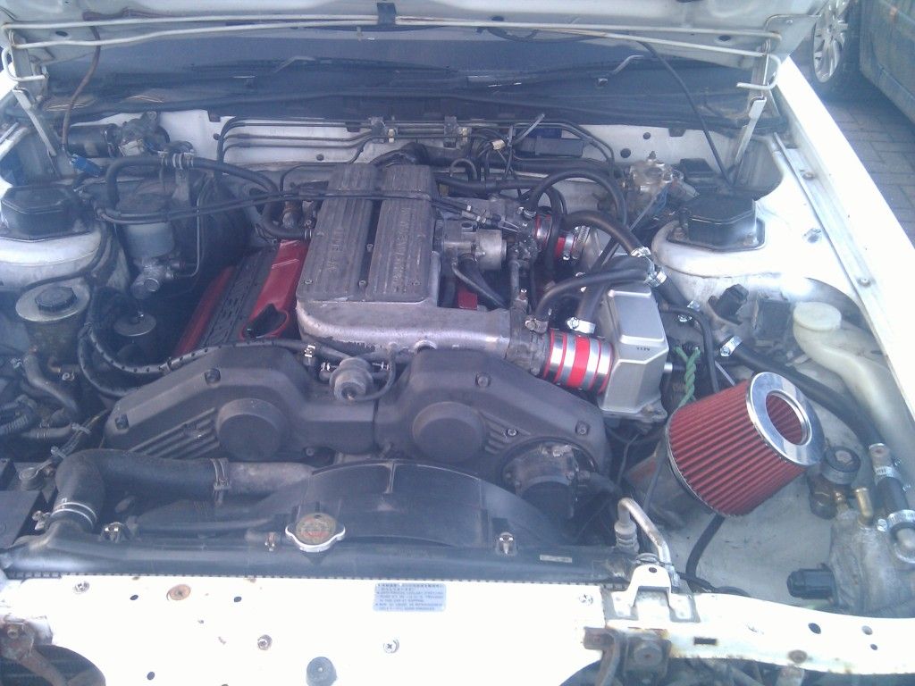

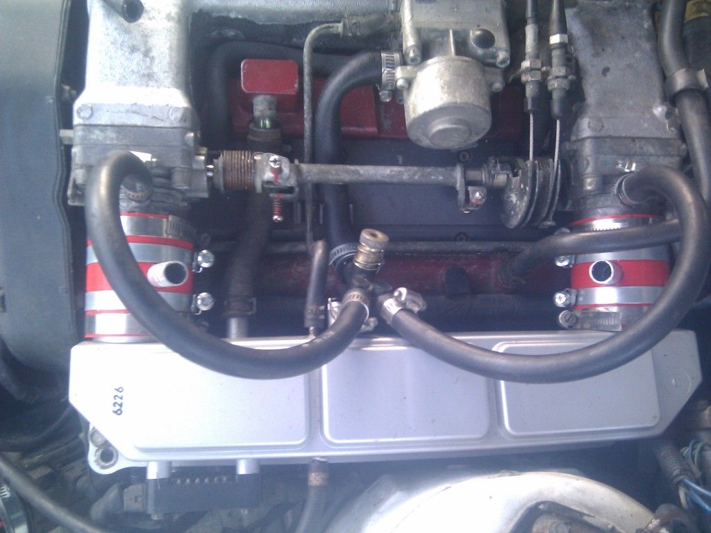

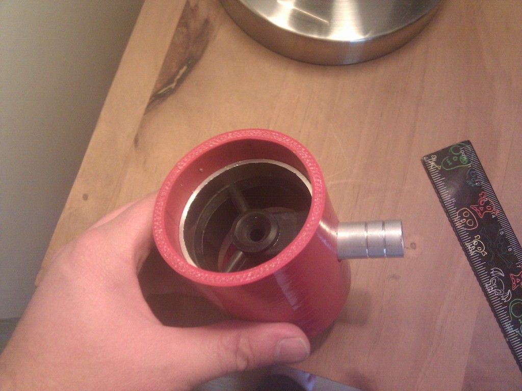

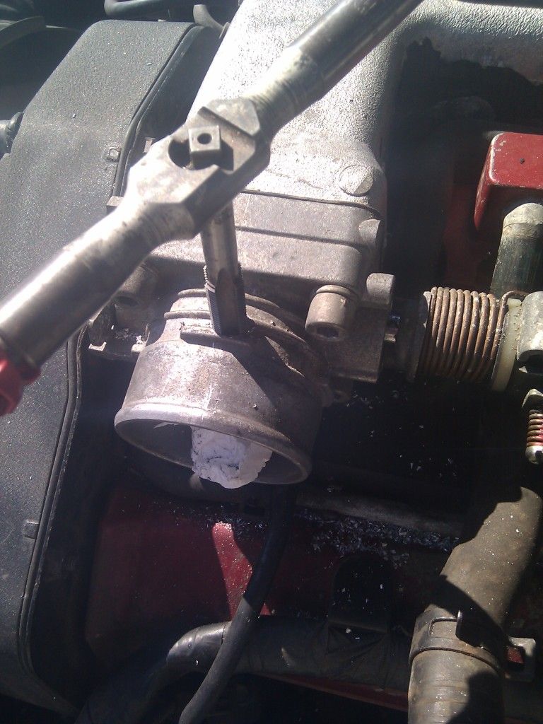

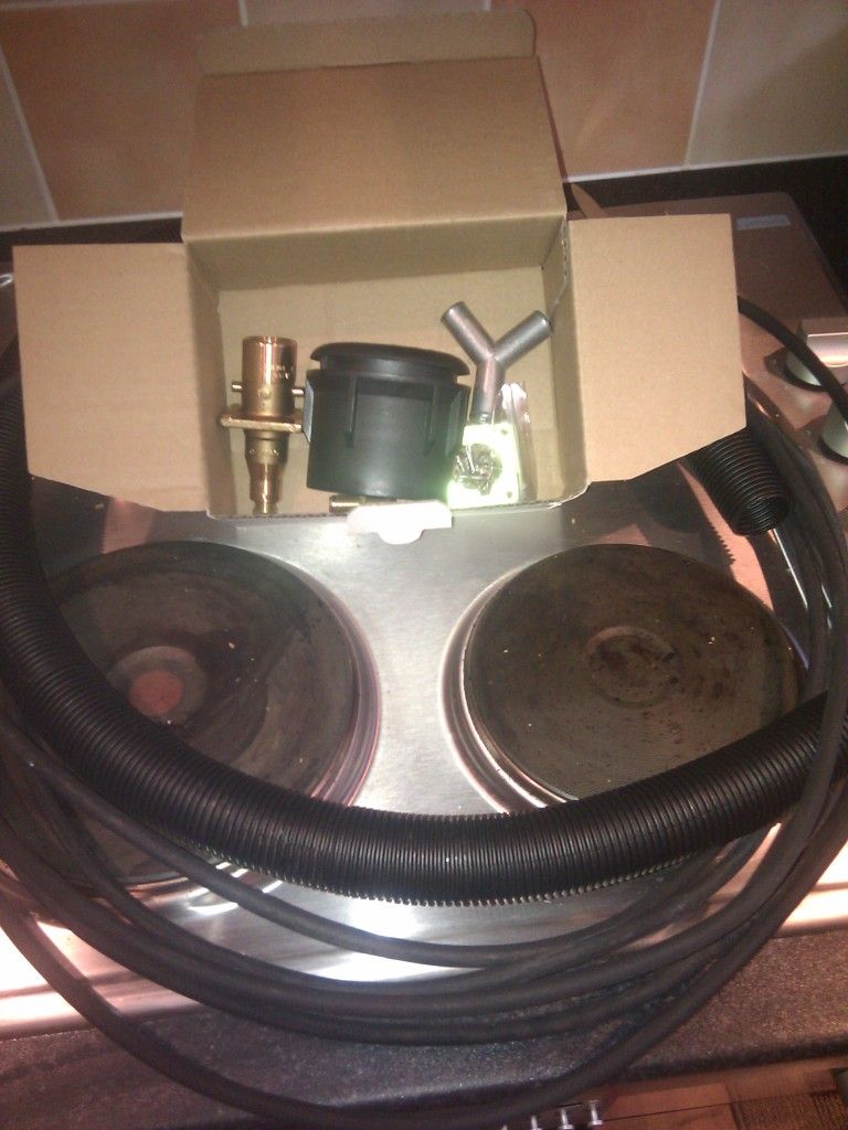

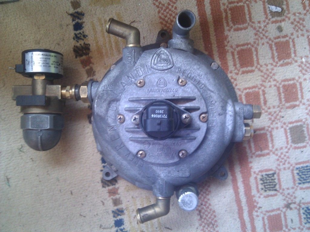

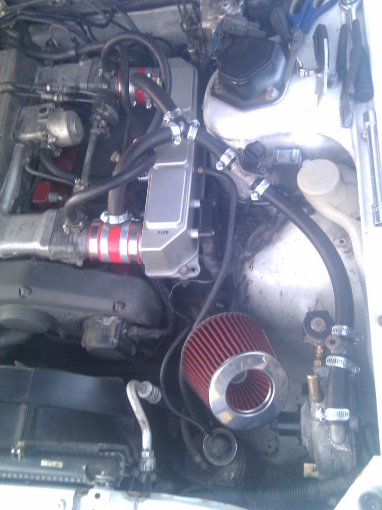

ok so after lots of planning and waiting for parts and doing so somes ive started work . its slow going and am still using the car at the same time .. but a picture paints a 1000 words so here we go ... any help and advice would be great as i like the car dont really want to blow it up ...
new parts :-)
mixers from poland hope they workImage
emulator took me over a day to get them on not fun
mixer ready to fit
hole for the idle in the throttle body
idle sorted (i hope)
vapor hose all plumbed in to the stepper motor
engine picture
it all needs tweaking and im not to happy with it but its getting there slowly next step water hoses and gas line
any help would be great ..

is the landi kit second hand if so did you check it worked before you got it ,only asking as the majority of these i have seen have had big problems .but looking neat so far..........

It is second had and I have not checked it so fingers crossed it will be OK
How would I go about checking it?
Posts: 8036
Re: retro 1985 nissan leopard install (build thread)
#4 Post by Gilbertd » Wed Jun 20, 2012 11:30 pm
See it running on the original car before it was taken off?
Why have you fitted a stepper actuator AND a manual power valve? You only need one or the other, a stepper for closed loop or a power valve for open loop.

retrosii wrote:It is second had and I have not checked it so fingers crossed it will be OK
don't think you can check it off the car you'l just have to suck it and see (pardon the pun ).have you got the lead and software ?if not I wouldn't spend to much time on it, bin the reg and get a R90e and possibly a bingo 6 or a LEO ,or even just the power valve, the good thing about the bingo 6 is that it has built in emulators but possibly the wrong plugs for your jap? it's been a while since I've fitted one ,also you may need to reduce the hole at the mixers just an observation ....good luck........

Not really sure why I put the manual power valve on as well it was just there so thought I would chuck it on as well might take it off as I said its just on basicly at the minute it needs tweaking. I have all the software and cables so I'm going to stick with this kit as I think I know what I'm doing with it and its old school like the car . Mixers are stream mixers I have never seen them used but I'm willing to give them a go as it help keep some of the performance when running petrol.

OK I have revised the idle because I was not happy with it how it was. Its a lot neater not.
