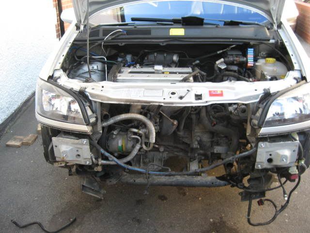

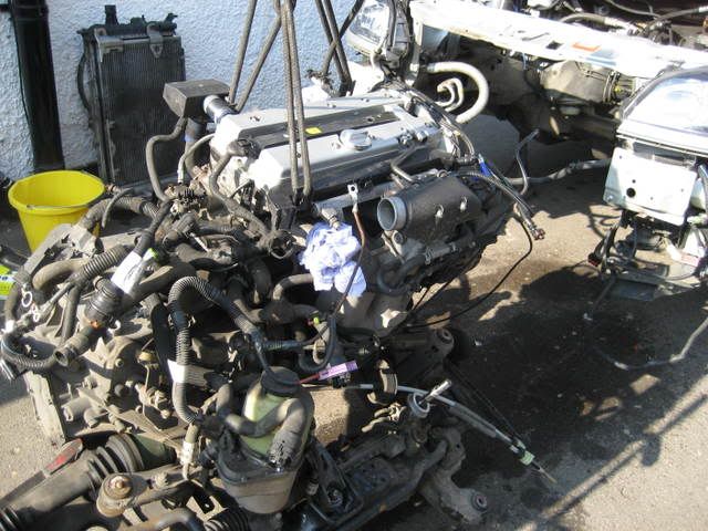

well I am one of them people that like to play with cars
and engines making them go faster ect ect :shock:
after a few beer's I got my tools out 8)
2 hours latter in the workshop
then :P

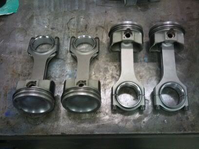

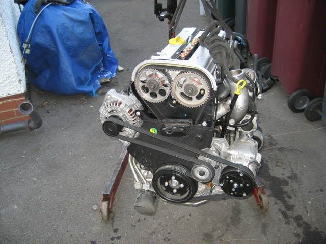

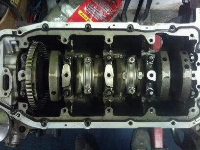

pistons an rods arrow rods

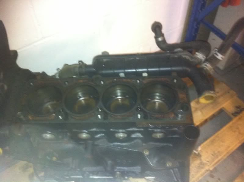

crank back from frozensolid
Block was also done
all build up with a new gearbox and atb diff fitted

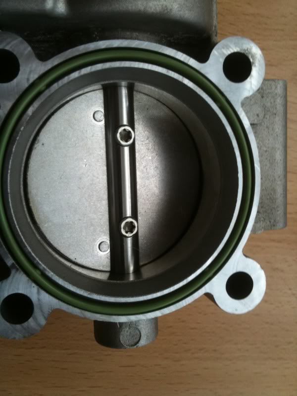

started making it flow more air std
one been made bigger

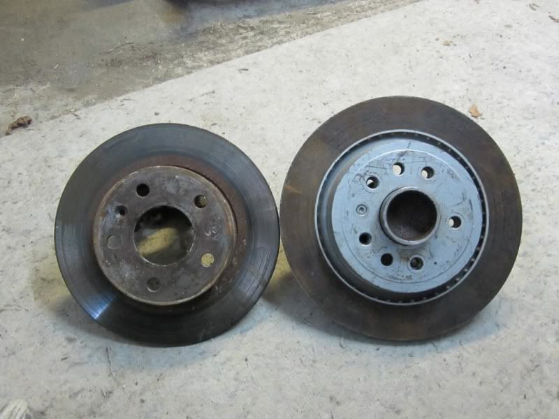

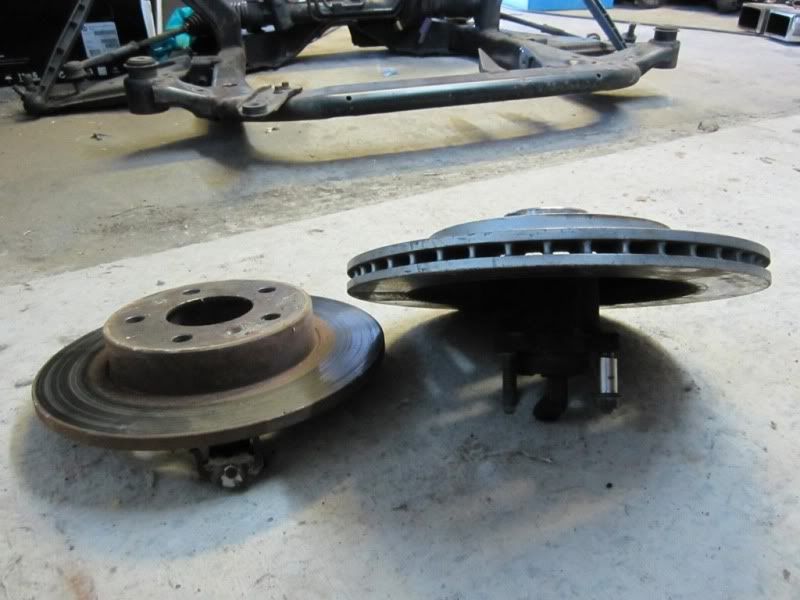

now speed sorted out lets make it slow down faster

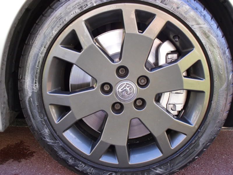

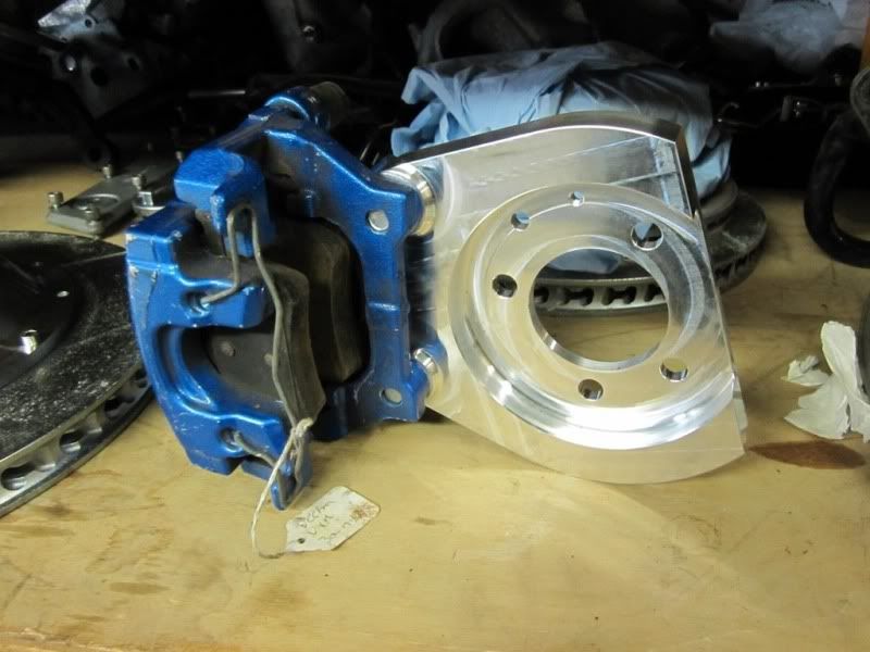

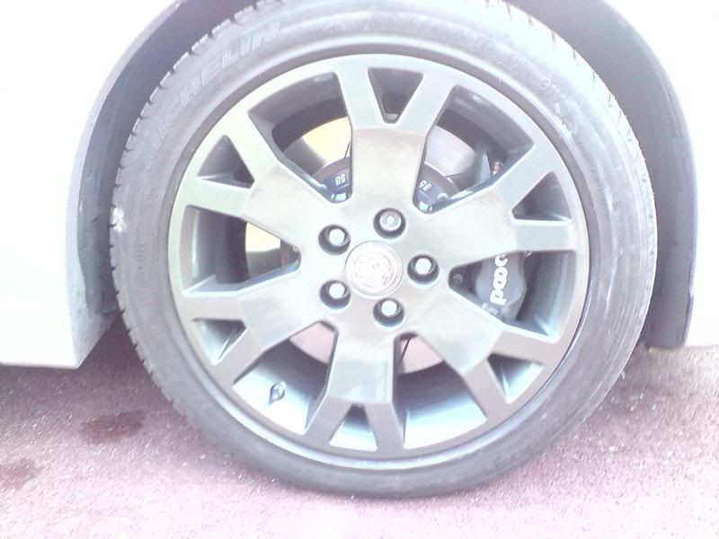

330mm x32mm with 4 pot's
then I found I could fit a 345mm x30mm kit under 17's so this is just as good for fast road use
as my Alcon 6 pot 343mm kit and less then 50% of the cost

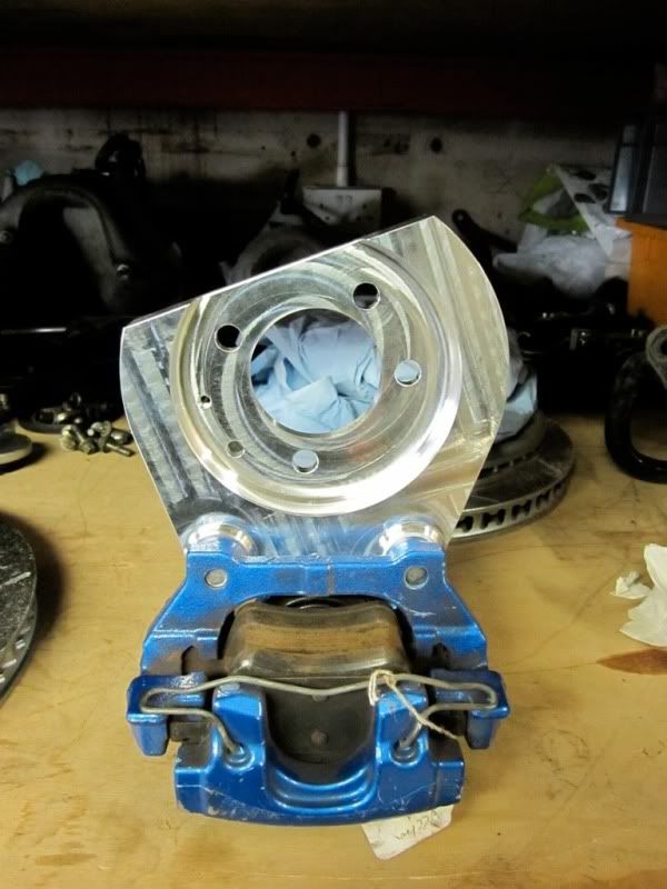

rears have also been changed to vented rears at 292mm with custom made plates
a bit of cnc work sorted
new vs old

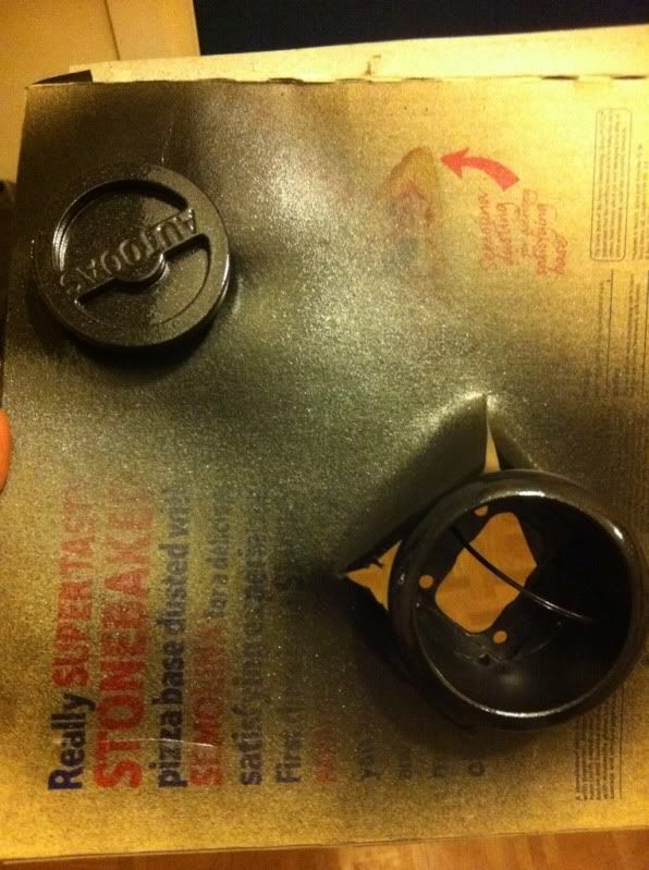

next stage is to fit a LPG kit to the car
started by painting the filler cap
