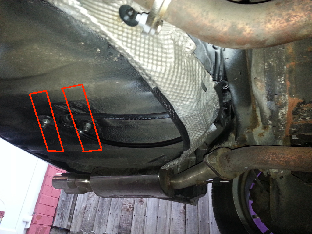

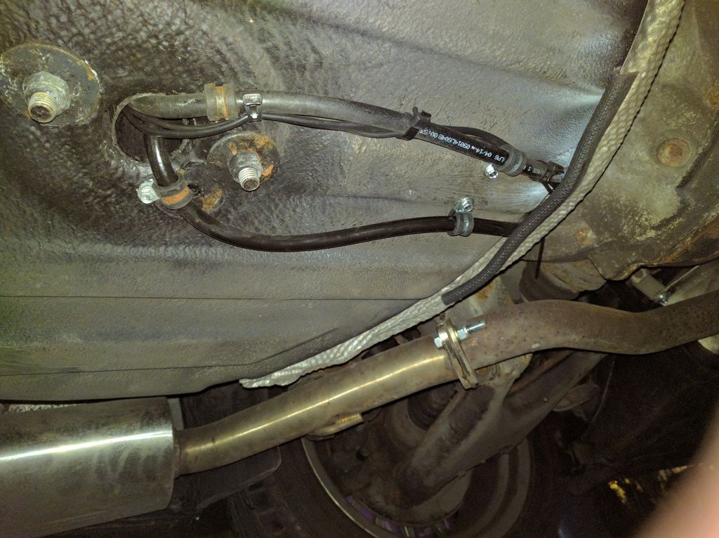

Minor update after a week or so's running:
2x mopre clips under wheel well for fill/outlet lines. Was paranoid about damaging the tank - so tapped through with a tiny drill bit, used it as a depth gauge and then cut the heads of my p-clip bolts to make sure they wouldn't interfere with the tank:

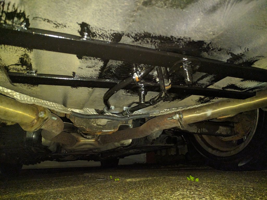

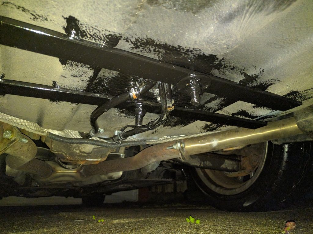

Got time to install the tank spreaders over the weekend:
and:
it's 35mm x6mm flat steel bar and both plates extend more or less the full base of the wheel well. What do we think?
and:
Re: 1998 BMW 740i - DIY Conversion using Prins VSI 2.0
That'll do it! My concerns were that the long lengths of bar would become proud of the wheel well especially towards the ends as you tightened the bolts up, thus my suggestion of using shorter bars and welding cross bars to them (above them), but seems that hasn't been a problem. Not really an issue but I'd generally cut the bolts down a bit depending on how far they stick down.

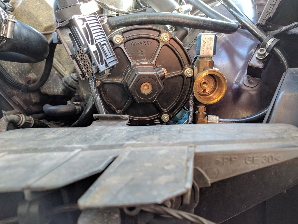

Just a quick report after around 500 miles and a good few tanks of gas and just under 600 odd miles of running.
I had a coolant leak from the rear coolant hoses that feed the reducer. I had used T peices that were of too small a diameter - and the clamping force on the jubilee cip must have been too high in order to achieve a seal and the hoses split around the clips. I've replaced the hoses and used a wider diameter T piece with a different design of jubilee clip and all is well.

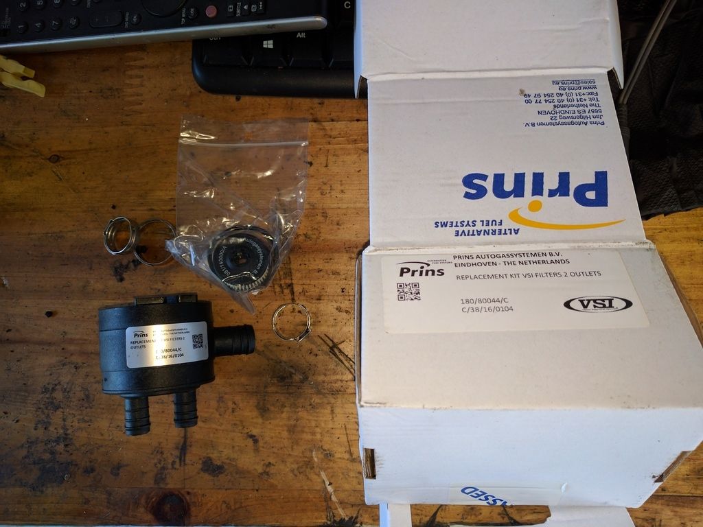

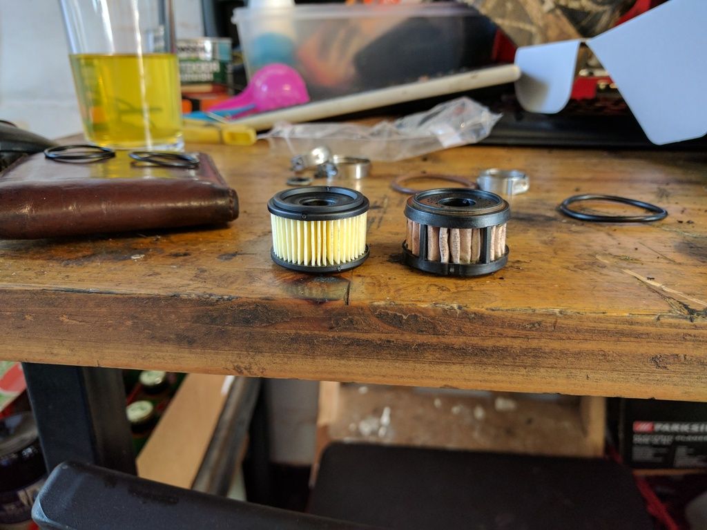

Also serviced the liquid and gas phase filters - quite easy acccess if you pop the front headlight:
Slightly different design of liquid phase filter (old one on the right):
Prins service kit includes both the gas and liquid phase filters and replacement o-rings:
An afternoon well spent. The click/clack of the injectors is less audible now the filters have been changed.
