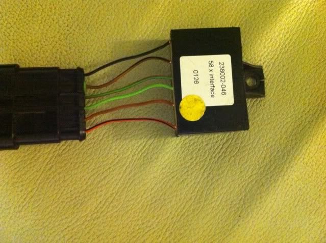

Just a quick one. Does anyone know if a 12201599 DFRC K9 Is the same as a 58x 238002_046 (93182211) Please.

I saw a picture of an Ecu on E bay with a thing that looked like a 58x on it and there were a few numbers on it.

#26 Post by pjpj » Wed Feb 23, 2011 6:32 pm
Yep, you can see the label with CCF002 on there.

#27 Post by raeturbo » Wed Feb 23, 2011 7:11 pm
So it will do as a 58x then? as it does not look like mine.

#28 Post by pjpj » Wed Feb 23, 2011 7:43 pm
Ah yes, you have the EGI system.
I'm not 100% sure about that.
I have checked the wire colours and they are identical.
And code 12 stored in the LPG ECU for an EGI system is the crankshaft signal amplifier that has failed.

#30 Post by pjpj » Thu Feb 24, 2011 1:53 am
Nope, sorry, my mistake, I looked back at your previous posts to see which system you had and read your first reply which said EGI. I didn't read your correction a couple of posts later.
You do have the GSI if you have the electronic injectors.
The signal amp. in that picture should be fine so long as it's a worker.
Code 12 for you does mean ready to supply codes.

Ok thanks for your help. will look for a CSA.
