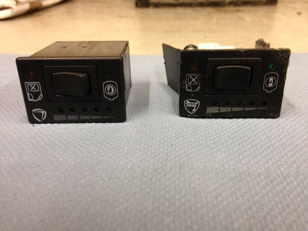

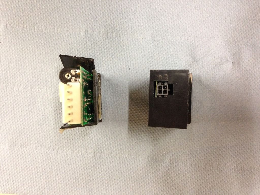

my LPG changeover switch failed recently, leaving my motorhome stranded. I have removed it as a temporary measure so now running on petrol alone.
I have purchased a new switch after some searching but to my disappointment the connector on the rear is different. I don't have a wiring diagram for my system or the new switch so I am hoping someone can help me with the connections. I have Googled for hours but not found what I need.
The switch is a Landi Renzo LCS A1 V05 and i have tried to attached pics which show the old (6 pin) and new (4 pin) connectors. However, I got this message - "the board attachment quota has been reached". I can post photos if that gets sorted out.
The switch looks like this - http://www.agsiedlik.pl/en/centralka-la ... i1613.html
It turns out that the switch functions are different, despite them having the same LR part number (!) - the old one has an intermediate position and the new has just two - petrol or gas.
Any help would be appreciated.

#6 Post by LPGC » Fri May 05, 2017 10:42 am
As Gilbert said.
The switch on the left is a stand-alone controller and has all the electronics to switch the LPG on and off, petrol on and off, cut off all fuel when the engine stops turning, etc. The switch on the right is just a dumb switch that can only be used in conjunction with a separate ECU controller... they're not interchangeable. The switch Gilbert linked to will be interchangeable with the switch on the left but will need to check pinout, would only involve swapping a few wires around in the loom to the rear of the switch at most. If you tell us the wiring colours on the plug at the back of your switch we'll be able to say which wires need to be swapped around if any.
