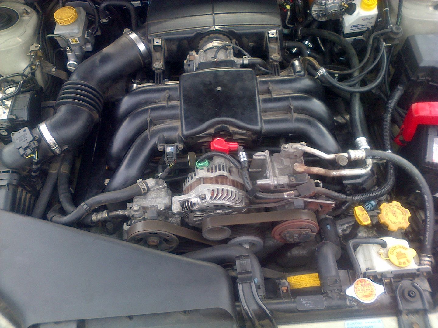

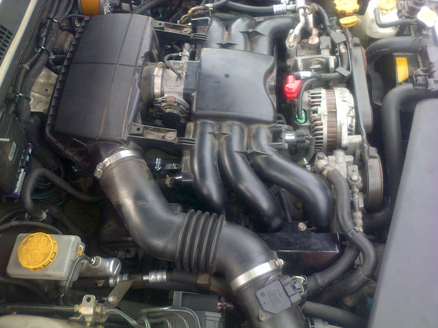

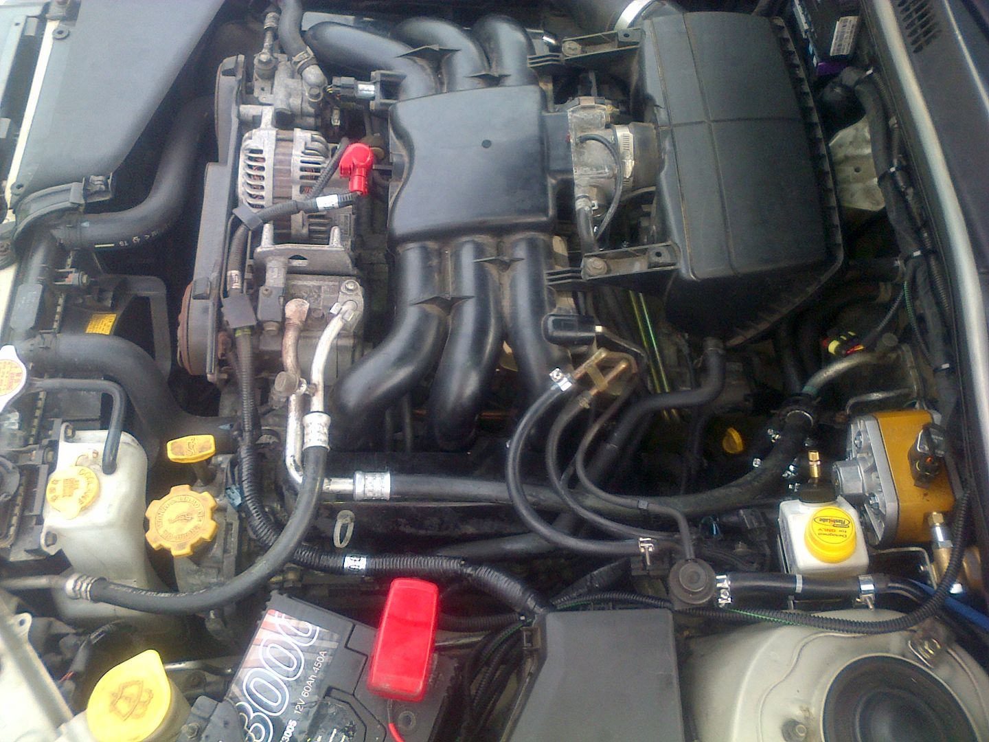

#16 Post by LPGC » Mon Nov 30, 2015 7:33 pm
Just been asked on phone to post these pics of a Subaru H6 (in Subaru Outback) I converted in May. I should start taking more pics..
Injector pipes are all under 1inch long, LPG injectors are beside petrol injectors, actually underneath petrol injector covers.
80+ Irene tank was a tight fit but boot floor remains flat, no pics here of tank end or switch, just the engine.
6 Cylinder KME Nevo ECU, KME Gold reducer, MJ singular injectors, Flashlube. Interior changeover switch auto-dims when it's dark so LED's are not blinding, all programmable to vehicle owner's requirements etc of course. Components fitted are well on top of the job and would be equally well suited to an H6 with turbos etc. Owner reports indistinguishable running on LPG compared to running on petrol, exactly same engine smoothness even with quick changeover to LPG on cold mornings... Yes, I should think so too!
With covers on...
Without covers on...
