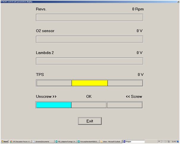

Just checking out the software. Seems a bit basic...
Anyone know what the parameter at the bottom is? The one labelled 'unscrew/screw'
 Post subject: Re: Etagas software
PostPosted: Mon Nov 21, 2016 1:33 pm
Posts: 3177
It refers to pressure (unscrew / screw in pressure adjustment on reducer). Etagas doesn't have a built in pressure sensor but during setup you're supposed to connect an Etagas specific pressure sensor. I have the Etagas pressure sensor (pic below, bit of an LPG relic these days!) but have never had need to use it as I can read between the lines to set pressure correctly anyway. Without the sensor connected the screw/unscrew reading should be ignored.

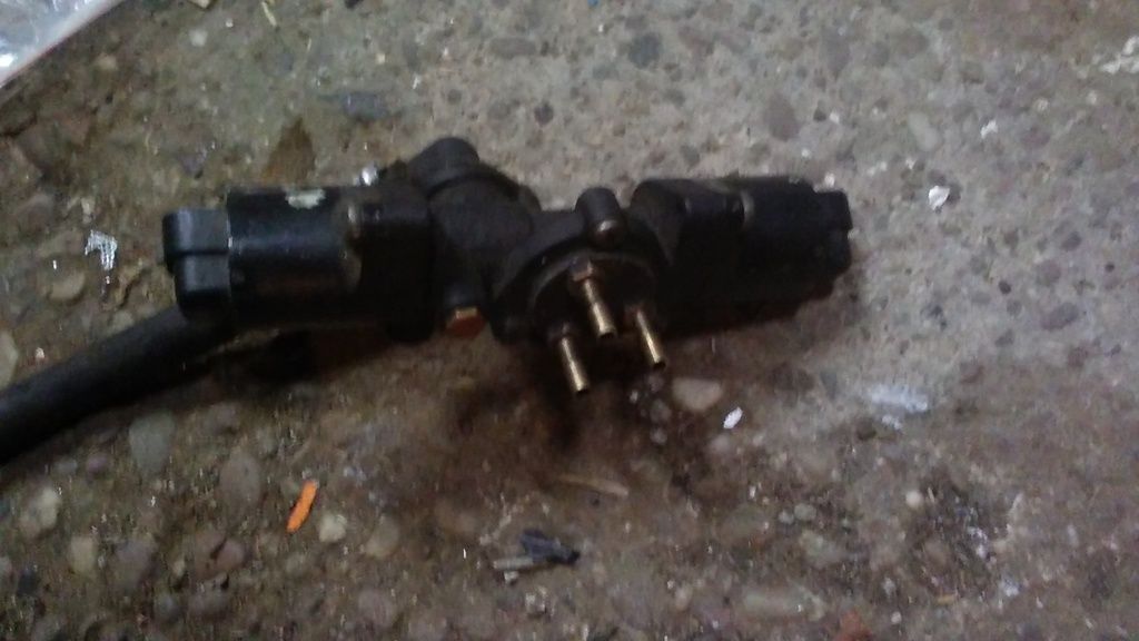

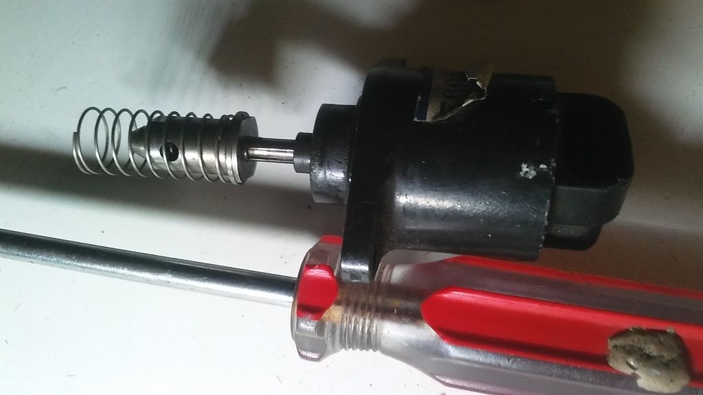

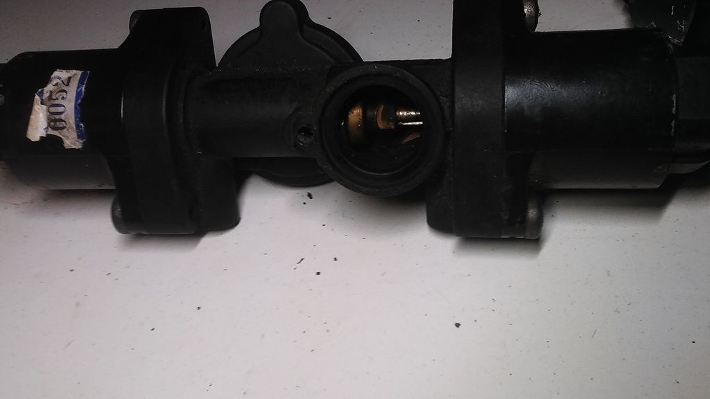

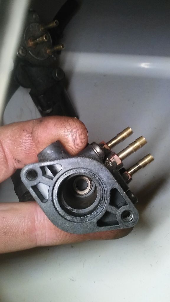

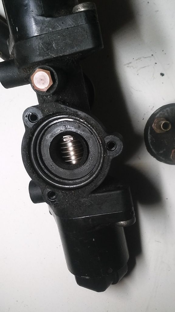

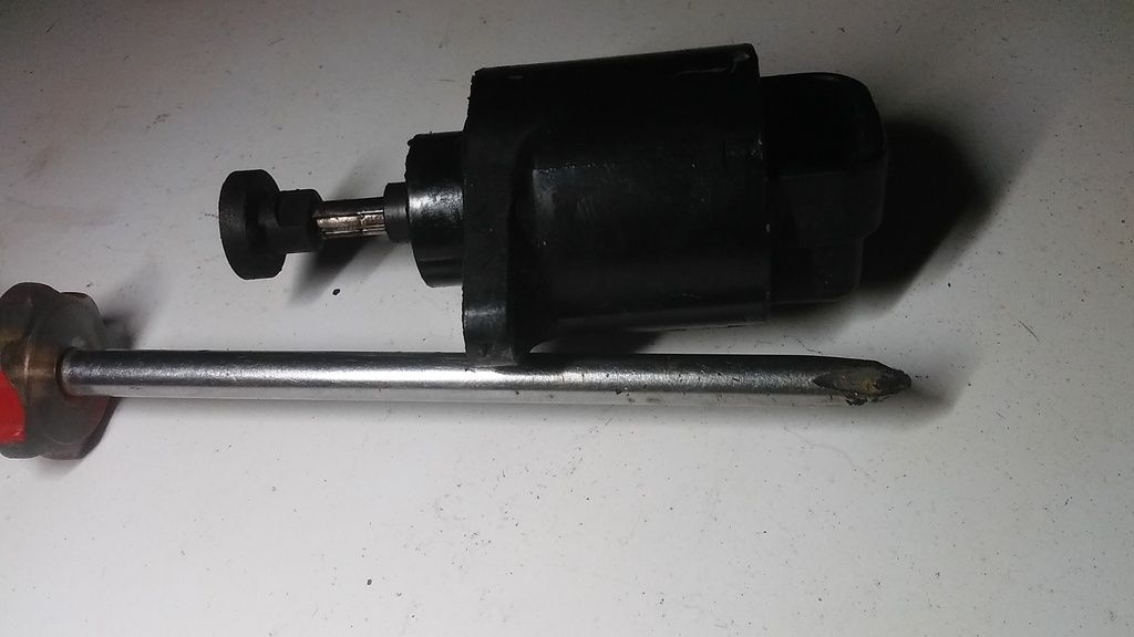

I've been talking about Etagas in PMs with another forum user and have taken some pics for him of an Etagas distributor unit I removed from a vehicle some time ago. Better to post pics on forum than in PMs so others can see them too. I've numerated the pics for easy reference.
Pic 1 Distributor unit
Pic 2 what I'm calling side A port stepper removed
Pic 3 side A stepper
Pic 4 what I'm calling side B port stepper removed
Pic 5 side B stepper
Pic 6 gas inlet port inlet removed
Pic 7 gas outlet port nozzle plate removed
So it looks like side A has most effect on incoming flow and side B most effect on outgoing flow (which in turn of course will depend on incoming flow, in fact they'll both depend on each other..) .

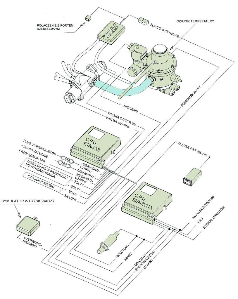

This might help
Etagas wiring diagrams PL
Połączenie z portem szeregowym - diagnostic interface
Kontroler ciśnienia - Map Sensor
Czujnik temperatury - Temperatur Sensor
Pomarańczowy - Orange
Niebieski - Blue
Czerwony - Red
Czarny - Black
Ż?łty - Yellow
Biały - White
Zielony - Green
Czujnik poziomu - Level sensor
Fioletowy - violet
Szary - Gray
Brązowy - Brown
Masa - Ground
Sygnał obrot?w - RPM
Emulator wtryskiwaczy - Elektroinjector simulator
It does suggest the white and green wires goto the level sender looking at the below diagram
PostPosted: Wed Dec 14, 2016 10:14 pm
Joined: Wed Apr 09, 2008 9:00 am
Posts: 7973
I've got that diagram already but all it shows is that the white and green wires go to the gauge. What I don't know is, if one wire is earthed, which of the two dangling wires needs to be connected to the other one? I know that on AEB stuff the way they are connected is different for different gauges so would assume that the Etagas is the same. AEB shows the black wire at the gauge grounded and both the white and green wires connecting to the green one. I'll suggest he tries that and see what it shows then. At least with the gauge on the tank he will know what to expect it to read.
