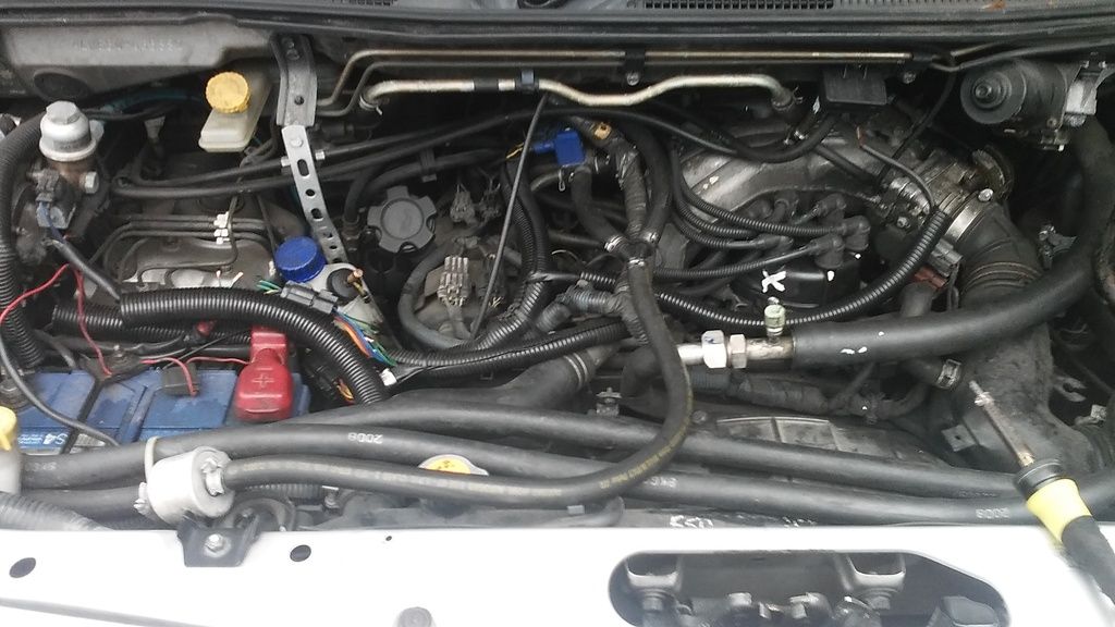

Sorted an Elgrand out the other day (pic below). The owner said it ran OK on gas but there was a constant misfire on petrol. He'd had it to a normal garage (not an LPG installer) who had identified the misfire was on cylinder 6 but other than that they couldn't ascertain what was causing the misfire, so after they'd fitted new plugs and done a bit of poking around with the wiring the owner decided to bring it to me. Before I even opened the bonnet I told the owner 'Most likely there'll be a problem with a green wire inside a sheath that has a red band around it. Worst case scenario is this wire is broken/disconnected underneath the inlet manifold where it connects to number 6 petrol injector, best case scenario there's a break in this wire in an accessible place, other than that it could be an internal ECU fault because when you're running on petrol the ECU is supposed to internally connect this wire to a green wire with a black stripe'. On opening the bonnet could clearly see where the garage had been probing the green wire I referred to, so top marks to the garage for getting that far (although TinleyTech might have advised them about the green wire as it was them who pointed him to me). The owner said 'I can see you know what you're doing, we'll just head into Pontefract for a bit then while you sort it'. They'd only been gone a few minutes when I ascertained the break in the wire wasn't under the manifold, because physically connecting the green to the green with black stripe cured the misfire, so it wasn't going to be a manifold off job. Further checks also pointed to the fault being ECU internal so I put the wiring back to normal and fitted a new ECU and now again the engine ran on properly on all cylinders on petrol confirming the original ECU was at fault. Set about calibrating the new ECU, it immediately ran well on LPG but I noted a couple of abnormalities - an intermittent bank trim issue was evident when running on either fuel and it wasn't easy to calibrate using the compare pinj method because while running on petrol the pinj figures quite often reverted to showing only 0.3ms duration (intermittent incorrect pinj readings on screen but only when running on petrol). ECU voltage etc read correct so I put the intermittent pinj readings down to either the installer connecting ignition live to a less than entirely appropriate ignition live or an aspect of fitting this type of ECU on a 6 cylinder motor, but anyway this wouldn't prevent the system working properly it would just make calibration a bit more difficult for me. I ascertained that the intermittent bank trim issue was due to a driver side cylinder bank failing precat lambda probe and managed to calibrate the system properly regardless, so the vehicle runs on LPG at least as well as it did with the old ECU and calibration is correct, the vehicle also now runs properly on petrol too and another positive outcome is that the owner is now aware about the lambda probe issue. 'Will that be why the MOT station reckoned emissions were high then?' he asked. 'Yes the dodgy lambda probe could easily cause that'. All very simple stuff. Don't reckon much to how and where the installer fitted components such as the reducer (too high really) and lube bottle (bit dangly on that long thin mecanno type stuff).
