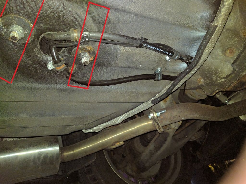

If that's not acceptable, does anyone have any examples of how I might do this from underneath? Would it be a case of fabricating some flat spreaders and using them place of the washers that came with the tank - so that the spread the load betwee the bonded and permanent sections of the wheel well - something like this (red lines indicate the spreaders - one slightly out of shot):
Come to think of it - my preference would be to use something like the spreaders, as the straps option is likely to be a pain, in terms of access for the bolts at the rear of the wheel well (likely obscured by diff & driveshafts.

My solution will be as follows:
20x4mm (or 6mm dependent on locating longer bolts for the tank) flat steel bar spreaders, each with one hole - for the existing tank bolts, aligned to cross the wheel well from left to right if viewed from behind the car, so that the bars sit on each ridge that's part of the permanent wheel well section.
As follows (using in-process picture to illustrate):
What do we think?
PostPosted: Sun Oct 09, 2016 12:07 pm
Posts: 3219
That will do it, the tank isn't going to go anywhere.
Maybe help with visualising 'window frame' - On your last pic, imagine your bars in same position and then add 2 bars at 90degrees to them, connecting your bars across the top and the bottom of your pic.
The supposedly weak middle turret sticks down a bit from the level of the rest of the boot floor, if the 2 bars we just added were outside the area of that turret and were sandwiched between your original 2 bars and the boot floor they might (they would if they were thick enough) clamp onto the stronger area of the boot floor.
