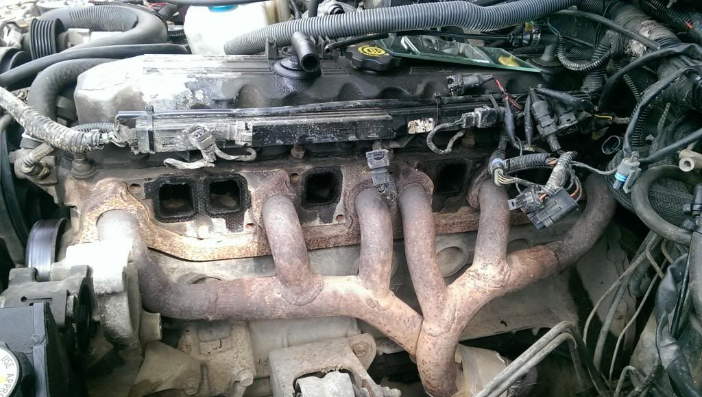

Anyway for some strange reason, the jeep seems to have gotten its mojo back ... its almost like the other zorst manifold was blocked, but it isnt, anyway heres a couple pics ...
The old
The new
note the expansion joints in 1 and 6, this mod should prevent the standard cracking procedure around the 2 into 1 joint.
