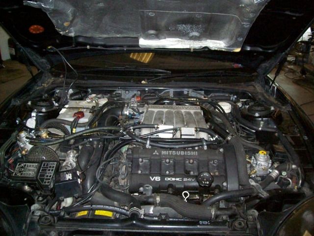

picture of a 3000GTO twing turbo i did a while back. this was tight

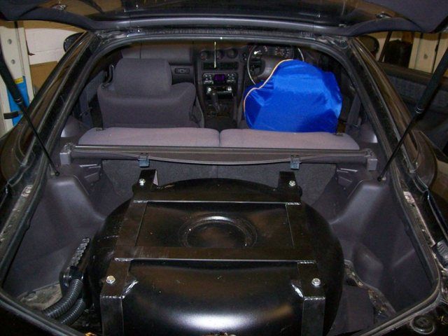

this was the tank on it
 Post subject: Re: Toyota Supra
PostPosted: Tue Mar 20, 2012 8:00 pm
Site Admin
User avatar
Joined: Fri Oct 14, 2005 6:12 pm
Posts: 1573
Location: Cardenden, Fife
jesus that tank looks massive! how big is it?
PostPosted: Tue Mar 20, 2012 8:03 pm
Joined: Wed Jan 28, 2009 9:31 pm
Posts: 851
Location: South Wales
think it was around 80litres, it was a while ago, and I have slept since then :lol:
