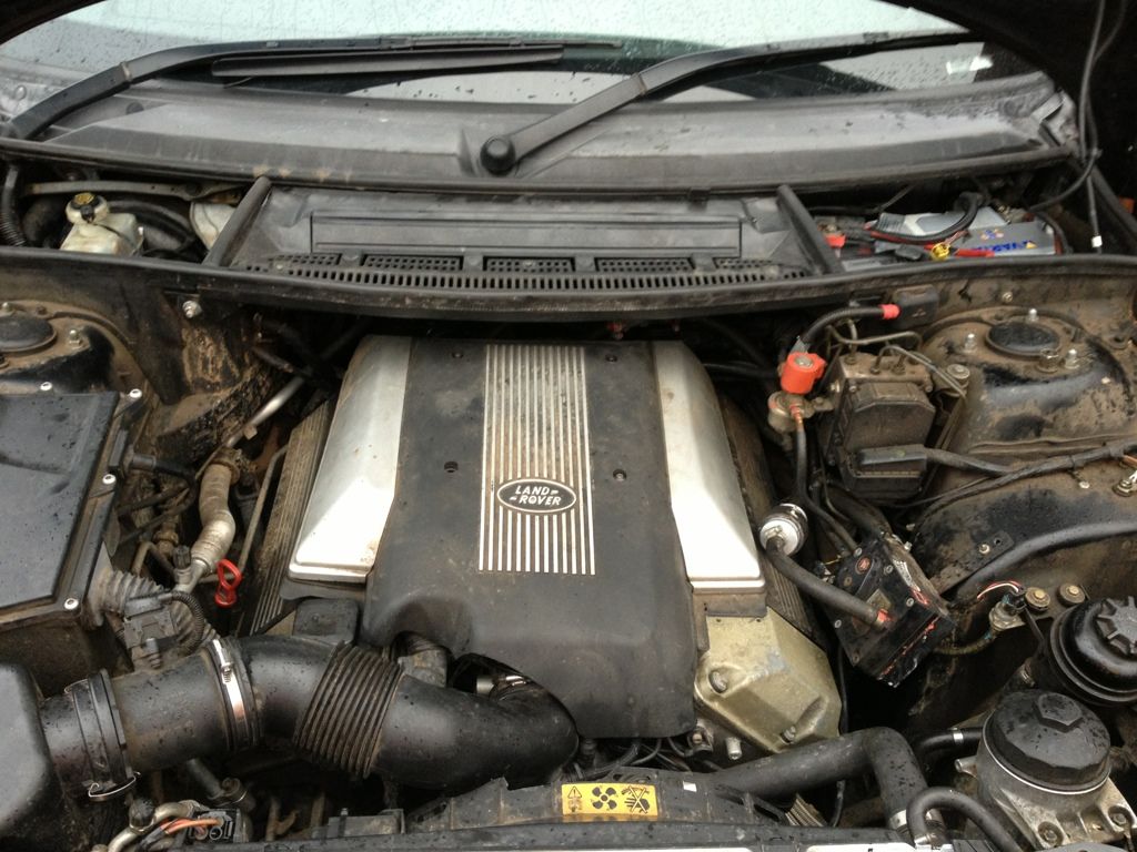

Thanks Gilbert. Is there a way of readily identifying the BMW engine as I have my eye on a 56 Plate HSE which could be just a "last of the line" 4.4 BMW or an incorrectly identified 4.2 "utterly butterly" version. Since it's a fair trek to view it I'd rather be sure it's the right model :-)

A BMW engine in an L322
A Jaguar/Ford AJV8 engine in an L322

I think even I can see the difference there. Thanks! :D

Not sure what happened but I'm sure Gilbert's post didn't show before I posted, the pics didn't leave much need to post..
