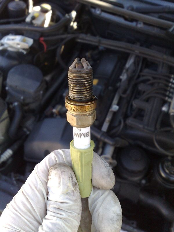

I checked my service records and the plugs were last changed at 76k, around the same time as the LPG install. So they could do with replacing, assuming Bosch 4+ platinum's have a service life of 60k. But I'll go for single electrode perhaps this time.

I still wouldn't rule out waxing at the root of some of your problems, and this would be amplified if the system fails to get stinking hot - many short journies or engine thermostat failure, or poor water flow to the regulator.

I replaced the petrol fuel filter and spark plugs after which the the car ran fine on Petrol. The spark plugs looked like they were past their best, i understand they probably wont last their usual 60k mile lifespan on an LPG car, but instead last about 45-50k. I should also say, the fuel filter return hose that returns fuel vapour had a small 5mm hole in it, which i fixed. It code have cause unmetered air entering the system, triggering lean codes.
