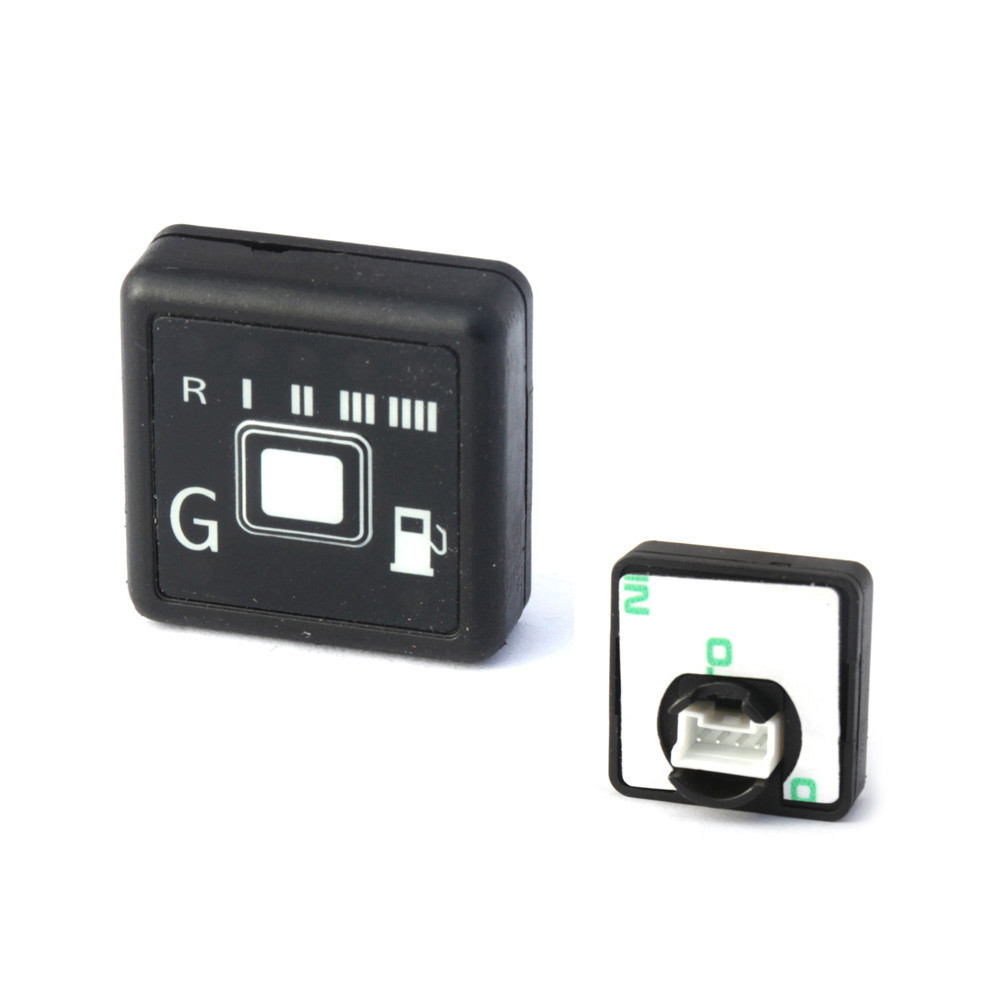

But I have one other small problem. When the car runs on lpg. The orange light keeps blinking. Normaly the a green light will show when it is running on lpg. Also the diagnostics show a fault on the switch sometimes. So i would like to fit a new change over switch.
I have the old type switch fitted with a square 4pin connector:
But it is not available anymore.
Can i fit the newer switch with the 4pins in a row?:
PostPosted: Sun Feb 05, 2017 3:21 pm
Joined: Fri Oct 21, 2005 7:56 pm
Posts: 2583
You can but will need the plug and some wire to go with it.
PostPosted: Sun Feb 05, 2017 7:17 pm
Posts: 3052
Agreed with Dai.
Also, if the brown wire is disconnected from the switch I've known the orange light to continue to flash.
