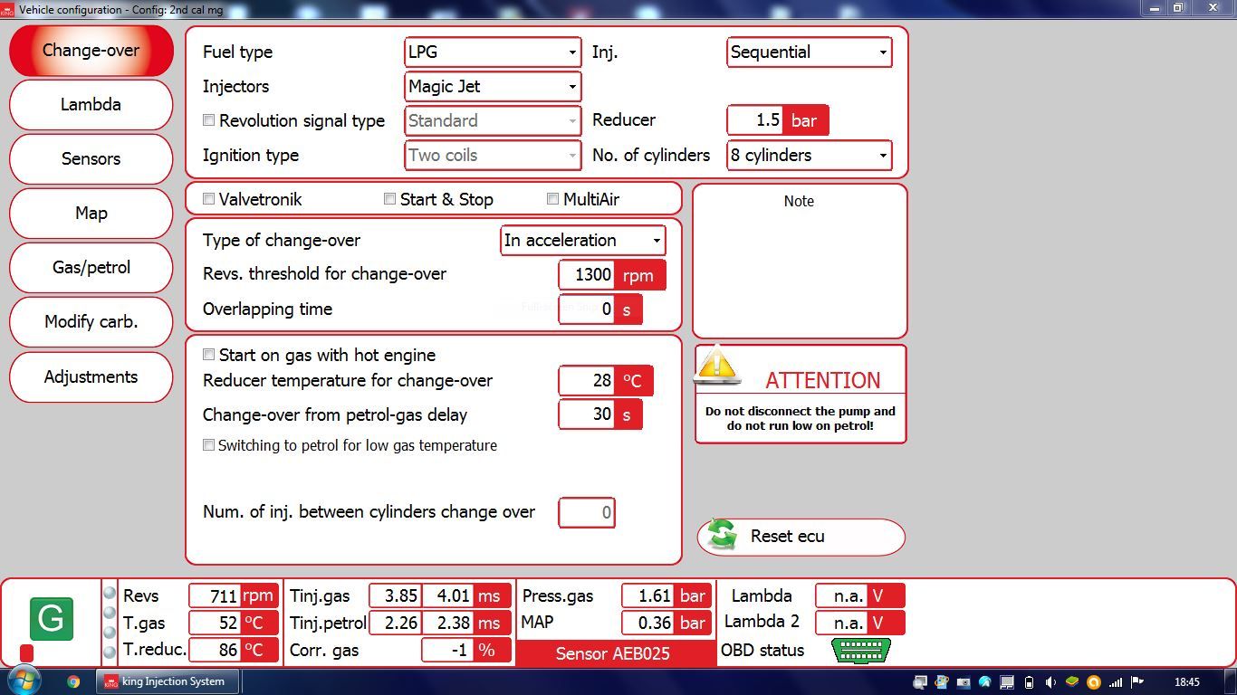

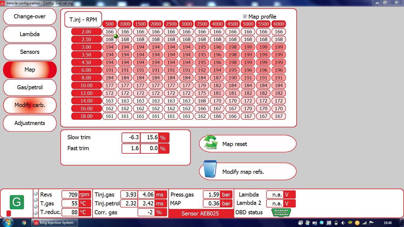

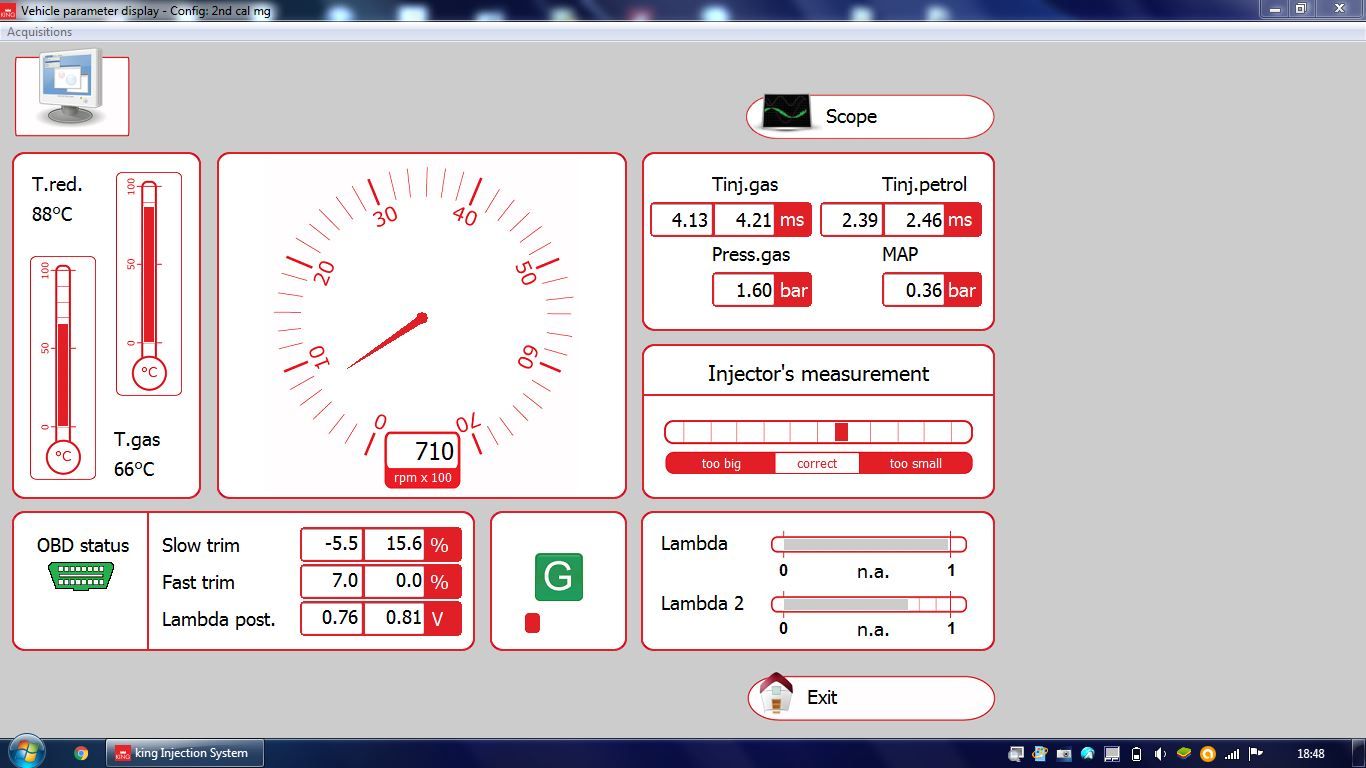

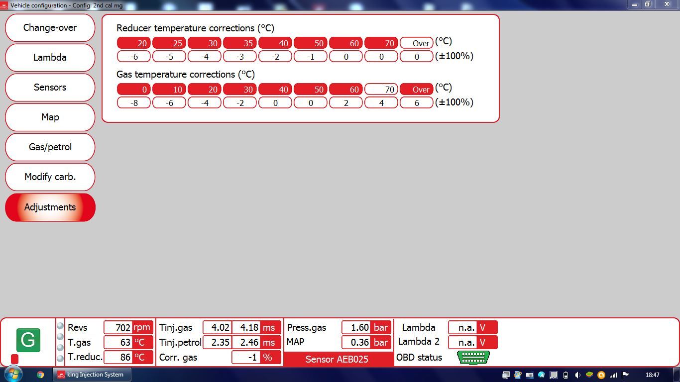

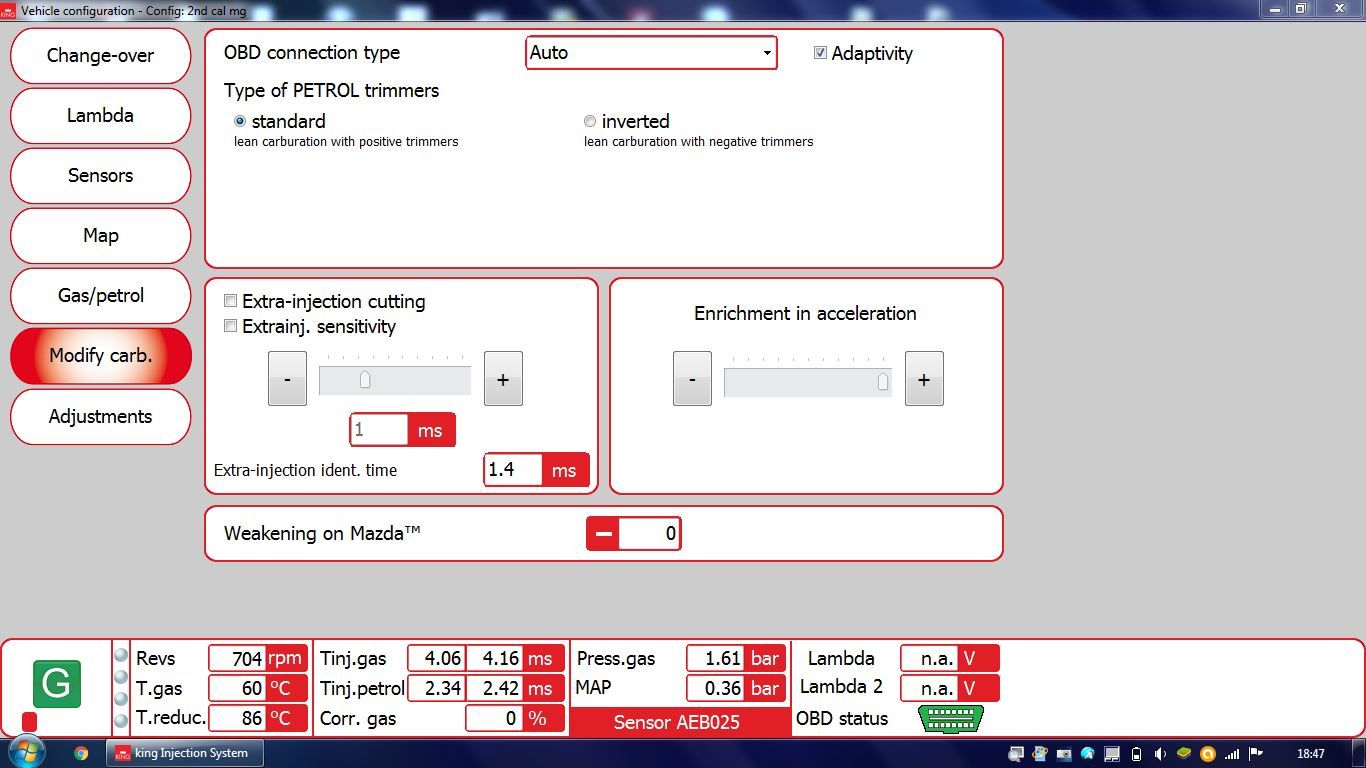

well the other 7 injectors arrived at lunchtime , all fitted and mapped , must say the car is performing MUCH better that it ever did on the last injectors that were fitted . had to cut one of the injector outlet pipes down due to a leak at the end of the hose , its about 40mm shorter than the others and the tip of the injector is just clamped by the clip - doesn't seem to be having any detrimental affect yet , but what diameter should I order for outlet size of the magic jet injectors , its either 5 or 6mm - whats best to get?
I've included some screen shots of the current set up for comment/criticism , it appears to be working ok so far but time will tell.

You definitely haven't finished calibrating yet, just looked at a map of mine for an RRSC with MJs at 1.3 bar (so prob 3mm nozzles), a bit of a range of numbers in mine but the numbers change gradually, peaking at 3ms. To calibrate you should disable adaptivity and (not quite the same point) it's best to disconnect the OBD connection and use an OBD live data scanner to calibrate using fuel trims. Possible to use the LPG ECU's trim reading feature but a separate scanner is better because the LPG's trim sample rate is much slower.. but while LPG ECU is connected to OBD it may slow the sample rate of the scanner, or only one of them may connect.
Get rid of the petrol addition setting (in fact should never be set like that with 20ms activation and 20ms addition). At least during calibration, turn off sequential changeover, set rpm changeover to 400, set changeover delay to 0.. So you control when it switches fuels and does so immediately.. easier to do comparisons (trims / lambda / seat of the pants, etc).
