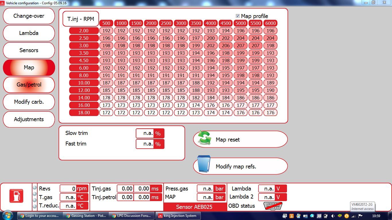

Author:  hitman [ Mon Sep 05, 2016 10:02 am ]
Post subject:  Re: which injectors to go for
a quick update :-
car running ok most of the time with no lean/rich codes so far after changing out an injector pipe on cylinder one which had a bit of a hole in it and was giving a misfire on this cylinder
anyway - I still have the misfire between about 2500 and 3000 rpm only under certain conditions - it occurs when the engine feels it should be dropping down a gear but remains in the wrong gear as it were and then the misfire happens (hard to explain tbh)
anyway I suspect it may well be nothing to do with the calibration of the lpg map but do not have time to investigate further for a couple of weeks (it only happens on lpg , and not when on petrol) could either be the injector or maybe coil pack or plug .
I'll sort it out once back from work
current map below
Author:  LPGC [ Mon Sep 05, 2016 11:50 am ]
Try enabling 'anticipate the injection sequence' (engine has to be idling on petrol to make this change'. When the change has been done the changeover between petrol and gas might not be as smooth but it could improve drive-ability... Unlikely to have a positive effect in your case (and maybe particularly on a V6) but this often improved matters on old 4L Jeeps fitted with older LPG ECUs with similar symptoms.
