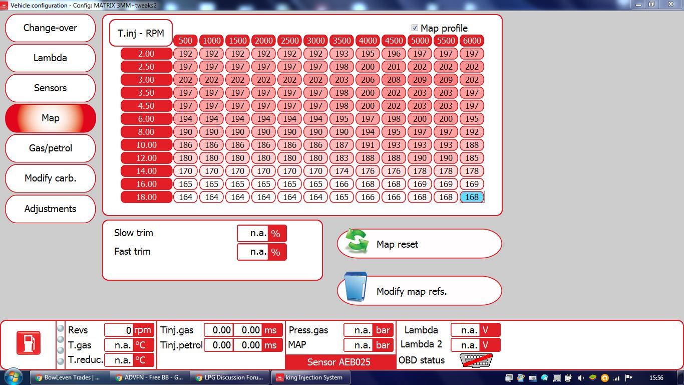

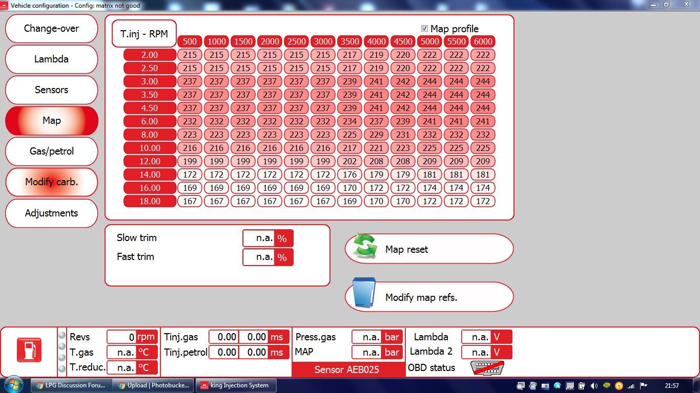

I tried the matrix selection and it gave me an awful calibration map and said injectors too small
I noticed there are matrix , matrix hd, matrix xs15 and matrix xs20 , which should I be selecting for calibration?
heres a screenshot of the map with matrix selected , if this is the correct selection I used looks as if I will need to drill out to 3mm?
thanks again

After changing injector type in software the pressure setting in software might be reset, in which case you'd need to change it back to 1.6 bar before attempting any mapping.
Yes use Matrix setting. It does look as though 3mm nozzles would be more suitable but since you have 2.5 nozzles fitted and reducer set to 1.6 bar already you might as well see what figures you'd need in the high load area of the map... I expect too high but worth checking.
You have been adjusting map according to fuel trims, not just by comparing pinj or seat of the pants when switching between petrol/gas?
Wouldn't be much use me just advising to drill nozzles to 3mm, set reducer to 1.3bar and sending you a config file because setup will partly depend on aspects of your fuel return (if your petrol pressure reads different to the pressure on the vehicle I calibrated any map I sent you wouldn't be suitable).

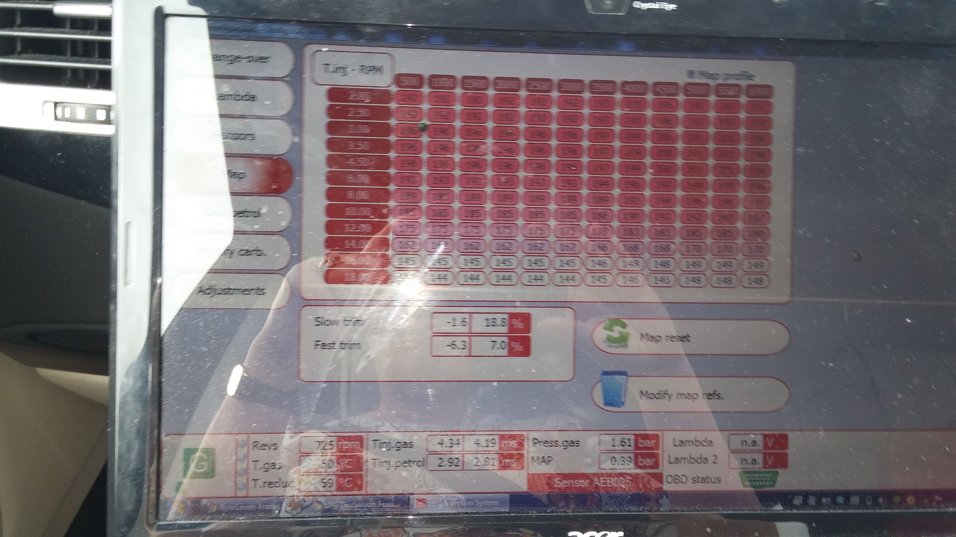

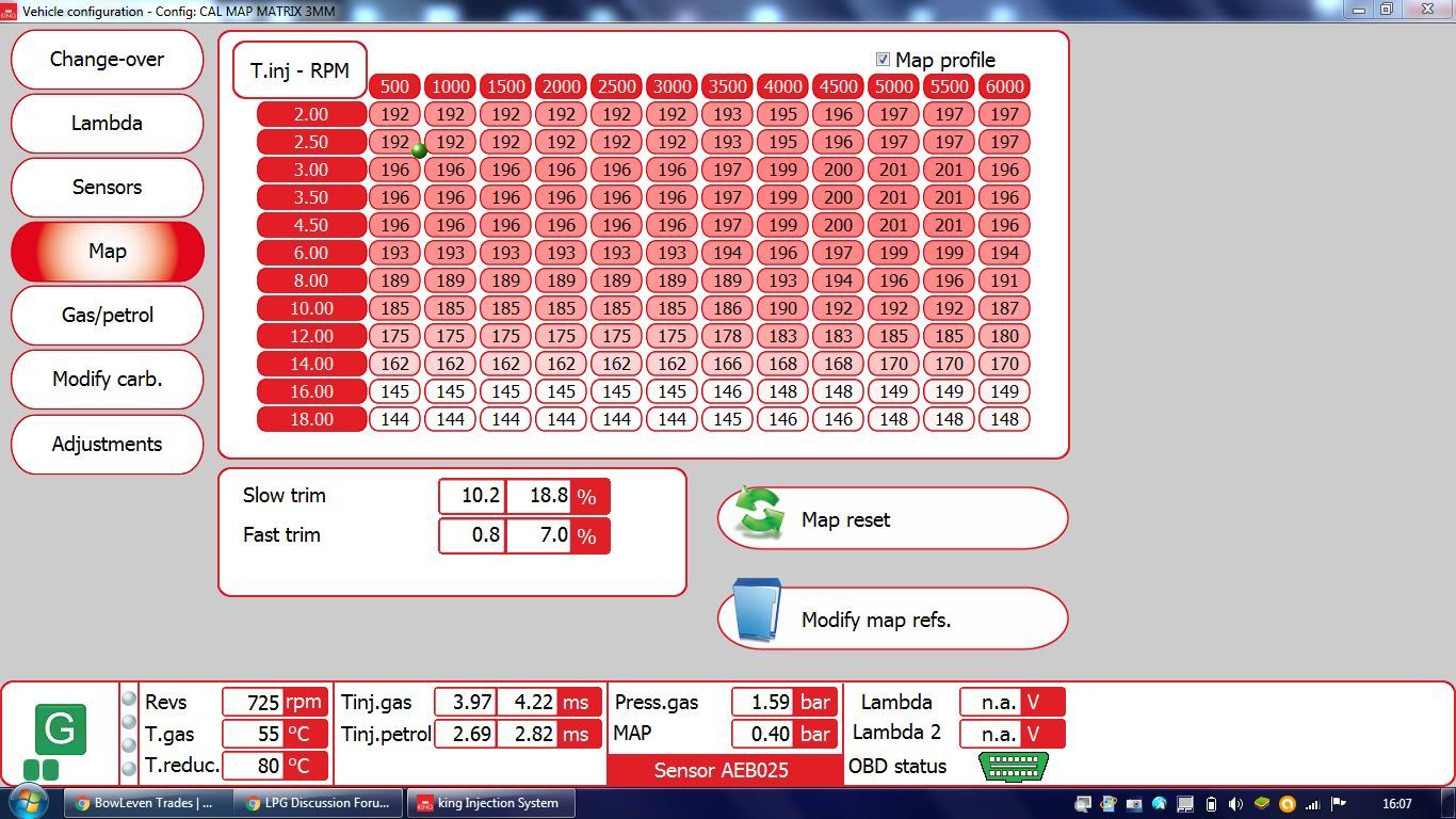

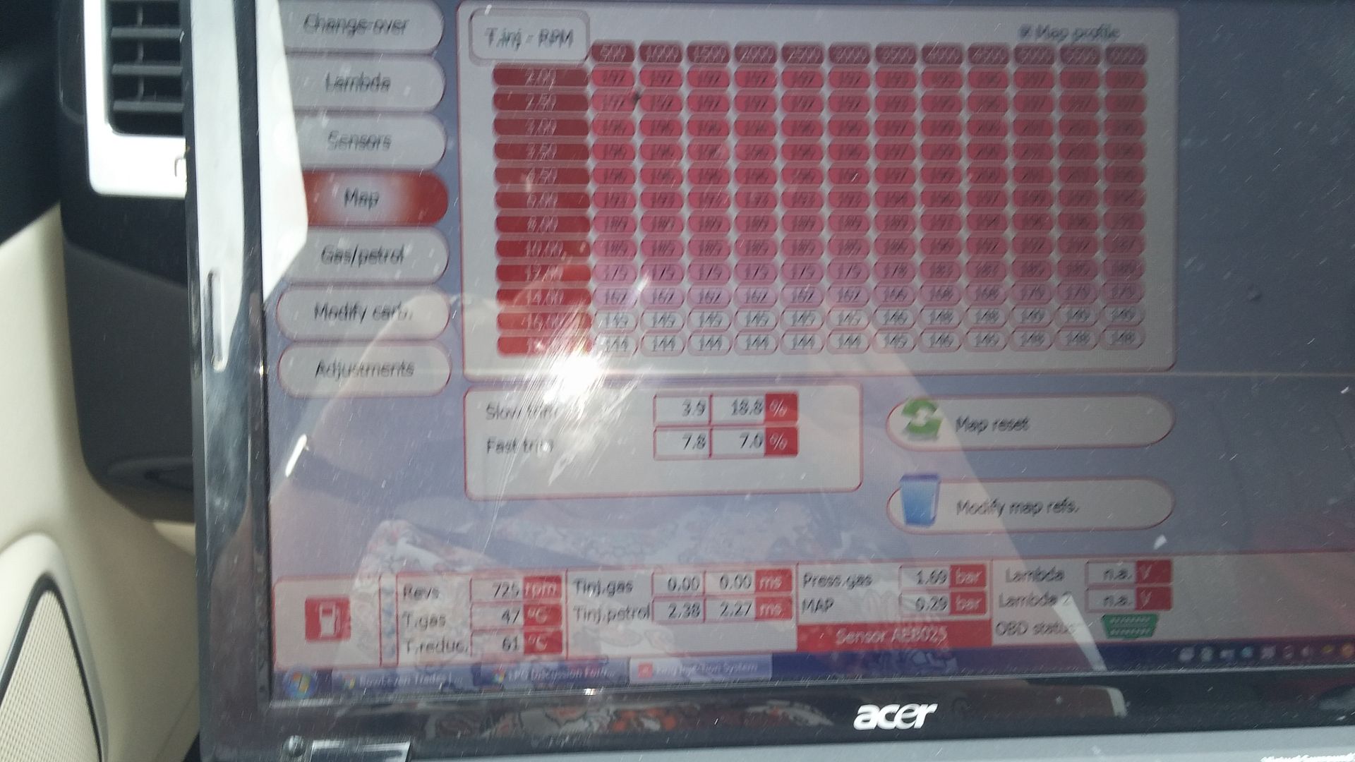

idle on gas Image
idle on petrol Image
petrol under load (if its readable) Image
gas under load (if readable)
ETA Photos when running are not showing true RPM reading for some reason - actually rpm was 2250 , wife assures me screen was not frozen - me I'm not so certain
PostPosted: Wed Aug 31, 2016 4:54 pm
Posts: 3043
I expect your wife was right, funny things happen on certain engines with certain LPG ECUs.. Chances are if you turned off the engine and restarted it it would read correct RPM again... for a while! Other than that to correct this issue you might try experimenting with: Temporarily ticking the box that denotes rpm wire connected (beside 'revolution type signal'), this allows changing the previously greyed out 'revolution signal type' setting from standard to weak, and greyed out setting 'ignition type' from 2 coils to 1 coil or rpm sensor. Then unticking the tick box again (because at the moment you don't have the brown rpm wire connected - do you??)... That shouldn't work (as the only thing changed are greyed out settings) but I and other installers have found it can work. If that doesn't work, try ticking the 'rpm wire connected' box and actually connecting the rpm (brown) wire to an ignition coil.. You could also try using a different version of software, a different laptop, a different cable, uploading different firmware to the LPG ECU but I'd expect none of these to work. At least this is happening on an 8 cylinder install, not on a 6 cylinder install where often when this type of issue is seen other more problematic issues are also seen. The issue won't be making any difference to what you're doing yet (and won't cause any problems yet) but can still lead to drive-ability problems later. When I've seen this rpm issue in the past I've wondered if it was just a case of the data stream from the LPG ECU to laptop not updating the laptop's rpm reading (the LPG ECU itself continuing to react to actual rpm rather than frozen rpm).. but I confirmed this wasn't the case - When the rpm reading stops reading correctly the LPG ECU acts according to the same rpm reading (that would be shown on screen with laptop connected) regardless of whether the laptop is connected or not and also the issue can arise at any time. More on this if it comes to it.
Screen-shots could show your engine is running open loop on bank 2 (bank 2 trims show the same in all screenshots, while bank 1 trims do change). With this condition would expect your engine warning light to be on. Check for trouble codes, note any that are present, clear trouble codes and do screen shots again. If the MIL light never comes on despite you trying (could disconnect an injector pipe thus causing a misfire for this) to bring it on, could mean someone has somehow disabled the MIL light.

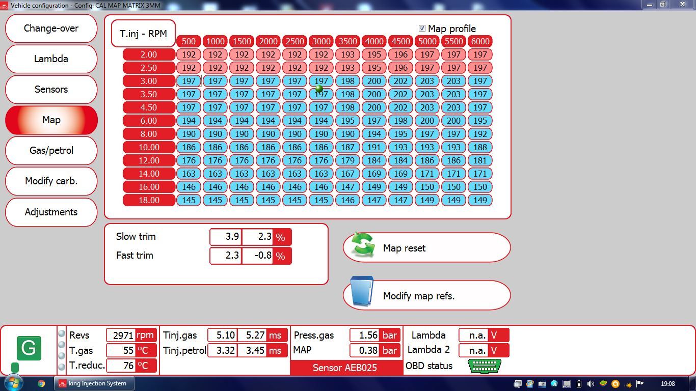

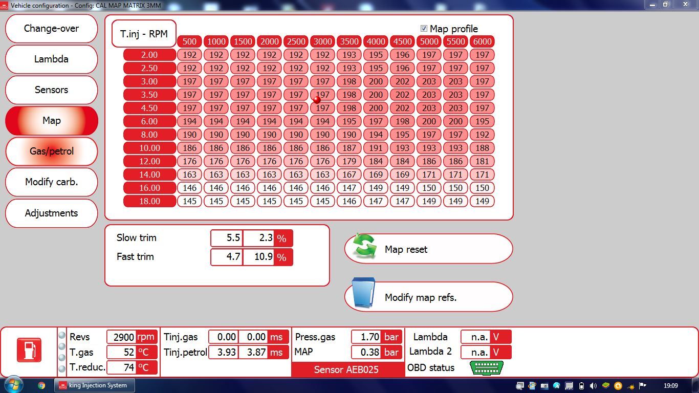

trims confirmed flip/flopping okay but general positive on bank 2 , suspect air ingress , was okay before I strted messing so suspect cracks in pipes causation , will sort once new pipe arrives , have added a tad to the map
screen shots under load show trims changing now with correct rpm
on gasImage
on petrol Image
PostPosted: Wed Aug 31, 2016 8:00 pm
Posts: 3043
Looks like you hardly changed the map - so would expect the difference in trims to be due to one or combination of trims settling down (maybe due to warmer engine) / rpm reading correctly / reducer temp correction settings (unlikely) / you maybe sealing a leak / something going on with MAF sensor. Probably the rpm reading correctly.. again this shouldn't make a difference but does.
Also your trims are now more positive on bank 1, the opposite of before. Are you reading trims from the ELM interface of LPG system when you refer to bank1/2? The LPG system banks may be the opposite of petrol system banks depending on how the LPG system was wired in (not good practice but only downside is less intuitive diagnostics).
Would expect your combination of 3mm nozzles and 1.6 bar to need lower numbers in the map tbh. Have you checked trims at higher load areas of the map?
