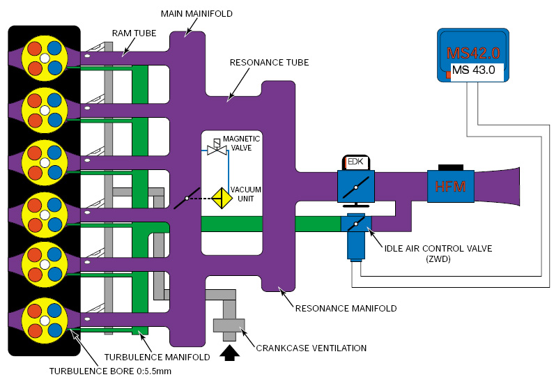

I'll put a boat load of money that the separate idle air supply has been ignited in consideration to nozzle placement.

I'm trying to find the diagram of the idle air supply circuit.
It's a long read but see this thread:
viewtopic.php?f=28&t=10450
PostPosted: Thu May 07, 2015 7:25 pm
Joined: Sat Jun 06, 2009 11:37 am
Posts: 172
Location: Taunton, Somerset
The green inlet flow is accurate and reflects how close the port opens to the inlet valves.

So in your diagram, where should the injectors be placed?

The diagram is a schematic, it wouldn't be great for pointing out where injector nozzles should be placed.

Sorry, my question was unclear, I understand that the diagram is a schematic... what I want to know is with that schematic in mind where should the injectors be placed?
I plan to whip the cover off at the weekend and have a look so it would be good to know what a position for the injector is on this engine.

Injectors should be placed where the gas outlet position will facilitate gas mixing with the airflow and getting into the cylinder under all conditions. The diagram doesn't show such a position but such a position is possible low down near the port end of the manifold.

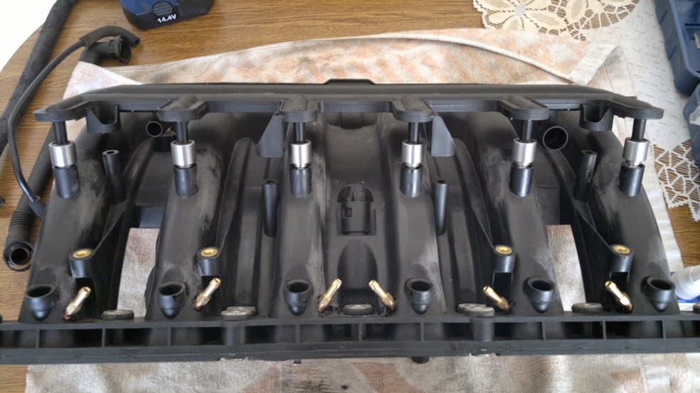

This is not actual mine photo , but that's how I got mine done similar , same engine(m54b30), with no problems.
Get error codes , then you can see what cylinder misfires and go from there.

Similar to how I fit spuds on this engine. They look to be the long threaded type spuds - long thread spuds are probably good for getting gas into idle airflow but might reduce flow ability of the manifold runner a bit (thereby decreasing peak power a little), I've had no problem with short threaded spuds fitted in this location.
Let us know how your spuds are fitted Welshman?

I couldn't get a decent picture of the spuds as there was too much stuff in the way, however I could see them well enough to confirm that they are positioned in the same way that the ones in hardcorepit80's photo are positioned.

This low load transition is fundamental as the ICV supplies air for up to 15% of engine load not just at idle, therefore there's still a significant pocket of 'stationary' gas waiting to be gulped down upon initial throttle increase. As can be seen in this picture this hole continues directly to the valve therefore it's not viable to get the LPG nozzles directly into the low load airstream.

@hardcorepit80 – your lpg nozzles are placed much closer to the head than mine were.
