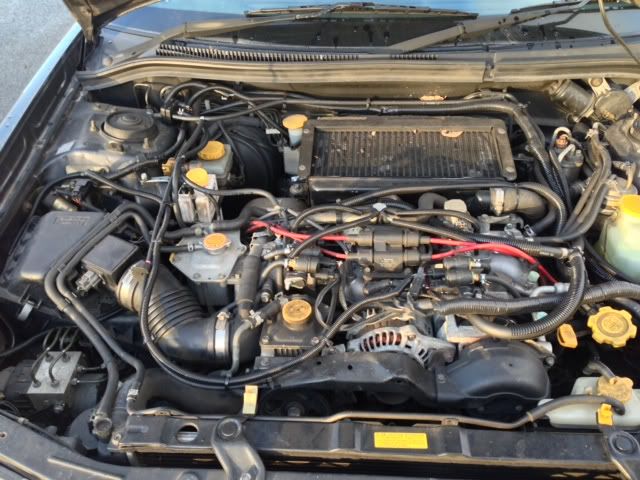

I use emer with 2x 2 cylinder rails, its all nice and neat that way.

Yep needs to be 2 rails of 2 or otherwise seperate injectors. I mount my injecors at the side of the manifolds to keep them verical :wink:

Just hoik the change over temp up when you have to.... Seems to do the trick. They get bloody warm under the bonnet those scoobydoos :D
